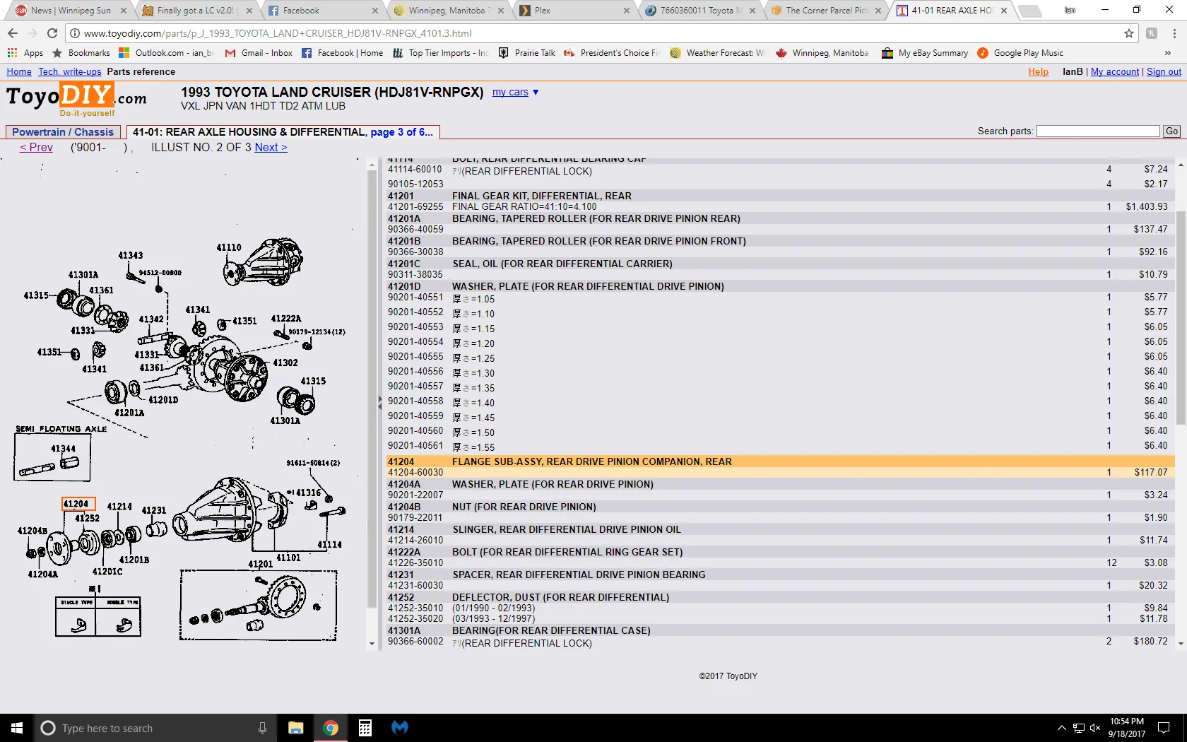

@Crab Sack It was 41204-60030 (FLANGE SUB-ASSY, REAR DRIVE PINION COMPANION, REAR) that you were suggesting could be worn and require replacement?
Would you need to set up the rear diff gears preload again after replacing this part and the seal? When we did the seal the 1st time, we set the new stake nut to the same as the old one had been, may have tightened up some play in the diff as it felt better afterwards, less slack in the driveline.
That is the flange I was talking about. It is possible to carefully re-torque and then re stake the nut in the same spot or just a hair tighter than the stake nut. You can always pull it apart first to see if you need the flange. Make sure you install the seal with a tool that goes around the entire seal so it doesn't cave inwards when you tap it in.

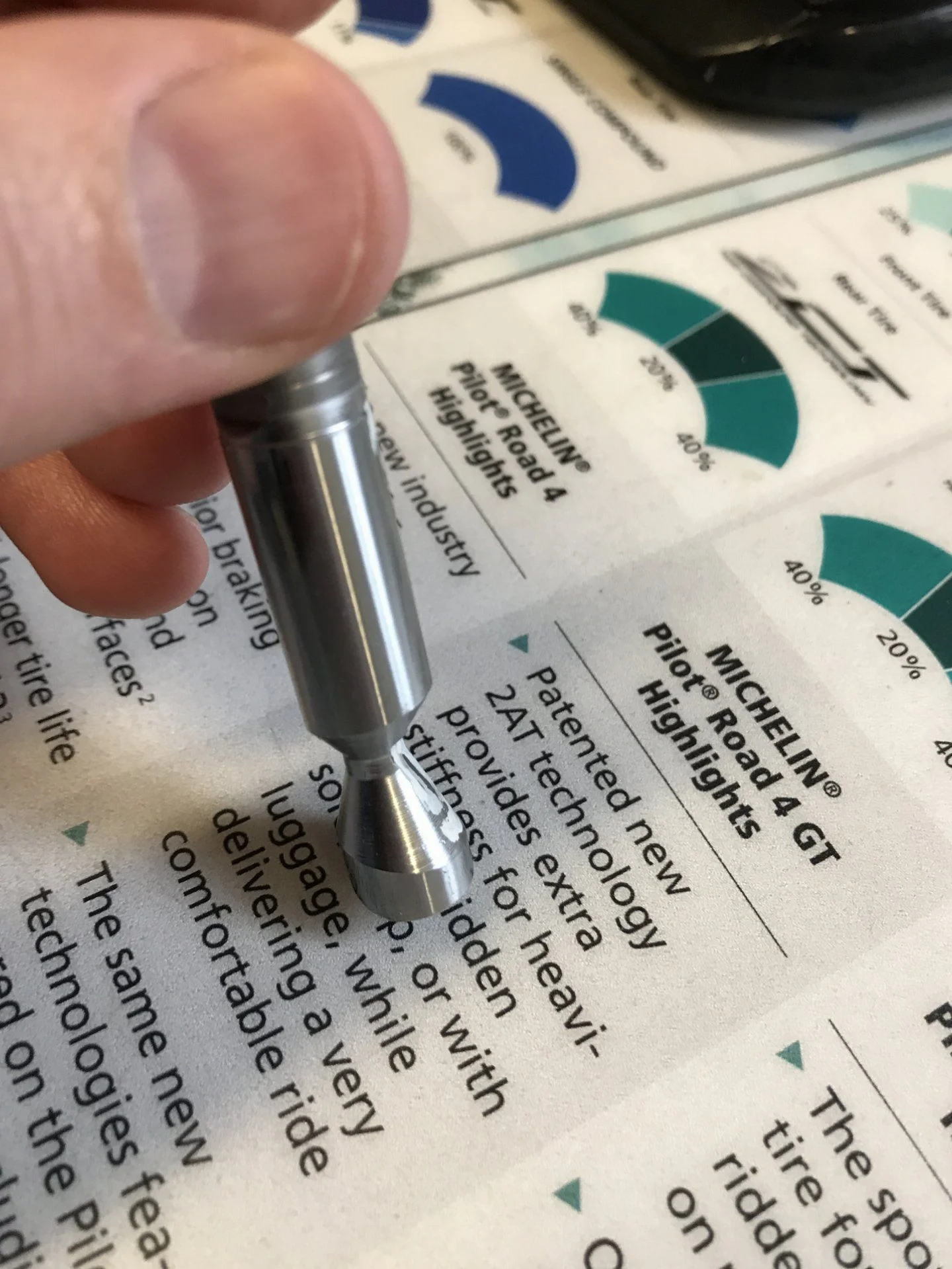

I pulled the aneroid pin out of the truck again today, it had been a week or so with the starwheel cranked up about a turn and a half, the power surge that came on with the boost is tamed a bit, but still quite a bit better than before, smoke is cleaned right up during the day, even improved at night. Paint marks show I'm still getting right to the hard stop at the full pin depth, just in a more linear fashion as boost builds rather than all/now. EGT's are slightly slower to rise it seems, but that's just from casual observations. The weather has also turned, and it's 10-15 degrees celsius cooler than my earlier testing, so that could very well be what I'm seeing.
I'm leaving the fuelling here for the time being, and turning the boost down to 18psi until it's swapped out for the Gturbo.

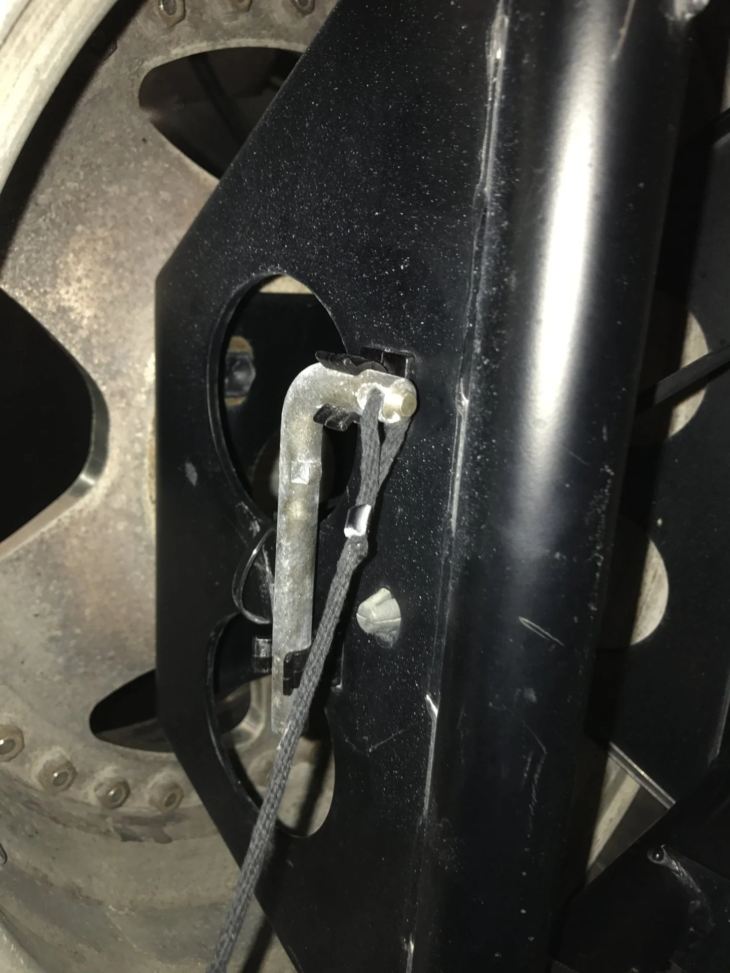

Took me a lot of searching to find the part # for the little plastic clips on the rear spare tire carrier that hold the locking pin in place, they both got brittle with age and broke within a week of each other. For anyone else looking, part # 90469-09003, cheap little bits but they were hard to track down.
Where did you source the spare tire rod clips from? I need a set of those.
