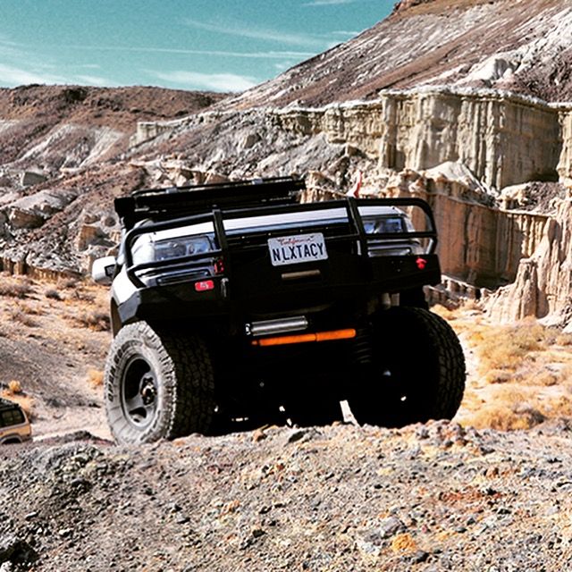

Got the 315s on finally. Went with Toyo Open Country AT2 Extremes. I still think it looks small. Maybe 37s next time around. The tires definitely affect the added power the SC gave. The steering feels the tires for sure. All in all I like it even though I've got some stink bug going on. I've got the front coil sprig spacers that I should probably put on since the front will eventually get a winch.

I agree, they do look small especially with your new SC!
Btw if you change your mind and want bigger tires I'll be happy to take these small little spare donut looking things off of your hand. :)
dude, it looks great! AT's will look smaller than MT's of the same size. The black rims also make it look smaller
Once you get used to it, you will love it.
I think it looks very proportionally correct.
Man, it looks TALL without sliders
Wow, those look great! I got to get some tires soon, but am undecided on what to get. My rims are black like yours, makes a big difference!

I like the look of those tires, remember that once loaded down the rear will come down a bit, at least that is the case on mine, remember also that you really want to leave a little room for flexing of the suspension, alot of guys go too big and try to fill the wheel well which IMO does not look good and hurts performance on the trail.

Yeah I think I'm going I to go with 35" i don't want to deal with possible re-gearing. I would like to see NTLXTACY's with the front spacers to see how it looks loaded down.

I have not added the MT spacers only because I haven't installed a winch yet so I don't know how far the front end will droop. I will say that my over all height is lower than an OME 2.5" lift with a completely bare truck. My truck is loaded down so that affected my overall height.
