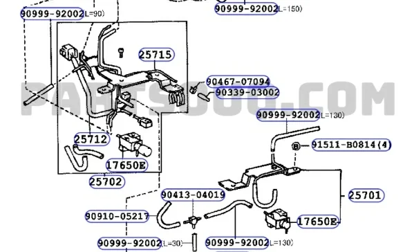

Do you have the part no for the solenoid?
Also something frequently overlooked is replacing the fuel tank cap with a new OEM one. Over time the seals can fail or it can get vent holes clogged. For $20, it's easy.
It's these 2; 17650E, and note there are 2 of them.
A new gas cap is just good PM, but realize that if your gap weren't present at all, the tank would never build up pressure in the first place, leading to the oil can crack...
A quick sidenote: perform the FSM test on yours before replacing them to be sure that one or both is failing. This gives affirmation that you're actually fixing a problem and puts the safety back on for the parts cannon. Verify the above by tracing the small vacuum tubes from the top of the Charcoal Canister to these vent solenoid to be sure I've got them right... It's been about 8-9 years since I reviewed this!
