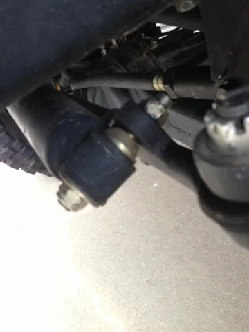

Finally changing out the OEM stabilizer with the OME. Not having ball joint ends sucks. The angle is off and I can see will wear the bushing prematurely.
Also when cycling the stabilizer the cover hits the shield forcing the cover down. This doesn't feel normal.
Let's see the bracket that bolts to the crossmember.
It should point to the back of the truck...is yours backwards?
Alright, so everything worked out. I was just being dumb. I forget my Bud Built bar or else we would have finished that too. Oh well. Tie rods are in, stabilizer is in. Rear bump stops are in. Rear shock mount guards are in. Rear axle side LSPV bracket mod is in. Stops great now.
