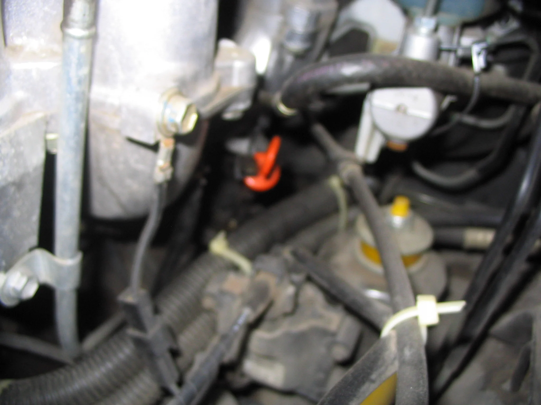

Here's the OEM filter position with hoses attached to an adapter:

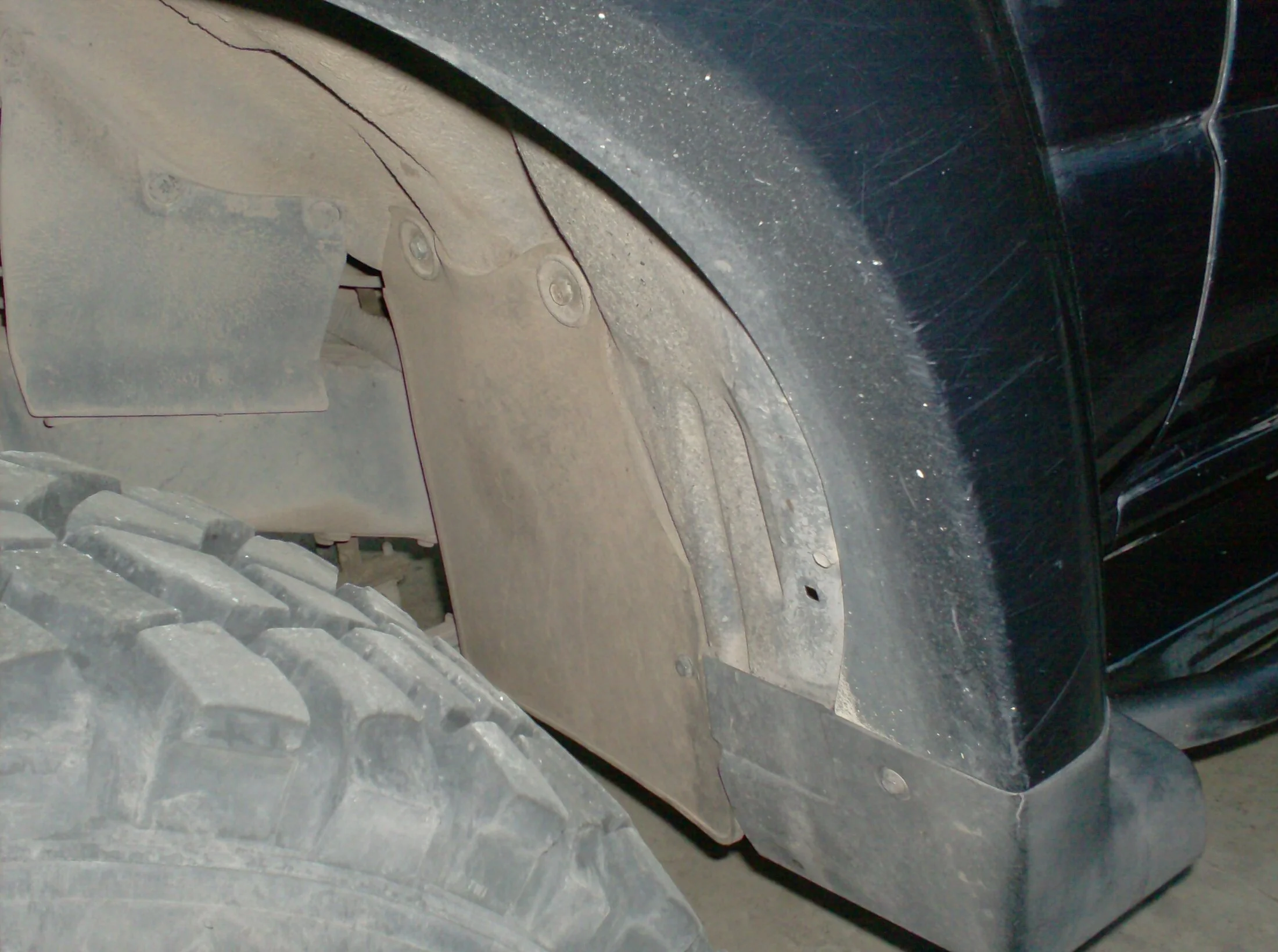

Filters sit behind the driver's side custom mudflap:
Another custom mud flap (easily removable for oil changes) is seen beneath the filters for projectile protection. Bypass filter on left and full flow on right. The connecting hoses can also be seen:

@80t0ylc : How did you mount the filter assembly/bracket to the wheel well area, is it sitting on a metal plate or---, got more photos??
The filter casting is mounted to an 'L' shaped bracket with 4 bolts. This bracket is mounted to the wheel well with 4 more bolts. I pulled up the carpet near the dead pedal to accomplish this. The only other pic is a poor one that shows the hose routing between the engine and filter casting. Hoses run along frame between upper DS shock mount and tranny dipstick. This location was a second attempt at it. 1st attempt the filters were mounted under the driver's seat horizontally and was obviously not the best choice when it came time to change filters.
