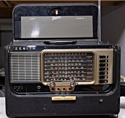

Screenshot 2025-02-20 at 08-49-10 zenith transoceanic radio - Google Search.webp

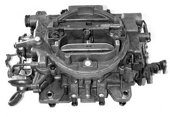

Not gonna lie that Zenith is cool as hell
I have one just like in the photo I pinched. It runs...
I also have an AVS like the picture... That one's broken :doh:
