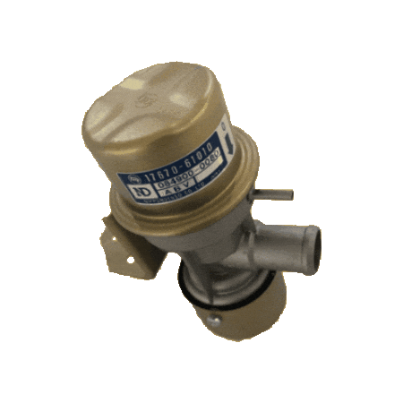

You most likely will have to disassemble the ABV. As the vanes in the pump fail the debris get loaded up in the ABV. Be careful not to mess up the screw heads, use a JIS impact driver to break them free. There are NO rebuild kits or gaskets available for it.

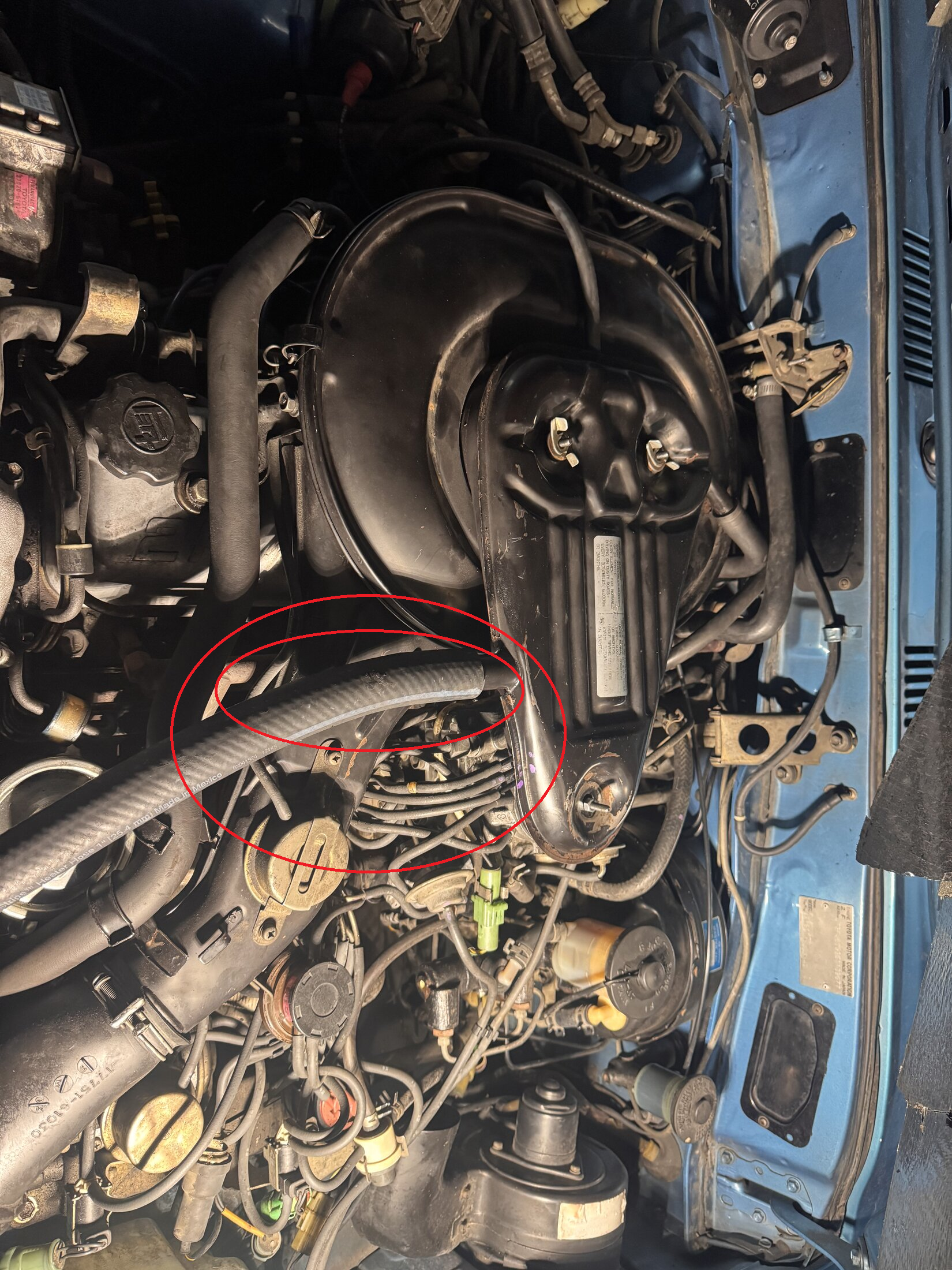

So, upon further inspection, the previous owner removed the smog pump and replaced it with a smog delete pully. I already found a rebuilt pump on eBay and it's on the way. Hopefully that is the reason why there is no oxygen reading on the report. While I was down there, I noticed a vacuum line disconnected and can't find where it goes. It is from the bottom nipple on the high altitude compensator (HAC) valve. I have looked over all the diagrams, but it doesn't clearly show where that line goes to. It appears it goes back towards the carburetor, but can't tell for sure.

The bottom nipple on the HAC valve is a vent to atmosphere. Its hose doesn't connect to anything. It just dangles next to the fender, secured with little plastic tie.
If you've got the HAC valve out, the bottom cap snaps off to gain access to a fiber filter. Might as well clean it. The HAC valve is always sucking in a little bit of air whenever the engine is running.

This hose -- What is the other end going to?
If it's just open, that's allowing unfiltered air to be sucked into the engine.
So, that auto parts store hose was attached to the ACV as a way to rig it up after removing the smog pump. I ordered both OEM hoses to properly attach to the new smog pump. Sadly, the clips for these hoses are no longer made. Wondering if maybe SOR had them.

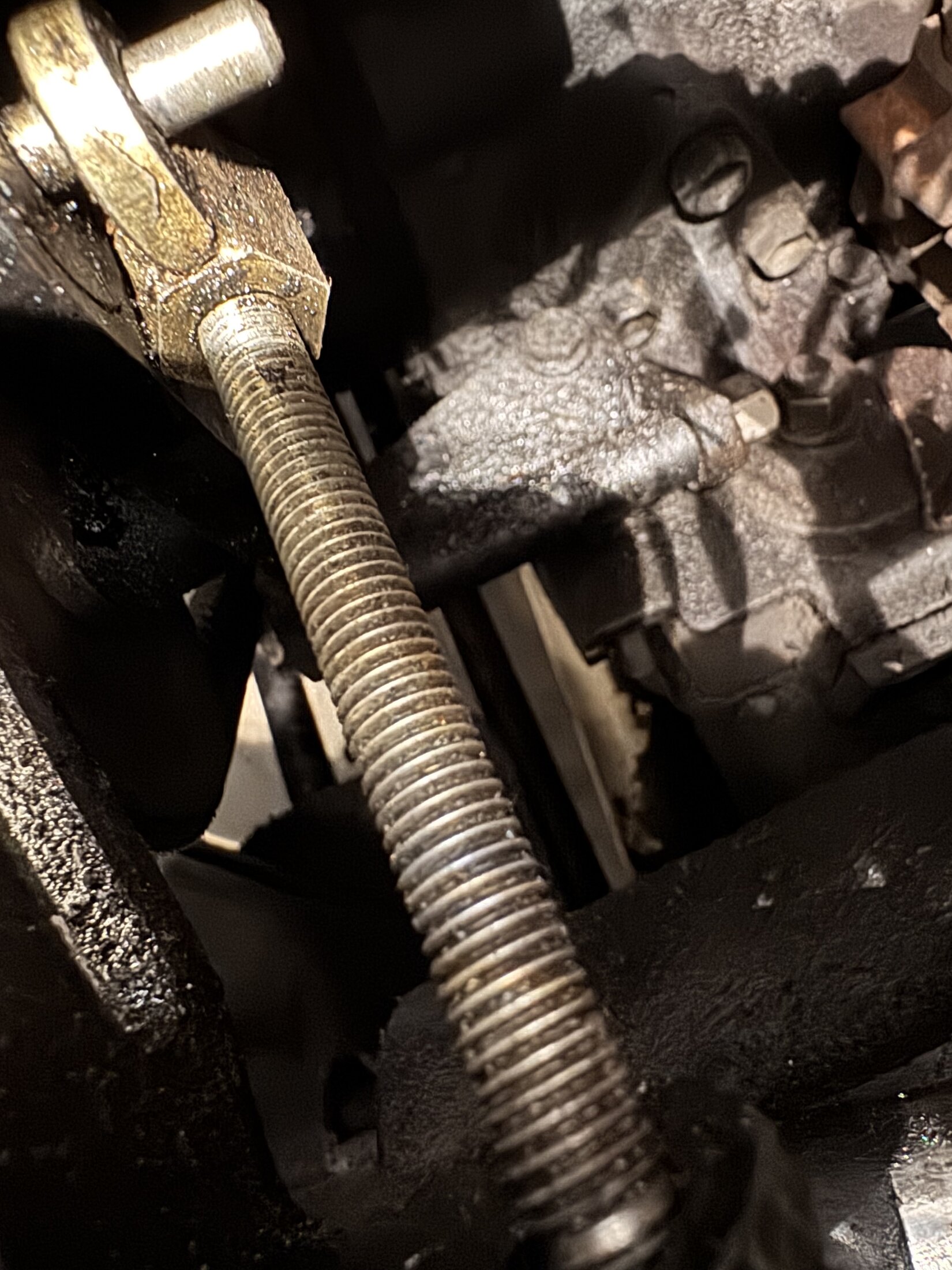

So, I definitely have the original pivot bracket but not sure on the adjustment bracket. Wondering if the delete set up will work the pump.
