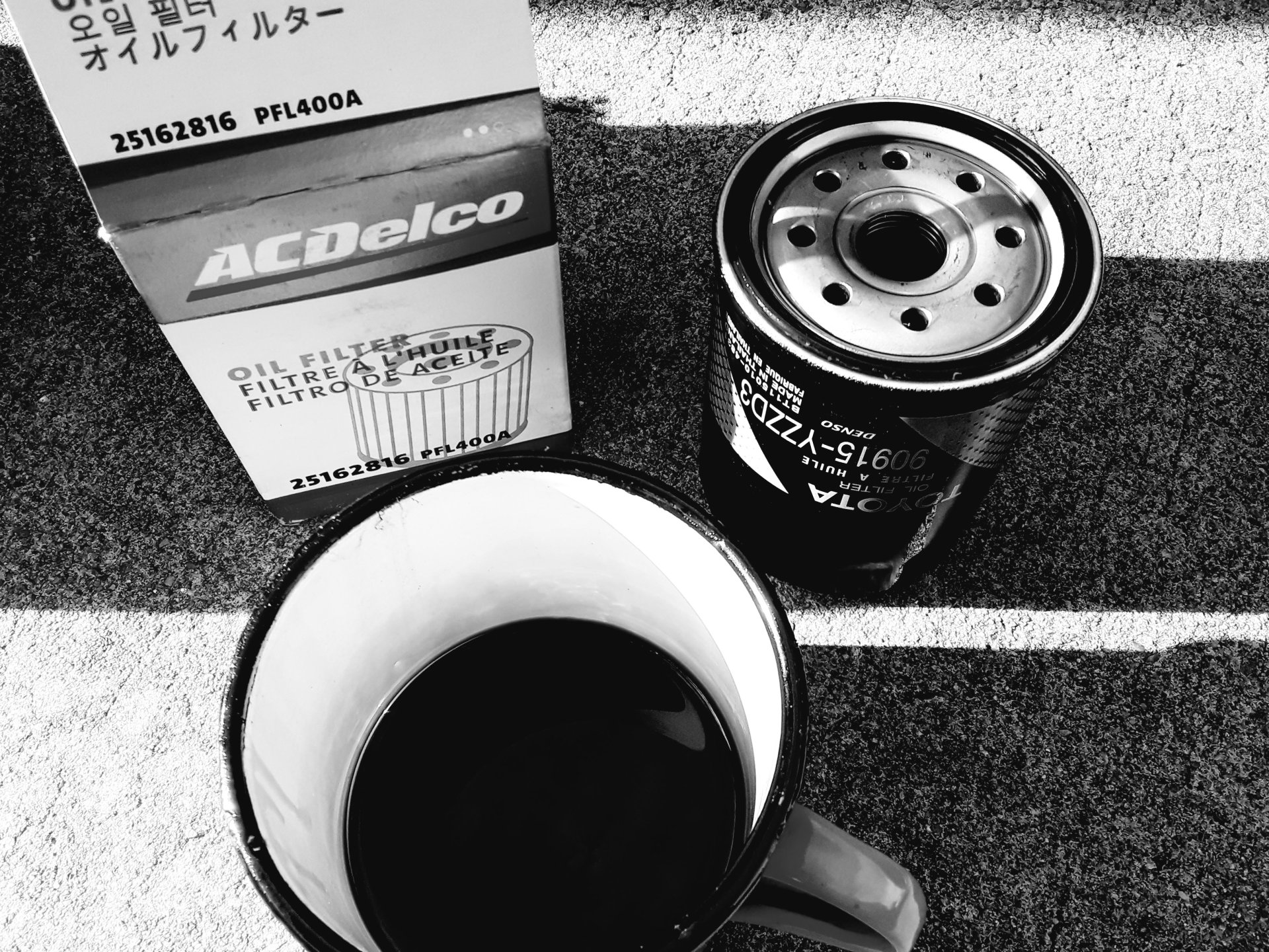

Could the smaller Toyota updated part number oil filter can fulfill factory engineering specs for psi of by-pass valve opening, but, it can't deal with the volume of oil needed to run thru the filter, or the other way around? I'm going to see if an AC Delco PFL400A filter can provide better oil pressure than the tiny 1/2-pint Toyota updated part number filter. Bring it up to temp, then change the filter. The analog needle on the factory instrument cluster is so appreciated right now.

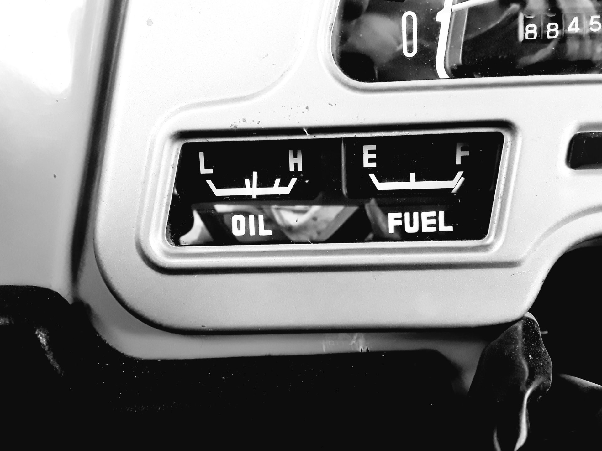

With Toyota filter:
with Delco filter, just ten minutes later, still in the 40 degree range outside: There is more black between the needle and the middle mark; with Delco filter the 2F has greater oil pressure. Both are measured at idle.
Use the fuel needle to compare perspective on the oil reading. I tried to rest the camera on the same spot on the contour of the steering column shell.

I'm leaning toward fully synth for winter; so what about an oil filter? The original oil filer was enormous compared to the updated part (photos from web). The updated Toyota part, it is like half the volume of what is the factory used on my 4-cylinder-daily. There are numerous physical differences, that I don't care about, or YouTube about. Don't actually care about filtering the oil, just want the pressure to be as far to the right as it is in the summer, if I can make that happen. Not happy with aftermarket stuff, but, I'll do what it takes to satisfy the pressure gauge.

The 2F oiling relies on your choice of oil filter to do the pressure regulating, how easy is it to get oil thru the media or under the by-pass/anti-drain flap, etc. That makes the Thailand Denso 90915-YZZZD3 filter a highly questionable filter if I can install a filter from a 4-cylinder that is double the filter media and double the volume.
Greater oil pressure means that more oil can pass thru tiny passages on the upper engine/rocker assembly, at a given temperature/ viscosity. My oil pressure suffers in in the cold. @Skreddy your signature suggests that you have an F engine. It looks more complicated than just temperature/viscosity, there is a mechanical pressure regulator that is under a boss cast on the drivers side of the block by the oil pan?
With Toyota filter:
Did you replace the oil that was removed when you removed the Toyota filter?
I think you’d have to cut each filter open to determine differences. To determine how those differences could potentially effect the results you’ve seen.
How many inlet holes? Metal internal core with holes or louvres? What are the end plates made out of paper or metal? How many pleats are on each filter? What is the anti drain back valve made out of? Does the bypass valve have a coil spring? What is the bypass valve settings? Total square inches of media?
@Living in the Past great idea! I’ll have to try that this winter.
No, the Toyota filter ran for less than a half tank of gas with fresh 5W-30 then I swapped in the Delco one.
There are enormous differences on the outside of the filters, inlet hole size and number being the first variety of traits. All I care about is the amount/pressure of filtered or unfiltered (with bypass open) oil I can push thru the can.

My oil pressure always stays around the 2nd mark of the gauge (a hair before to a hair after), even with an idle at 500rpm.
I used to run 15600-41010 when it was available and now I use the smaller 90915-40002 but it changed nothing to my oil pressure on the gauge.
