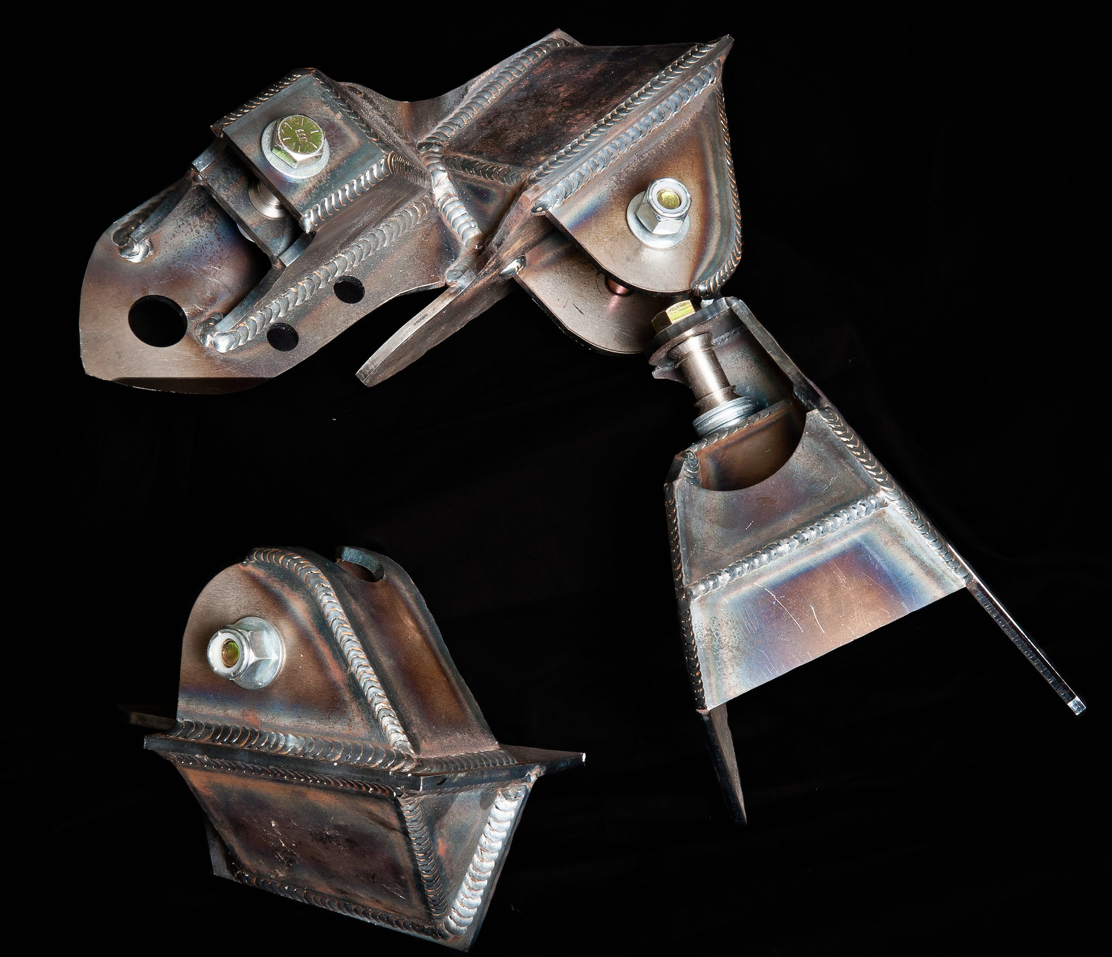

Brian asked if I could take some nice pictures of the brackets so I thought I'd share them too since we all enjoy some metal porn. Here's the axle side brackets. You have your 2 brackets for the lower links, 1 bracket for the panhard and the tower brace for the 3rd link
And here's your frame-side brackets. On top is the bracket for the lower link and 3rd link, all built together. This one goes on the passenger side. Bottom left is the bracket for the other lower link and lastly the new frame-side panhard bracket
Pimp!
Where's that 'Bigboy' dude and his radius arm diarrhea tech :D
I'm guessing he's deep in his troll cave this time of year, been pretty quiet lately.
Those welds are untouchable.
Someone's dropping dimes...
-A
Amazing right? I sat there for a few minutes holding the brackets, mesmerized by the welds. They almost look robotic. Take some serious skill to have such a steady technique.
