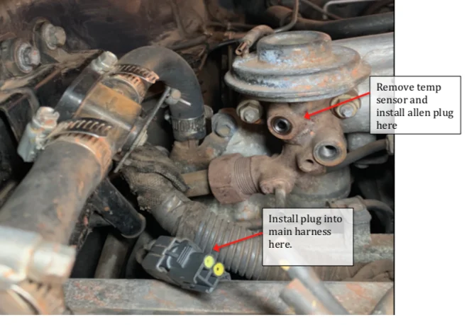

Is it necessary to remove the temp sensor? I did as part of the kit install and now have a low temp engine code, does this actually affect anything or can I just ignore it? I removed my check engine light bulb years ago so the only way I know if anything's wrong is to plug in a scanner, no idea if that code would illuminate it or not. In my sate my rig is exempt from emissions due to the age.

P0125- Insufficient Coolant Temperature for Closed Loop Fuel Control. Not sure if it means anything or not? Do they all do this with the test unit installed? It has been running a little rough since I installed it but I did a lot of stuff all at once(I know, I know...) so really not sure if the test unit is actually causing an issue or if there is some other problem. I also have an O2 sensor heater code showing but that's been there ever since I had the exhaust done.

Based on that, it’s likely unrelated to the EGR or the test kit.
Huh. Did some more digging and I bet I grounded out the shielding on the blue wire that goes to the O2 sensor when I replaced the pigtail. Damn this is such a great site for 80 tech!

It almost looks like you have picked the wrong plug on the harness. Unless the connector on the harness has been changed you should see it there.
Here is what you should see on yours. Let me see a pic of the temp sensor you removed too, that will answer it as well.

I did this on my '94...worked well when it worked. I left the sensor in as the "plug" and I'm glad that I did. Long story short, after about 800 miles (a few months), my truck started running like crap intermittently...unfortunately I was 400 miles from home at Relic Run when it started. Tried to diagnose, but with both rich and lean codes from OBD1, not much to go off of. I did get it home, but it was a loooong ride home and had a buddy shadow me for the first 300 miles...last 100 it was basically misfiring the whole way. After a a few weeks of diagnostics, I finally went to basically just yanking on wire harnesses...every one that I could find while it was running....turns out that it was the bypass diode thingy in the plug that failed. Removed the kit and it ran like a champ again.
All of that said, I'm thinking of getting another one and putting it back in...I hate those hot EGR gasses burning up the rear 5-6 cylinder head gasket area.

I did the bb’s too. Pulled them back out and plugged the egr temp sensor harness back in to return to stock.
