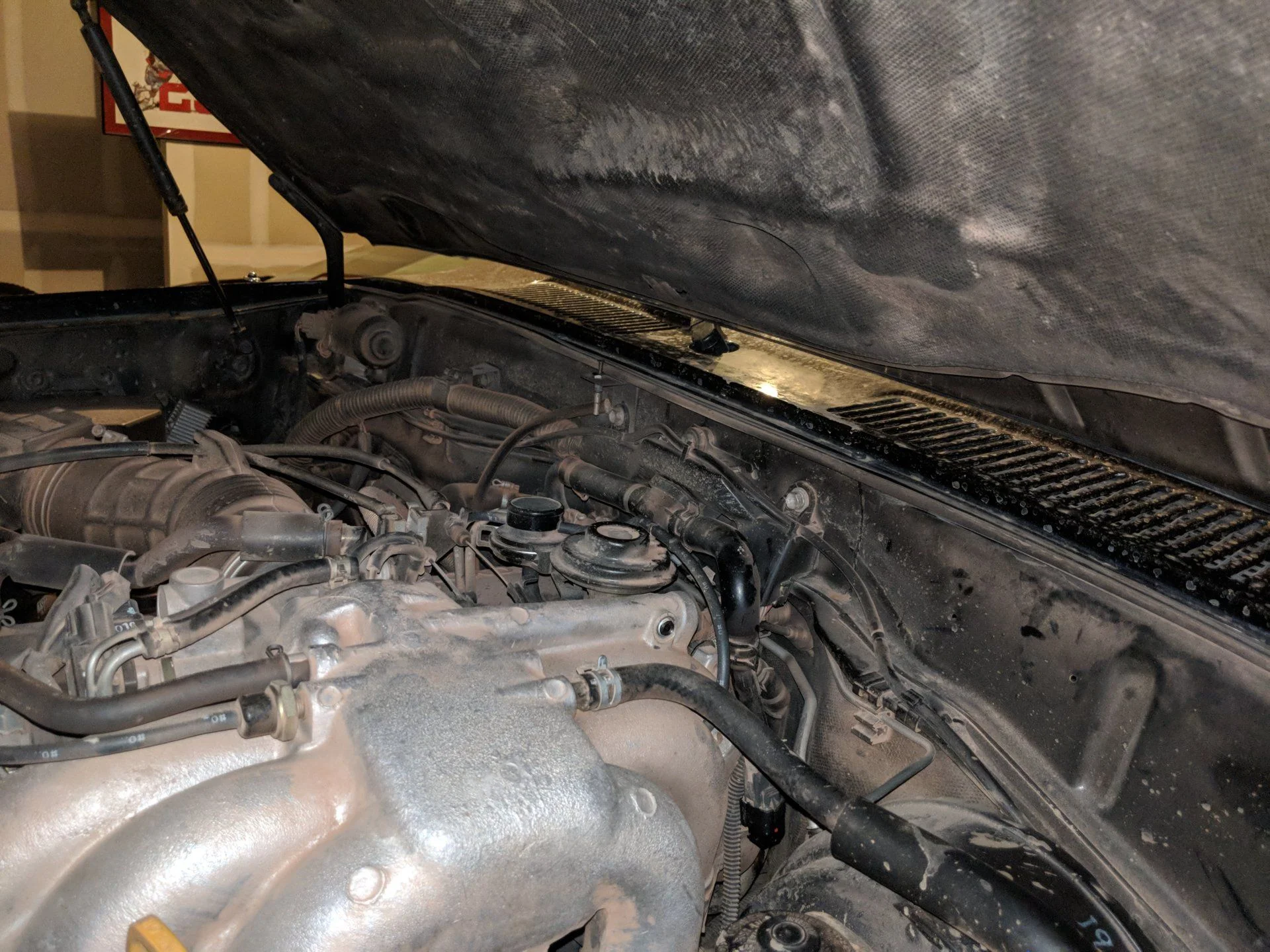

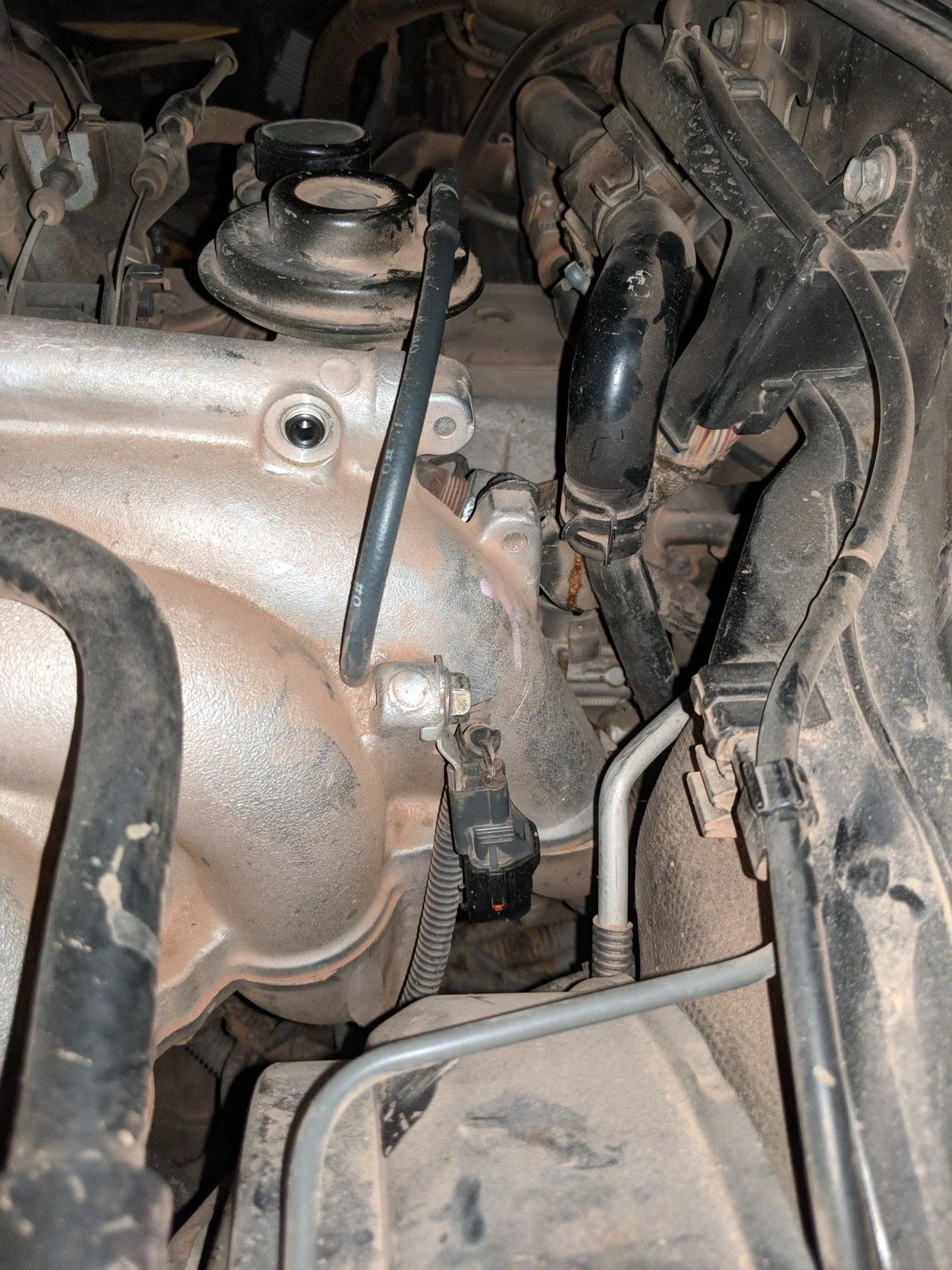

Figured I would post up a couple photos of how mine looks after it running flawlessly for about a month now. Loosened the bolt for the plug and swung it down out of the way for a cleaner look, you can also see the plug David now provides for the intake. No codes and I can reach my hand underneath the EGR valve after spending a couple bucks on ball bearings to block/plug the vacuum lines. Thanks @LC4LIFE!

Where does this plug go?
Probably the temp sensor hole.
