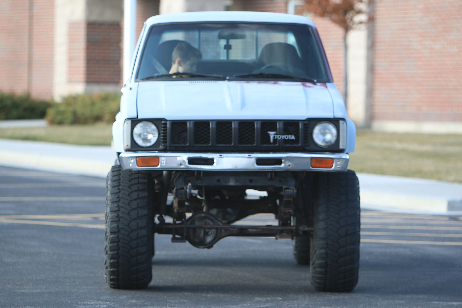

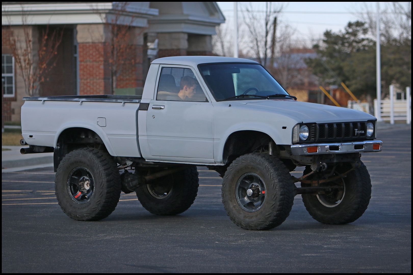

FZJ80 alloys (need to be repainted) from my '95 fit great on my son's 1980 Hilux without spacers. Although the stock axles are pretty narrow on these trucks so I'm considering some spacers until I can swap to a later rear axle and possibly an 80 series front axle.
They also fit well on my solid axle '86 without wheel spacers - although I do have highsteer.
The only reason why they don't look far too narrow is because the front axle is 62" wide - 6.5" wider than stock.
