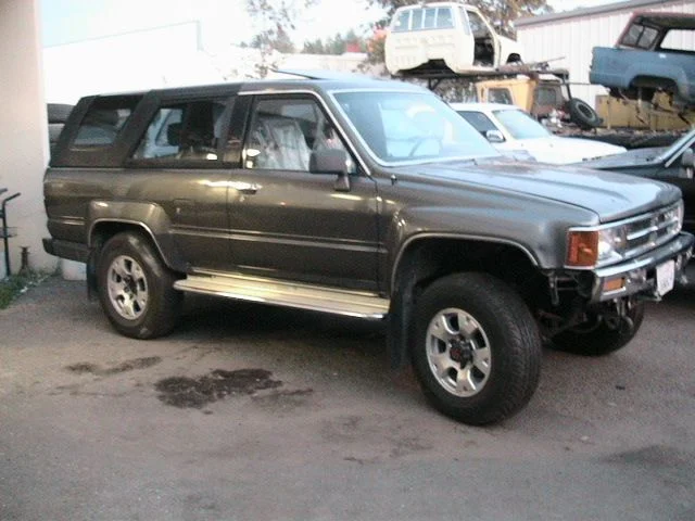

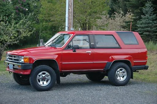

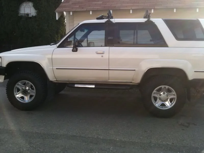

1) 05 tundra wheels on first gen 4runner.
2) 2000 4runner wheels on first gen 4runner.
Dont know if either bolt up or not. only found pics.

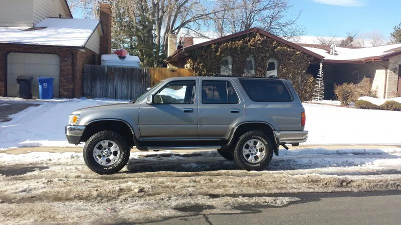

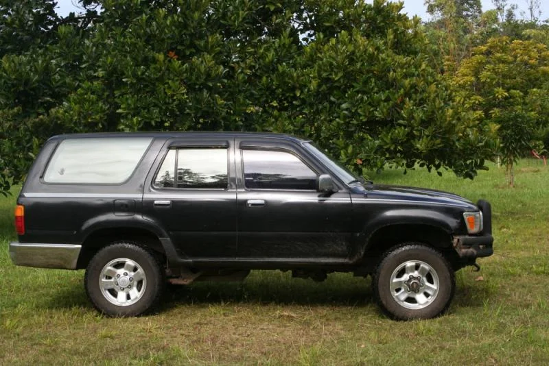

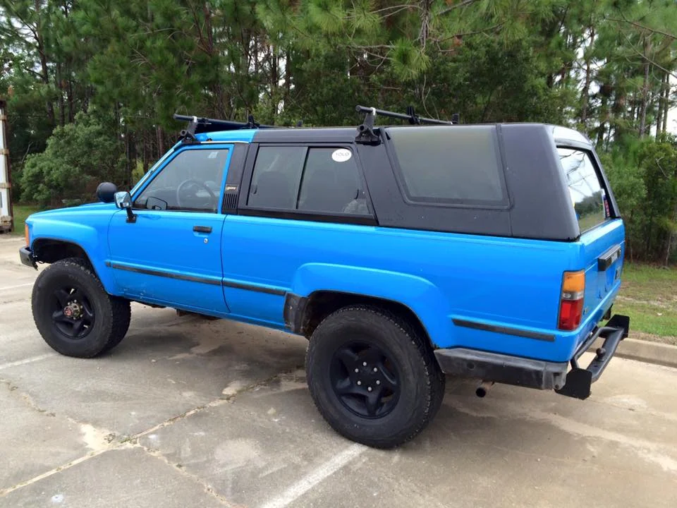

3rd gen 4runner wheels on first gen 4runner. straight bolt up i believe.

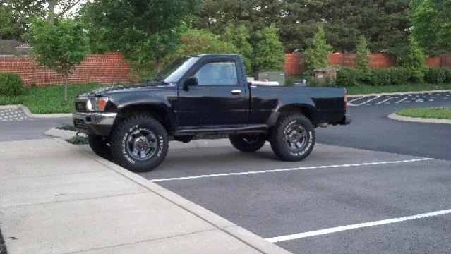

Here is my 90 pickup with 16" 4Runner wheels painted gunmetal grey.
Not sure what year exactly. They bolt right on and with the 265/75s they sit about a 1/2" outside of flush with the fenders. I will try to get a better pic tomorrow.
IFS to IFS? Late model wheels on a solid axle truck will not work. Back spacing is way wrong, especially if the truck has not been converted to cross-over steering.
