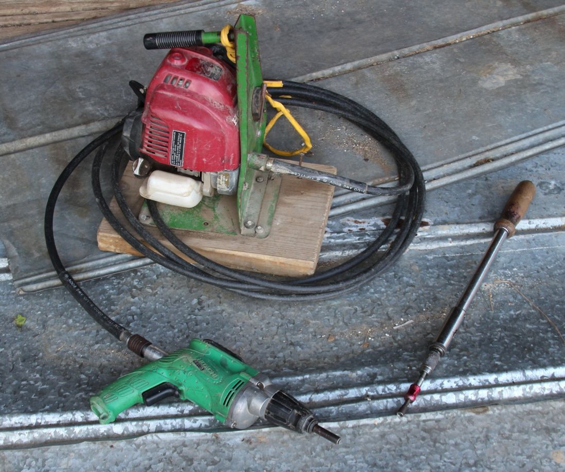

One nice thing was the weather stayed in the mid 70s this year vs. in the 90s in years past. Arrived back home to find more progress accomplished on the barn as well as another interesting tool. Instead of an electric (or manual) screw gun the guys have found a way to modify a weed wacker engine to do the job.
The old fashioned hand drill/screw installer is to the right in the above picture. Now, if you find you are an Amishman on the go yet still needing to install screws we also have the mobile version:
I realize this is not the tool or flower forum, but I like tools and I find the ways people engineer things to fit their needs fascinating. I doubt I will ever own a flexible shaft drive drill or screw gun, but I can appreciate the idea and creativity that went into creating it.
The tool you are referencing in this pic is what I used when I started cabinetmakers apprenticeship. What we called it was a Yankee driver/drill. I still have mine--somewhere. This was before battery powered drills were around. I never want to go back to using a Yankee.
