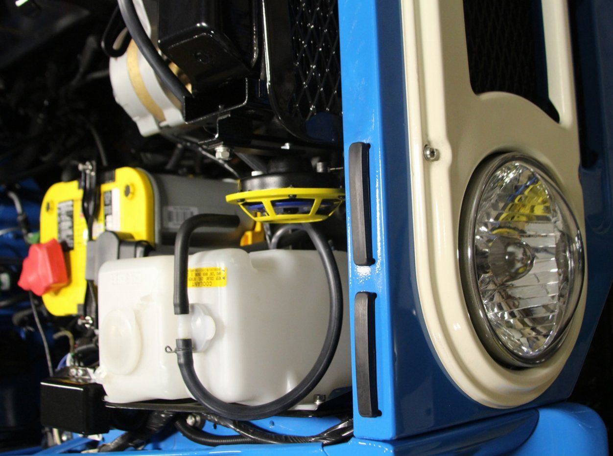

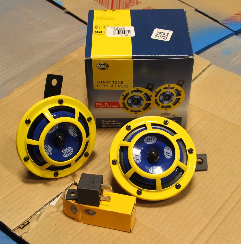

Horns.
I picked up a set of Hella Sharp Tones.
Several archive posts mention using Hella Super Tones as a replacement but if my wife's fashion sense has taught me anything its that red horns (Super Tone's color) do not "go" with a blue truck that has a yellow battery and shocks. She is also the one that has tried to eliminate tall socks and velcro wallets from my lifestyle. I remember back to the early days of dating and I was buying lunch at a Subway (only the best!); the rrriiippp sound of the velcro wallet opening stopped her mid veggie request and left a look of disbelief/confusion on her face. It is one of my favorite memories :). She married me anyway and it was not long down the road that a quiet, adult-like, fold open wallet was given to me at the next appropriate gifting holiday.
The Hella's bolted right in and I must admit the touch of yellow does compliment the other engine bay contents. Sorry bout the sideways pic -- forgot to rotate it before upload.
I know some of you will be quick to point out that there is a red battery terminal in the engine bay. No plans to change that as function does supersede cosmetics in some situations. ;)

Horns.

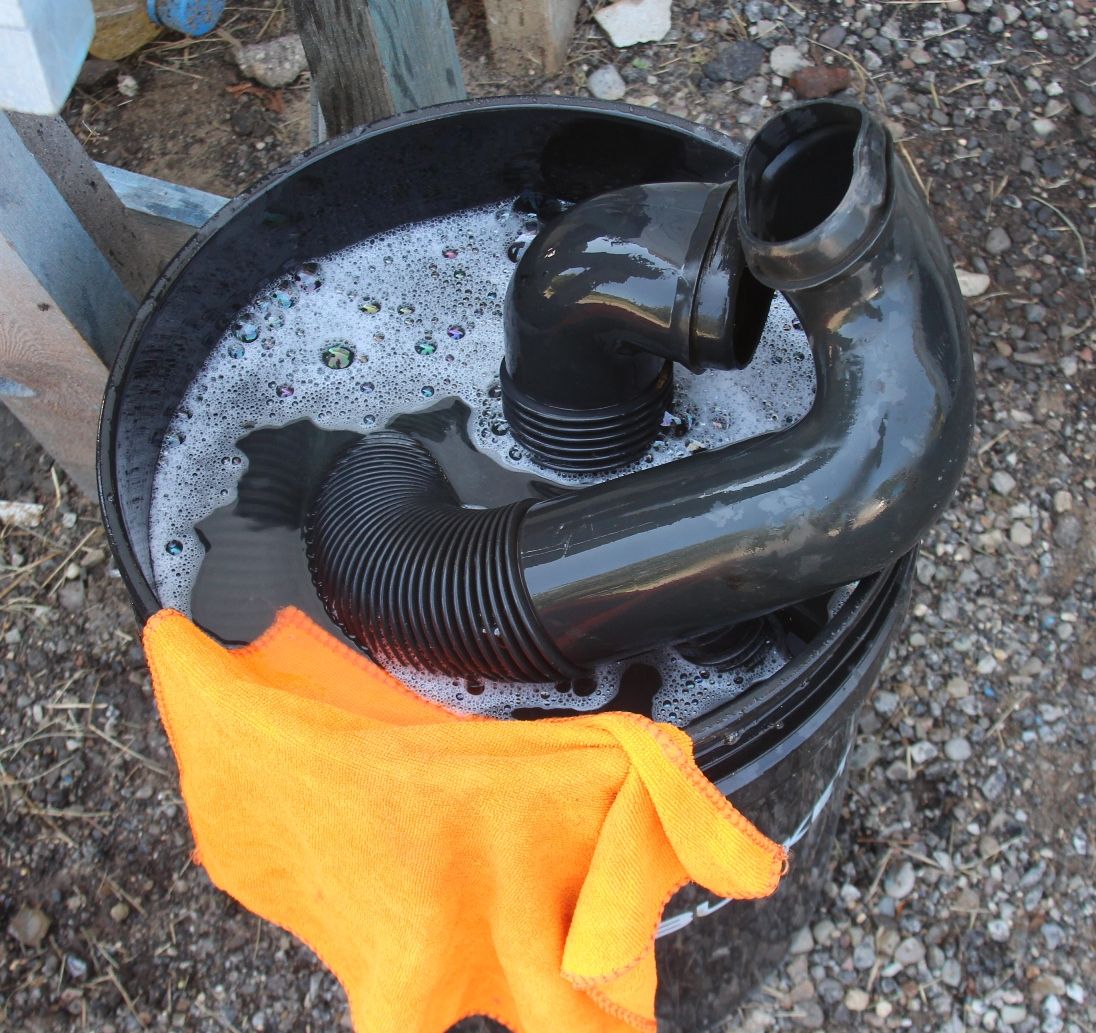

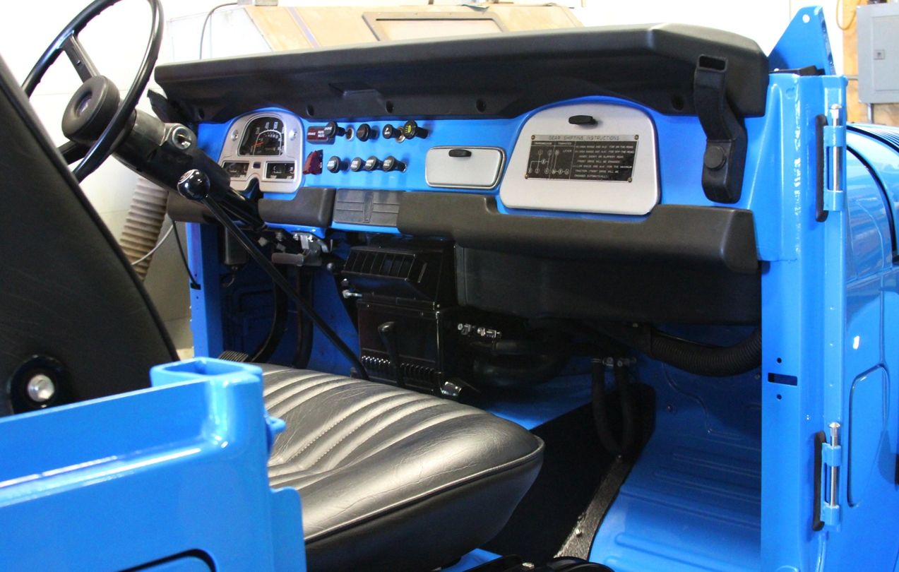

Spent some time this weekend cleaning and installing the defroster piping under the dash. Went the route of soap in a bucket. Even though the Mrs. was gone on Saturday I still did not want to risk running the pieces thru the dishwasher and having her find out. Usually we have an understanding that the only two appliances I use while she is gone are the fridge and microwave. Every now and again I get wild and wash a load of laundry, but there are too many buttons on the dishwasher for me to know what I'm doing.
While the door window defroster pipes are not my favorite feature they do fill the big holes on the dash.

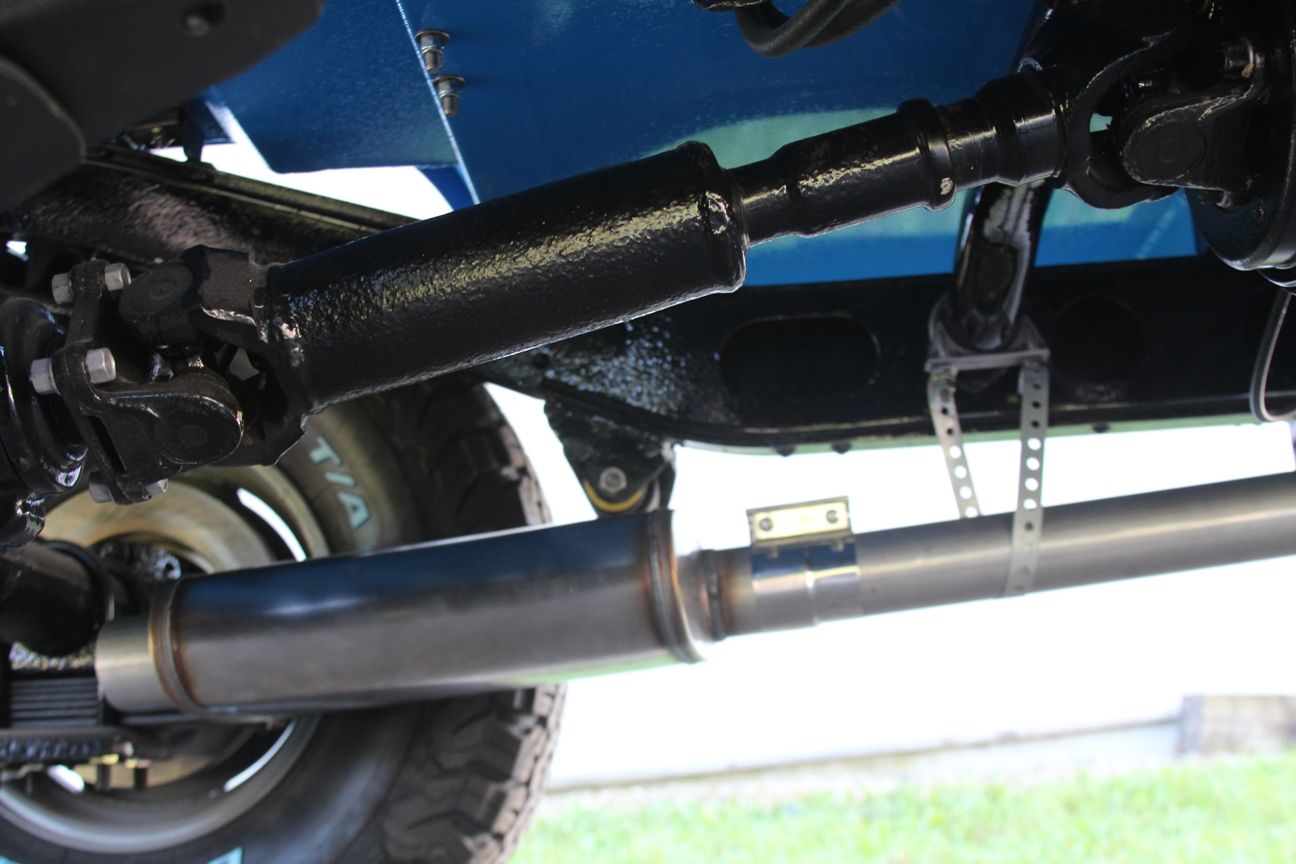

I also worked a little with the exhaust. I welded the flange to the pipe after determining proper placement. A test fit revealed the down pipe still needs a bit more bending before the hanger bracket gets welded to it (slants quite a bit below the frame) so I improvised with a metal strap and muffler clamp to get a feel for how the muffler will sound. The camera must have wanted to focus on the drive shaft, but you should get the idea.
I was quite pleased with the sound and tone of the muffler. . . dare I say it was rather quiet. There will be modifications done to muffler placement, pipe routing, etc. Right now I just want something in place to allow a drive to the muffler shop.

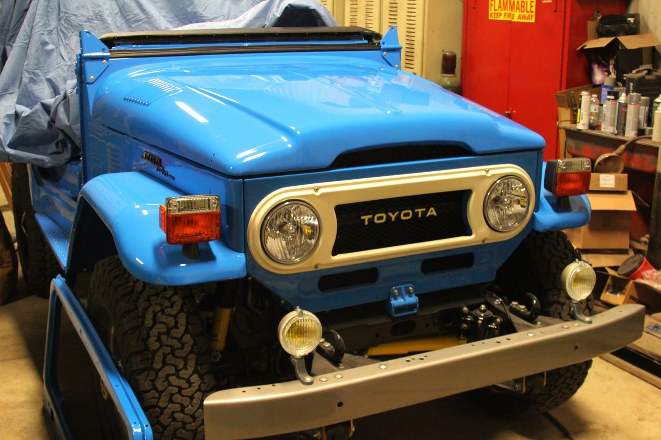

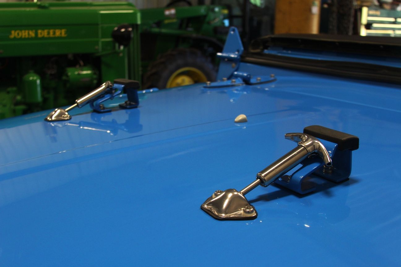

I also bolted the hood in place. The next picture is out of sequence, but the last task of the day was installing the windshield blocks and hooks.
I left the washer nozzle hole in the hood. . . this one will work as a backup if the windshield frame option gives me trouble.
Before installing those pieces I spent some time behind the wheel. I wanted to get the hood out in the light so see if there were any other spots that needed touched up before bolting things on.
Initially I struggled with the front clip lining up but after a tiny shim behind the driver side fender bracket things are looking spot on.

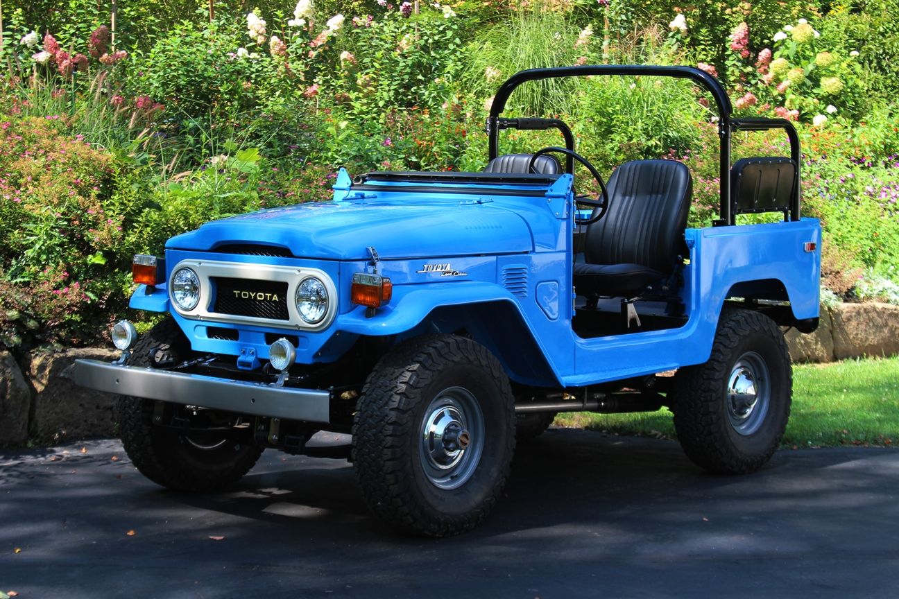

An hour or two later, couple gallons of gas in the tank, a driver side lap seatbelt, and a license plate temporarily bolted to the back. . . I officially became a menace to other drivers on the road as I pulled out onto the asphalt.
I did stop to take the picture -- safety first! Yes, the defroster panels have a "rust" line across them where the old dash pad left its mark. . . it will be dealt with accordingly.
It was only several miles and I doubt I topped 45mph (don't know how you guys do 70 on the interstate with these things!) but I thoroughly enjoyed the drive. For fun I also bounced around on several of the maintained "trails" we keep at the farm. There is about a two mile stretch between mom/dad's place and mine -- it has been dry the last couple weeks so I went for it.
And here is what the 40 looks like from the outside:

Today was a very good day. While the weather is nice I will make attempts to venture out farther from home and get a better feel for the 40's personality. I like the open top and feel of the truck but I am not used to being so exposed when cruising down the road -- I'm sure it is an acquired feel and I look forward to getting used to it!
looks great. Put a bikini top on - you'll love it. Driving around with no doors is a blast, but when I leave it to go into a store I have to resist the urge to take the jack with me - anyone can see it!
