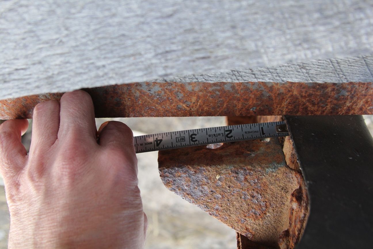

Measured the Radiator Support Mounting Brackets on the 1978 Frame from the front cross member towards the engine:

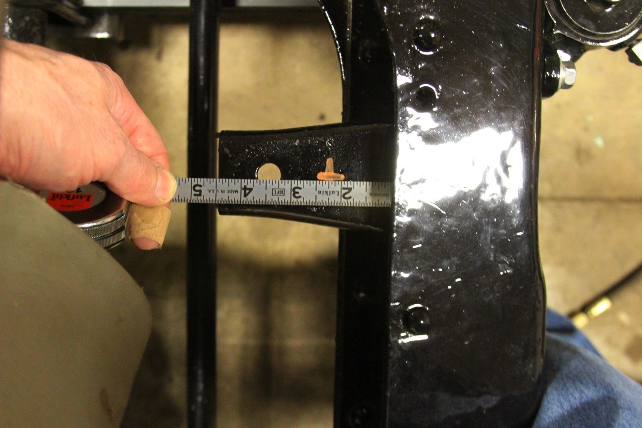

And on my 1972 Frame:
It appears the earlier brackets were 1/2" longer in general and the hole for the radiator support is just over an inch closer to the engine on the earlier frame.

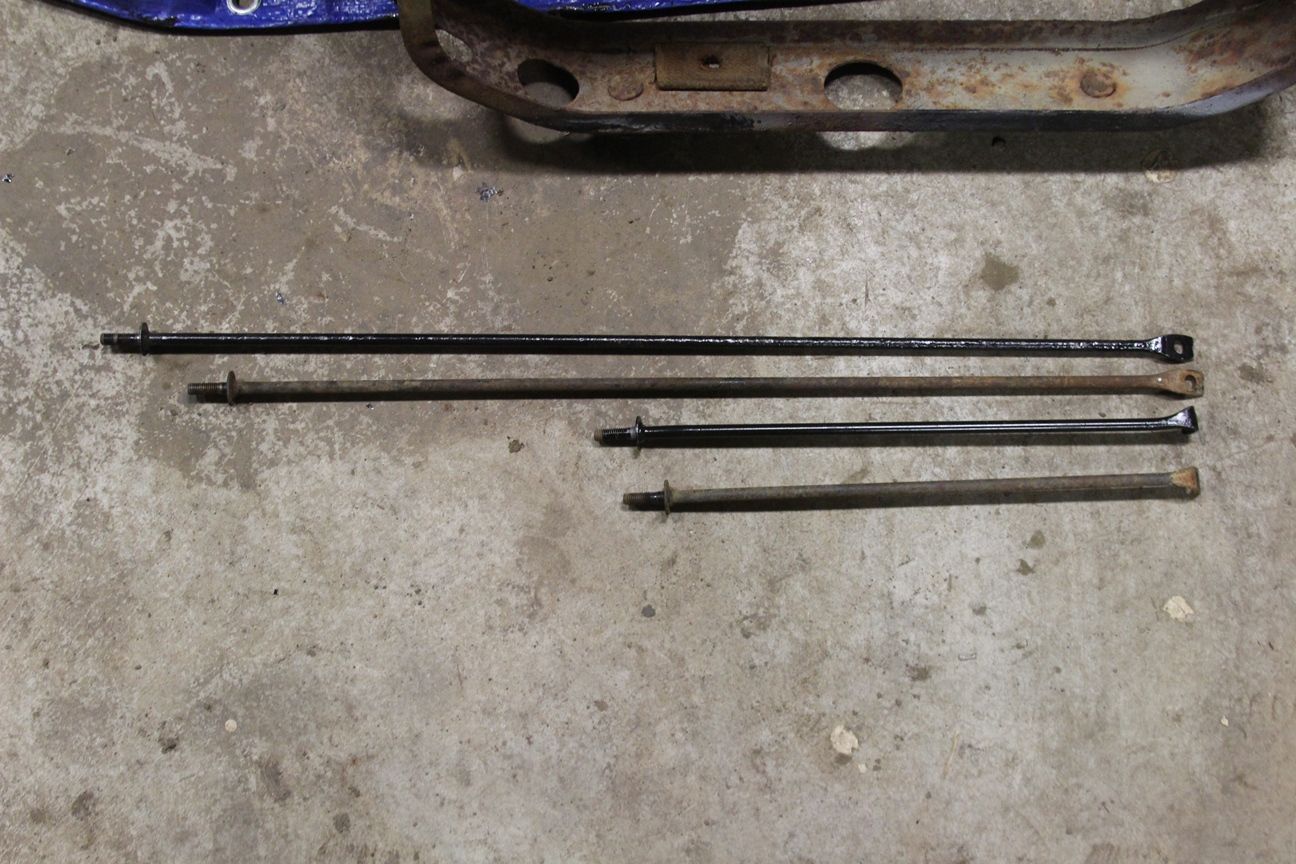

Makes sense why I had two different lengths of radiator support rods:

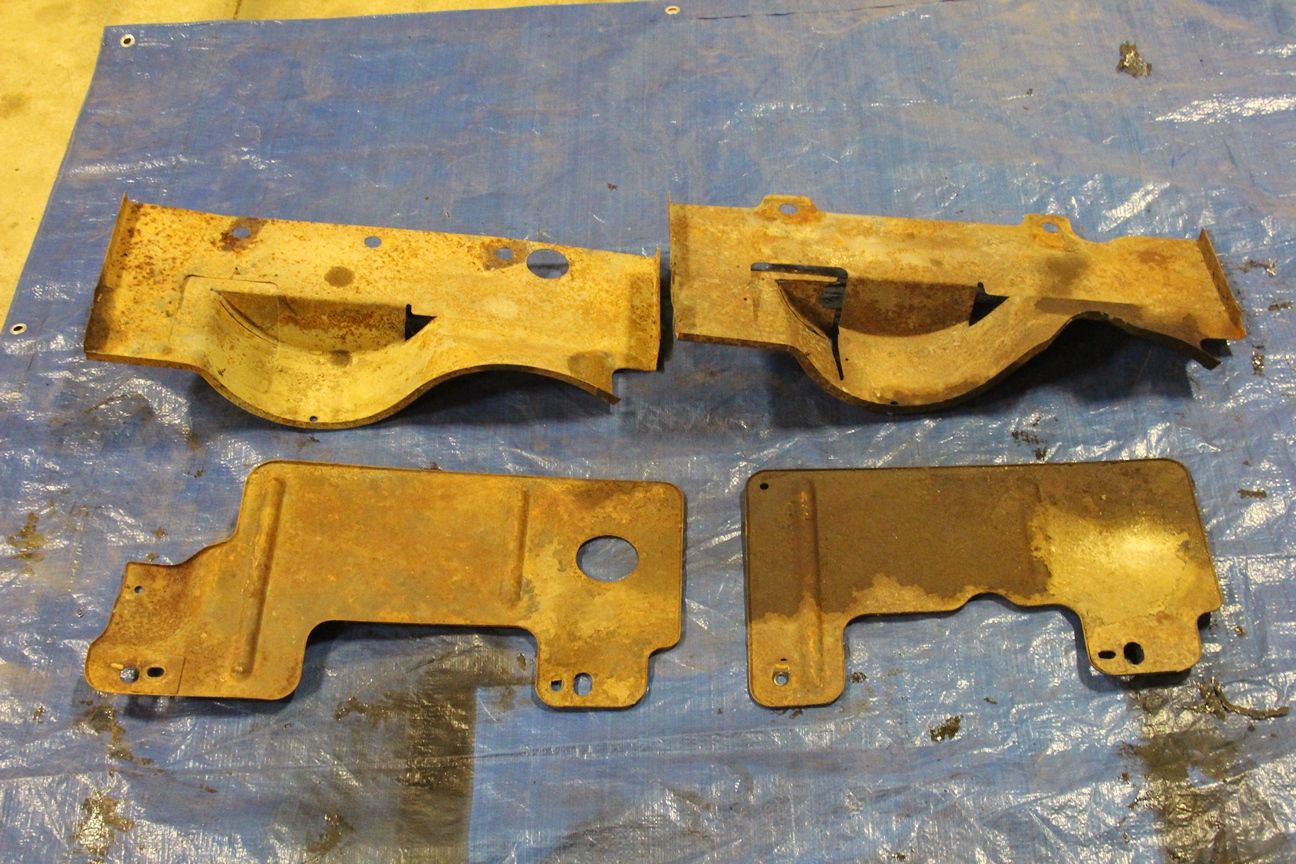

And why the front splash shields are different (1972 left top, 1978 right top):

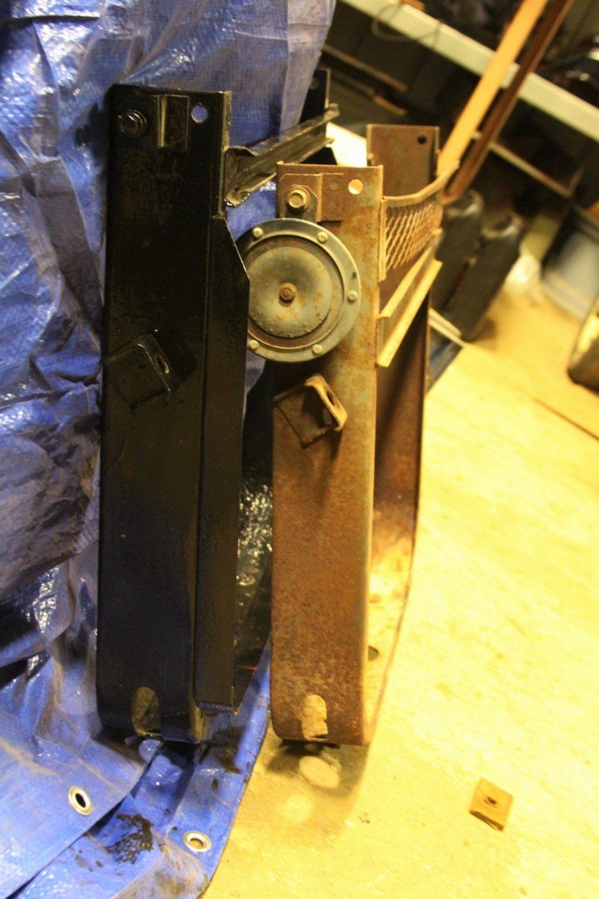

Put the radiator supports side by side and the 1972 frame (painted black) does have an extra metal lip that extends about an inch forward that is not on the 1978 frame. It appears there may also be a height difference between the two but part of that could be the angle of the picture. I originally cleaned up/painted the 1972 frame by chance because it had less broken bolts stuck in it and one of the captive nuts is missing on the '78 (OK, I was lazy). Looks like I will be cleaning up the '78 frame after all. The small expanded metal mesh across the top also needs fixed or replaced.
Provided the front bib/headlights clear the radiator support the most cost effective move at this point is to drill two new radiator support holes farther forward on my 1972 frame. I can then use my new water pump and fan clutch as designed, and much cheaper than buying a new water pump and fan.
Apologies if this is common knowledge. . . I went thru 40 some pages of archives before I found any mention of it (back in 2005) after FJ40Jim brought the difference to my attention. Perhaps I am not using the right key words in the search box. . .
