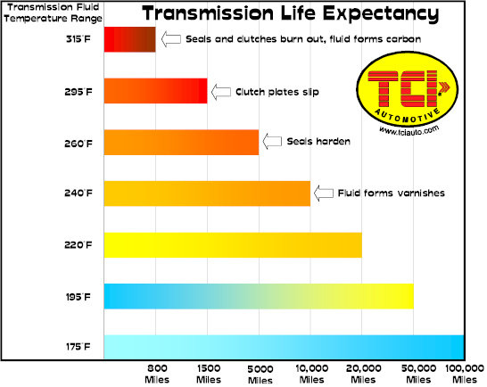

Isn't the overheat situation for a 3rd gear lock something like 290F, and isn't the AT Temp light triggered at 306F? If that is accurate, both are far too hot IMO and a fluid change would be required ASAP.

You have to get it pretty hot to cause damage.
My highest temp (before oil cooler was added) was 238F. I was pulling the 4K lbs camper in 4th/5th gear on a steady climb through WY/MT to the NW entrance to Yellowstone NP. This was early October but outside temps were still mid-sixties during the day. Since the cooler has gone in, highest temp was 212F while towing through Michigan in summer.
I'd consider 306F when the AT/TEMP light kicks on pretty hot :). I haven't seen a more up to date chart, but the charts seen to indicate damage anywhere above 240F. I would not want to run my engine at 240F and the same goes for my trans.
