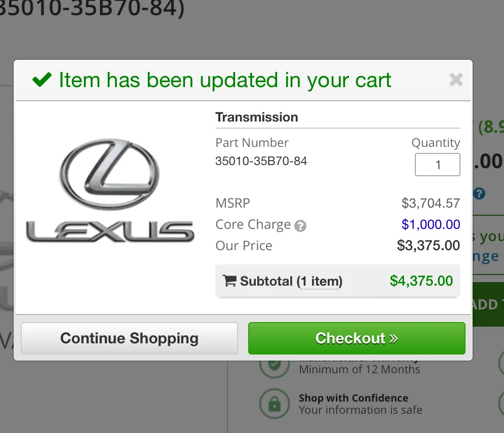

Are the OEM remans back in stock? Looks like they are $4500 or so:
From reading these posts, I'm wondering if the lack of an AT cooler is the cause of the GX460 transmission failures, as they appear to be not-uncommon. I'd suggest a cooler upgrade with your new transmission - and bigger than a OEM cooler (like a Hayden 678). If it did spit out some metal at the last change, your cooler lines and radiator are going to be contaminated with shavings as well.
Good catch about changing out the trans cooler as there may be particulate in there! 👍
Yeah, and as Rednexus said, upgrade your tranny cooler and add seconded one. That's on my list of things to do.
$3,400 for a Lexus reman anything seems like a deal. I personally don't see this being more than a day for a shop to R&R, so maybe $1K there, plus whatever it takes/costs to flush or replace the radiator and cooler lines.
That price is pretty reasonable actually. I'd jump on it if I was the OP.
