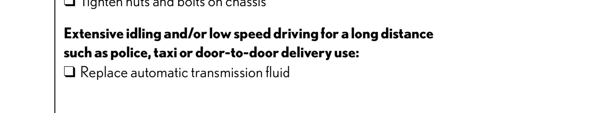

I think the core issue is that Toyota/Lexus service states that the GX has "lifetime" transmission fluid and its true that if you never replace your AT fluid, it will last "the life" of the transmission...

Remember most 470s had an external AT cooler while most 460s did not. Also that thermostat setup was added on the 460 as well.
Even this was added in recent years for 60k mile AT service
