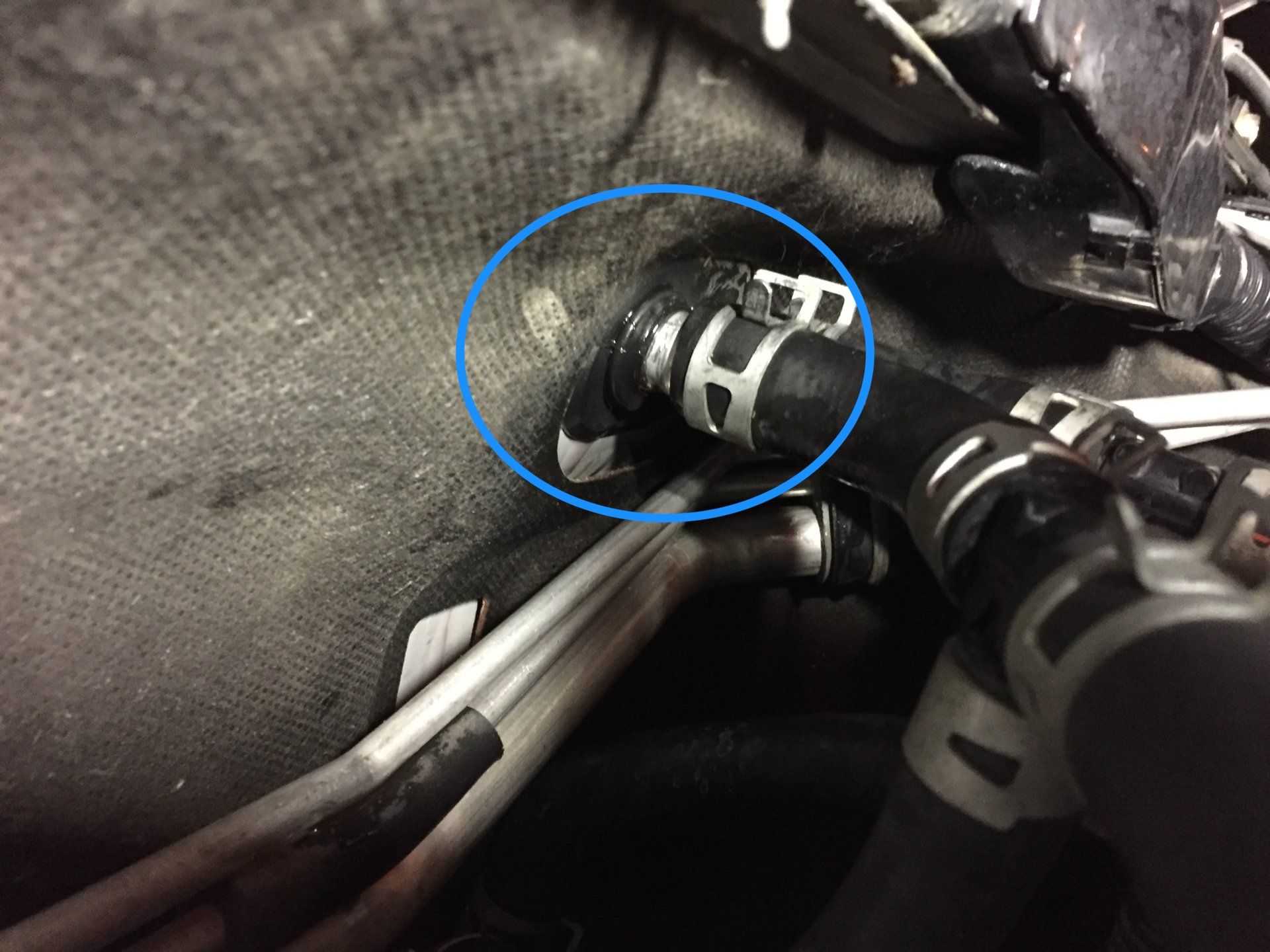

Just replaced my T's and hoses (all with OEM), went to fire up the vehicle and i have a bad leak coming from PS firewall inlet. I've double checked the hose, tried a different clamp and indexed the position of the clamp on the hose but it is still leaking...bad. Anyone have a similar issue? Any suggestions on what to try next?
Have you tried with hose and clamp pushed on/in about 3/8" to 1/2" further. The OEM clamp will not work well if over enlarged tip of pipe, needs to be about 3/8" or more back of.

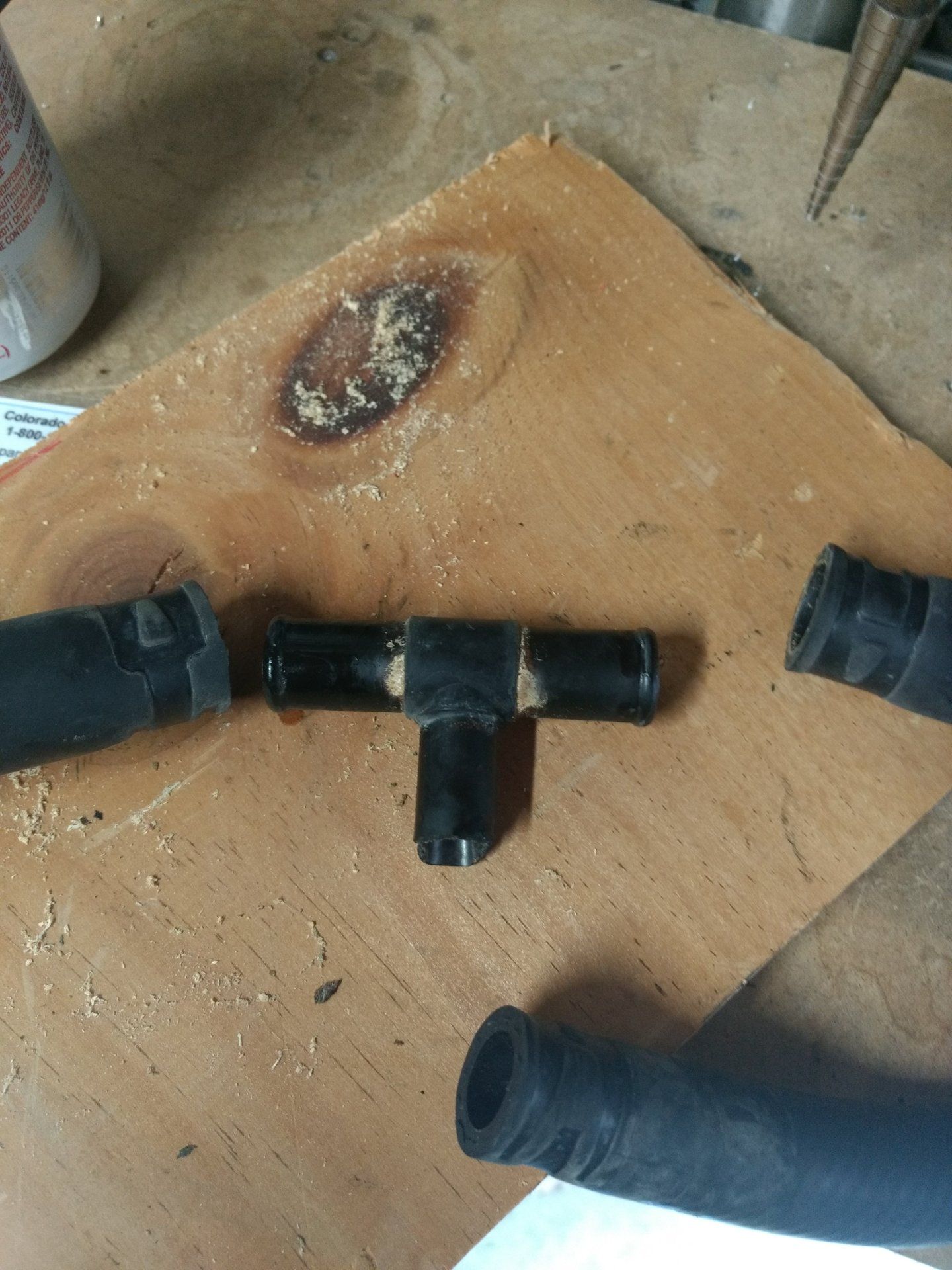

So I decided to tackle this PM item. After slicing the hoses & taking the complete assembly off, I was a bit disappointed to learn that my tee's looked perfect. But then I find this lurking in the one of the long hoses.
It was ring shape, guessing the fat part at the end of the Tee. Disintegrated when I pulled it out. I guess the PO replaced the old crumbling Tee but left a big chunk of it in the hose. So I guess I was lucky after all.
Thanks to everyone's suggestions of taking the complete assembly off at one time.
