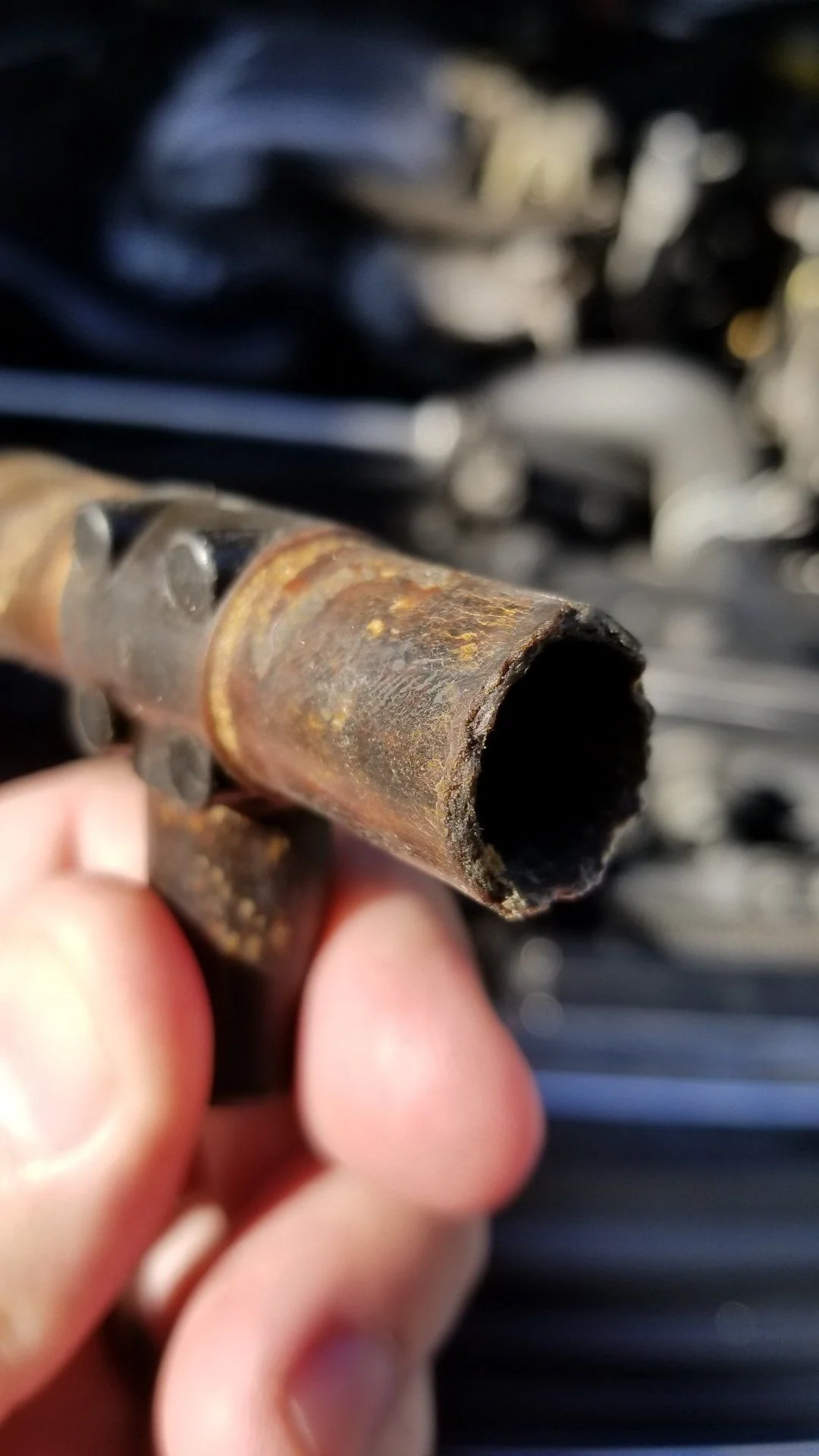

Ok, so the massive cast iron engine block has coolant passageways in it. Iron can have a galvanic corrosion reaction with aluminum. So, why did the Toyota Engineers pair an Iron block with aluminum heads? So, with that fact, do you still think those tiny brass tees are going to have an ill-effect on the aluminum components of the engine?
I’m happy to report that I’ve had perfect success installing Toyota plastic tees into my 06 LX two weeks ago. I replaced the metal tees that began to develop a leak where there was corrosion around the metal…. The metal tees were perhaps 6 years old, fresh coolant and no weird chemicals in the system, just red bug juice.

This is comparing parts 87248-60460 (plastic Tee) vs 87248-95400 (Brass tee - denso/made in Japan).
See picture with measurements below. I rounded up but dimensions are within such tight tolerance and identical across parts that it's not worth posting all measurements. For functional purposes they're identical, same width height, length of flare, you name it.
