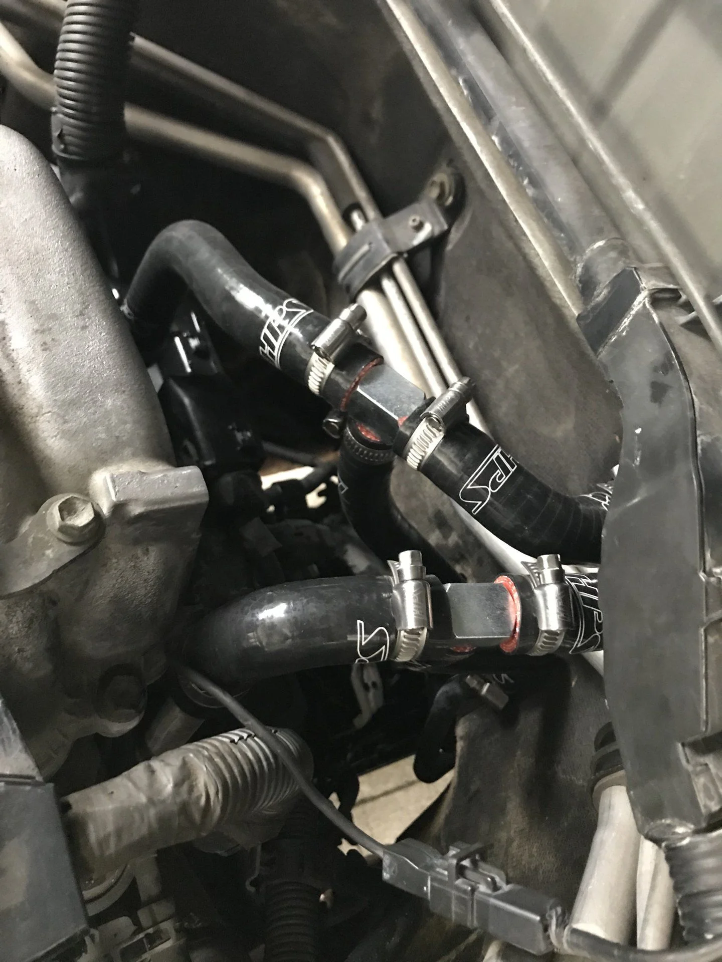

Just did mine and upgraded all the hoses back there with red HPS silicone hoses as well. No more need to worry for the life of the truck.

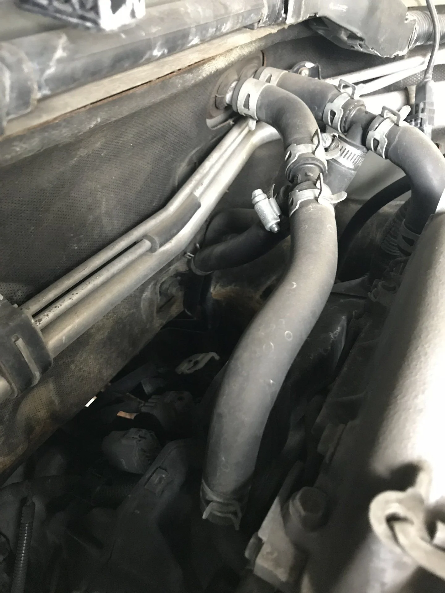

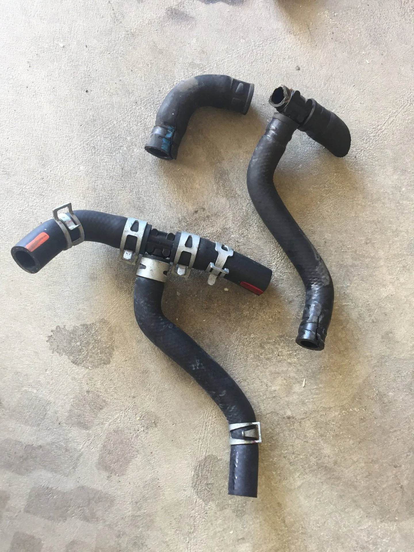

As you can see there was some evidence supporting replacing the Ts, but IMHO they could have lasted another 110,000 miles. Replaced all hoses, they were a bit swollen but nothing to bad.
Edit: Top T is from hot side.

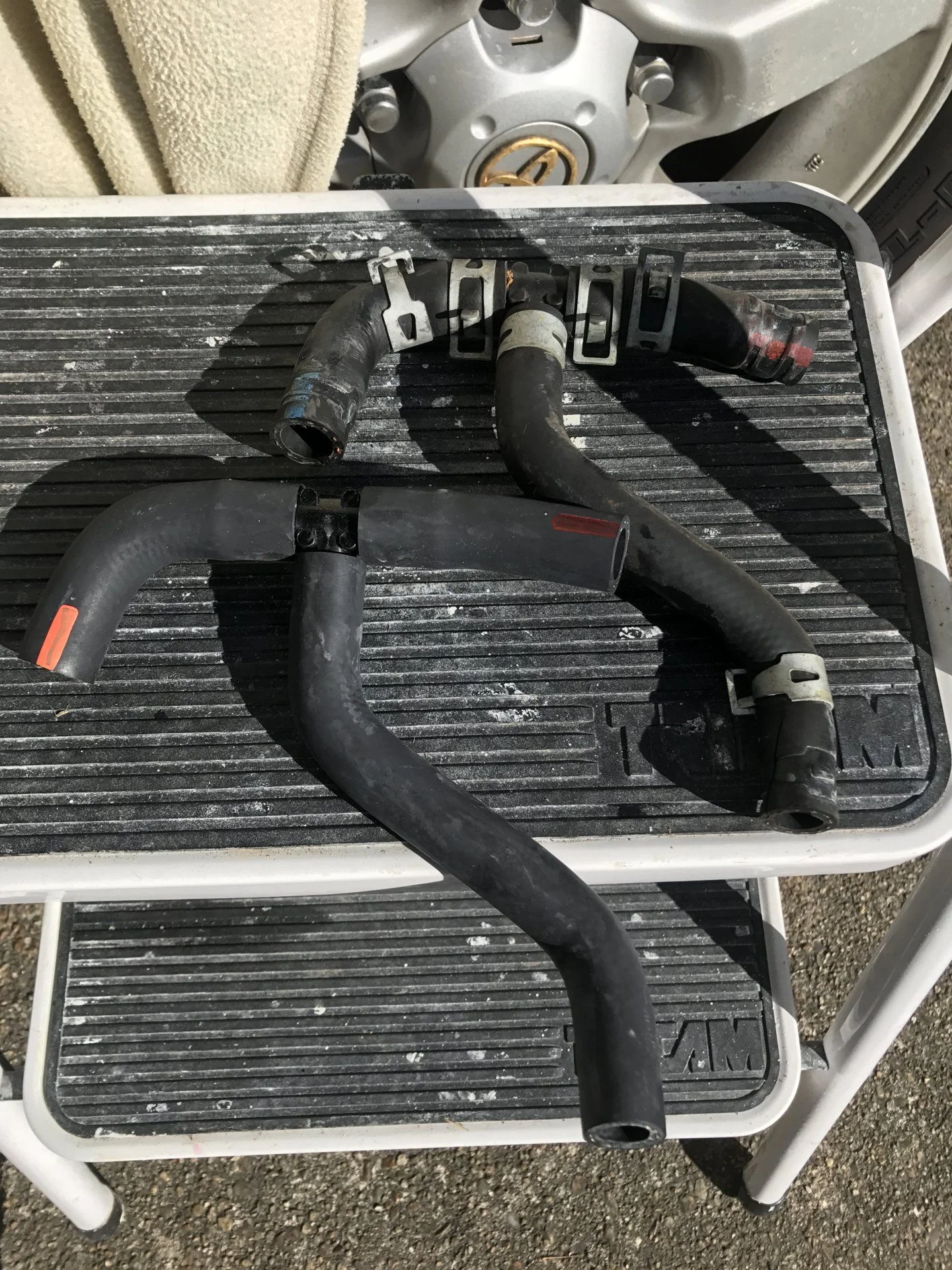

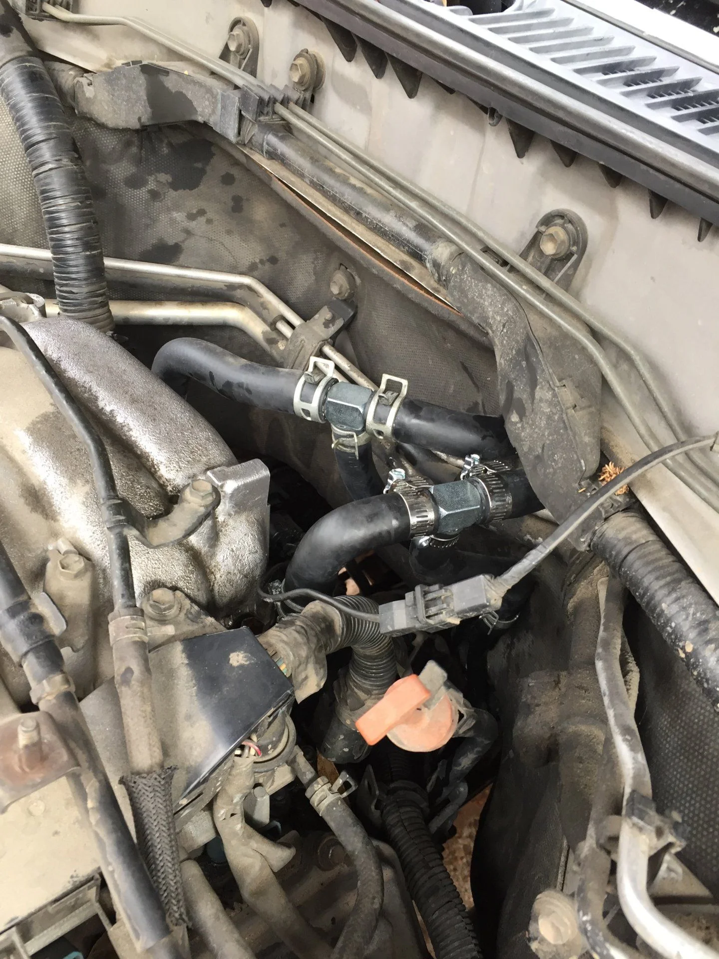

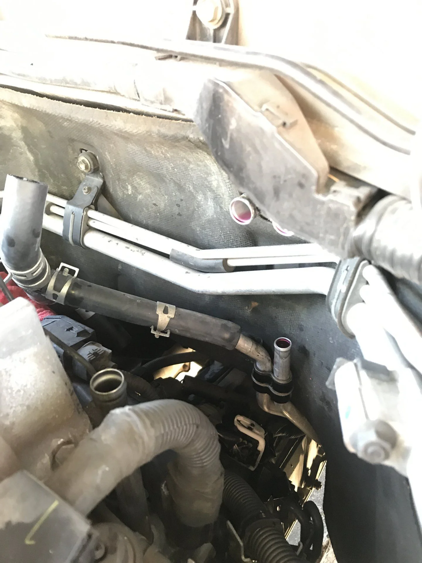

Replaced mine today, 140k miles. Took me just over an hour. All oem, reused existing clamps. I’m glad I did hoses along with Ts, the old ones were really hard to pull off. I ended up just cutting most of them. I lost just enough coolant to make me nervous, then it stopped flowing.

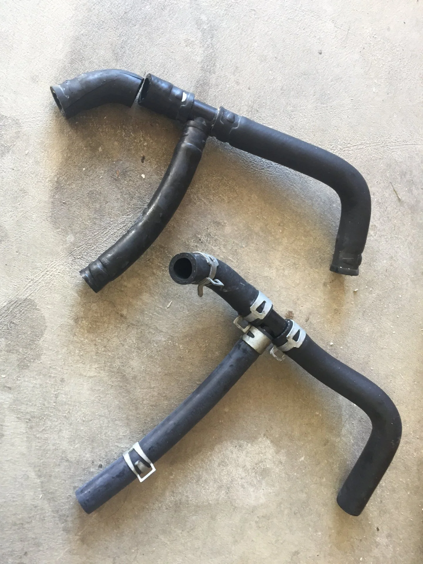

Passenger side (new on bottom):
The new hose (the small diameter one) I got from Toyota was longer than existing but it worked out fine.
Driver’s side (new on bottom):
The Ts seemed pretty solid at first but I was able to break this one by hand without too much effort. I’ll change them again in 90k with my timing belt.

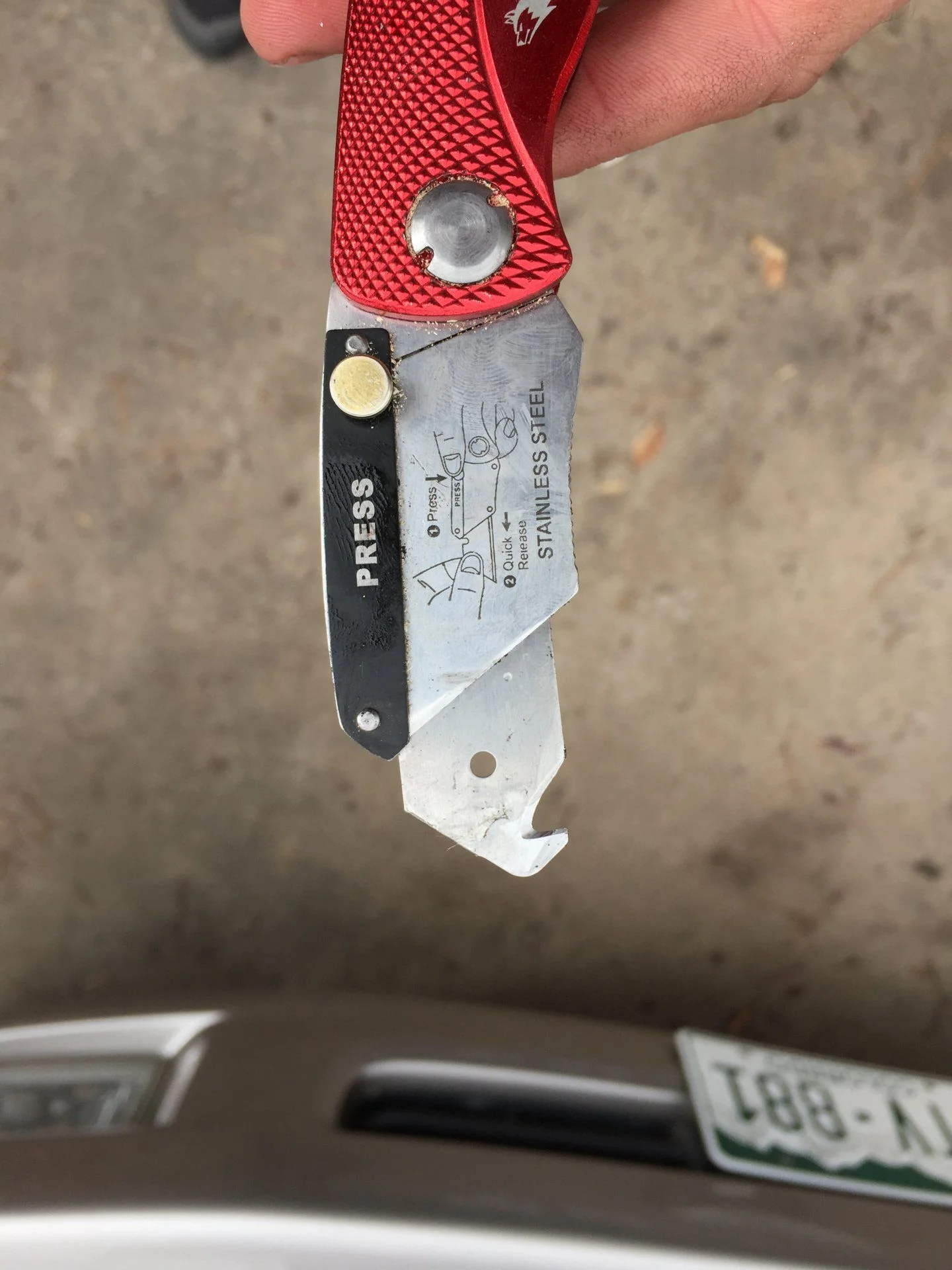

Replaced today. Appears PO had done one T before and hoses were a bit over-clamped and weeping a little. The cold return one (I think, closer to passenger side right) was actually more brittle. Maybe it was original. Had the hoses to replace as well so it was nice just to be able to cut everything out. A little difficult to get hoses off fittings I used a hooked razor that I have for removing golf grips that saved the day. Looks good to go with the 4 seasons T's.

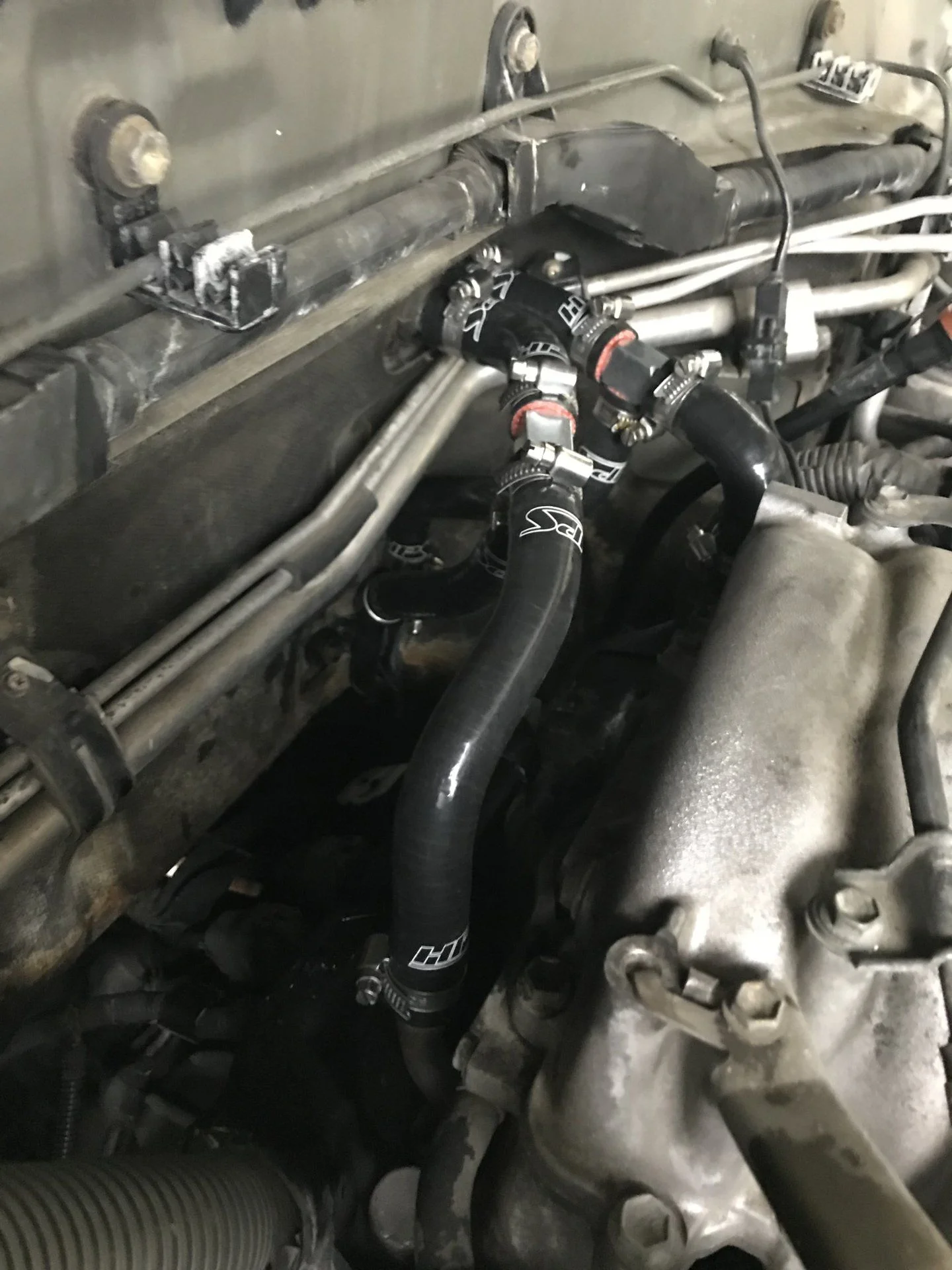

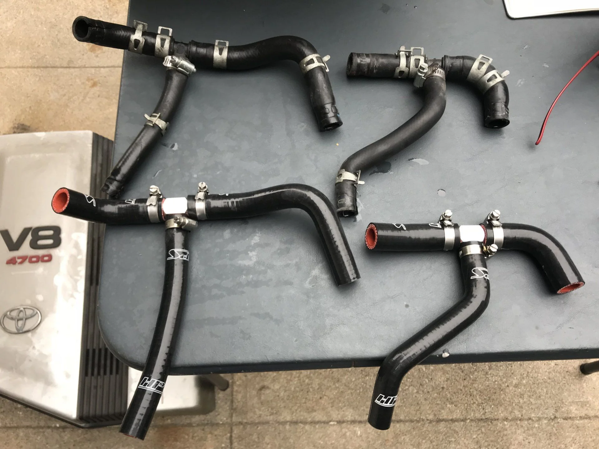

I decided to replace T's, hoses and clamps. I used the Four Seasons T's and silicon hoses from HPS.
Before.
I razor-bladed the old hoses off and then assembled the new sets.
Here's what they look like installed.

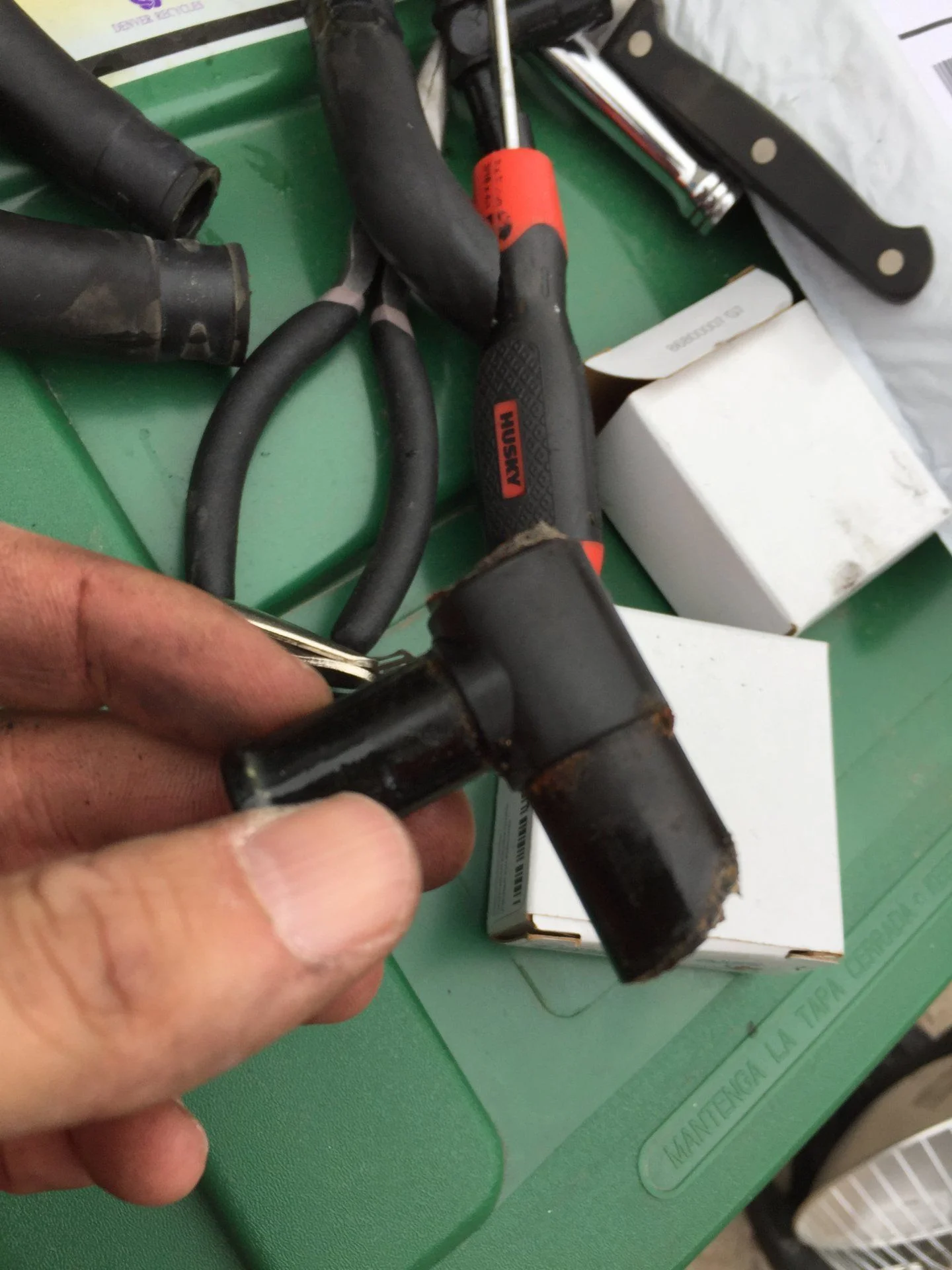

I just replaced mine. One fell apart as soon as my hand touched it, and I had to fish bits out of all 3 hoses. The other must have been replaced before, it looked to be in pretty good shape (but didn't look new).

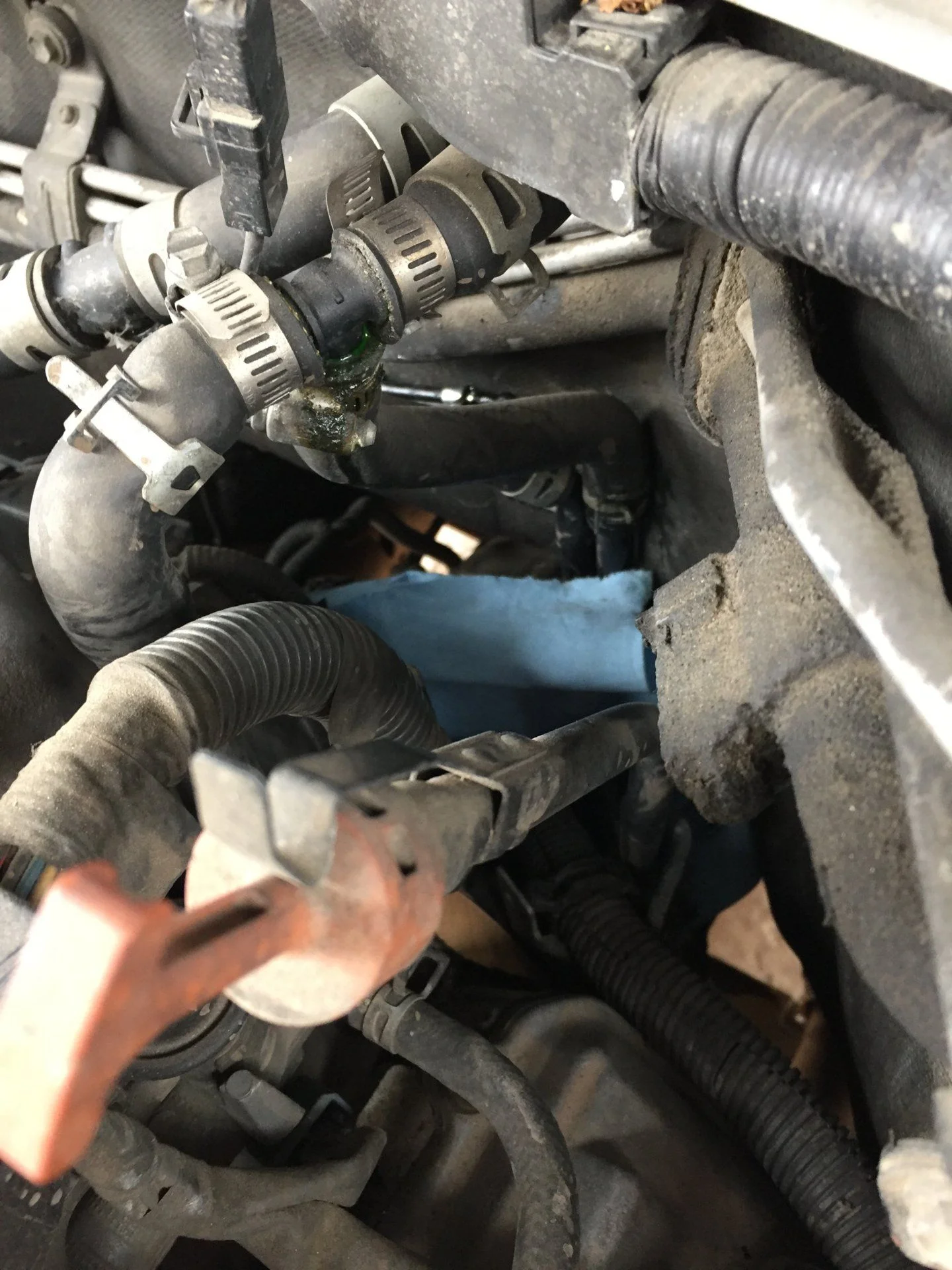

I'm short on time so I can't read through all the posts at the moment. But I just want to confirm that there are 2 sets of heater hoses on my 2001 LX470? My indy mechanic replaced 3 heater hoses and T fitting a few months back after he called me saying it was leaking during an oil change. I took my truck to a Lexus dealer for an oil change yesterday because I needed a loaner and they called me saying the T fitting and heater hoses were leaking and needed replacing. I looked when I got the truck back and sure enough it's leaking but it's the one on the passenger side...are there 2 sets? The one of the driver side looks newer, no leaking...they are right next to each other though.
