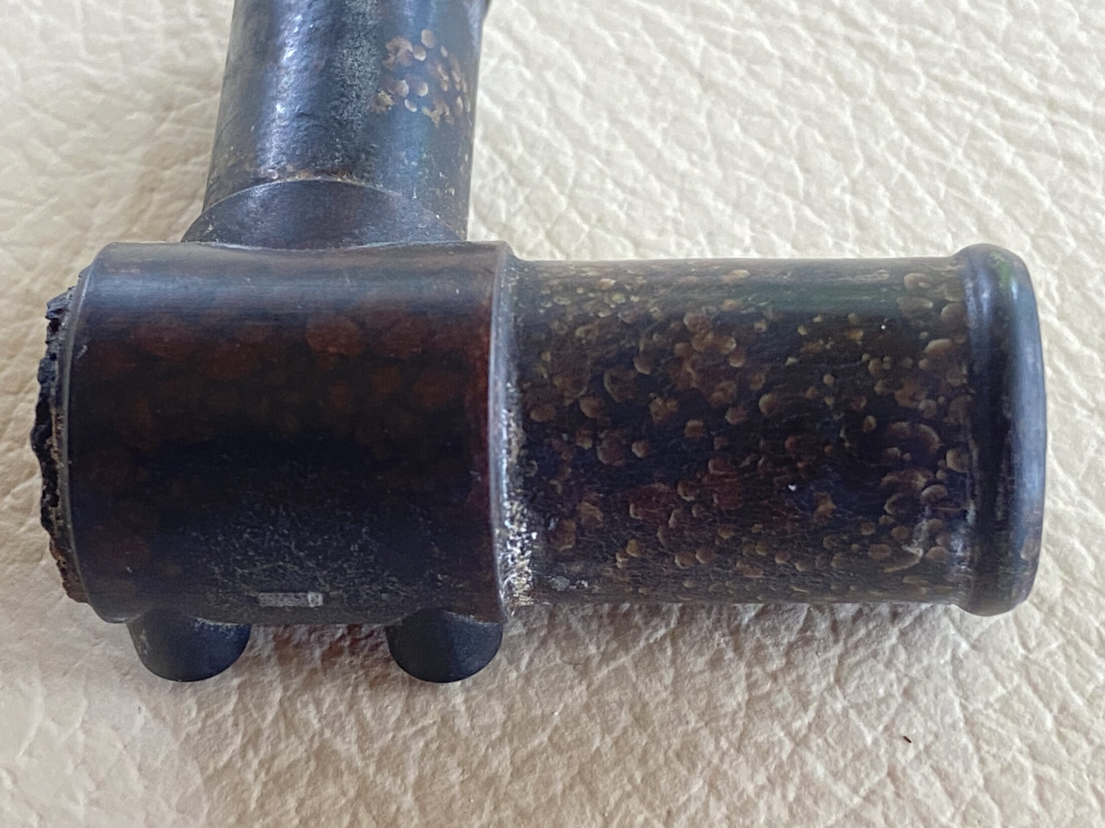

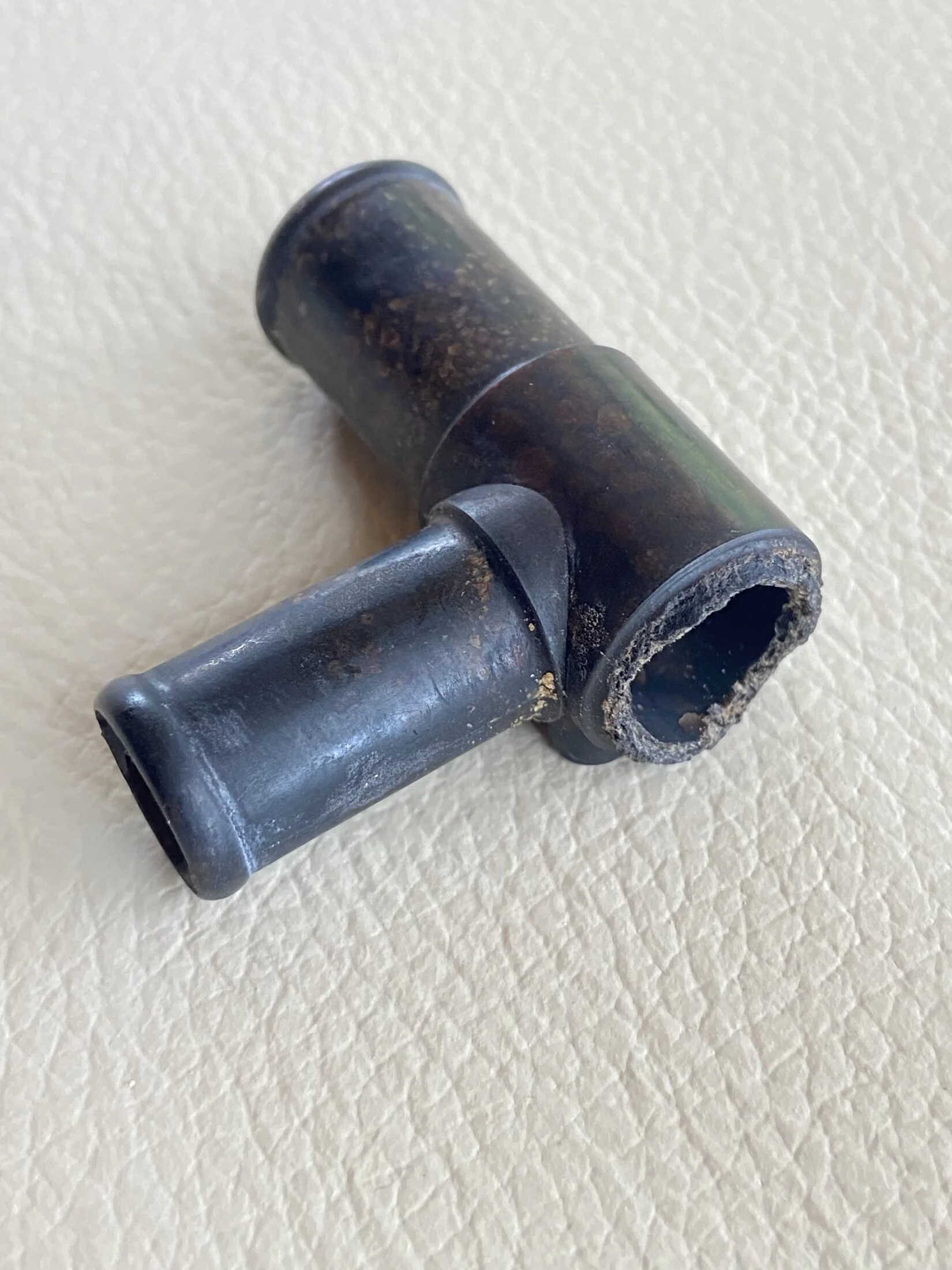

Been said a thousand times here, just sharing that I recently got religion too.
26 years old, ~142k miles. Looked “normal” upon initial inspection, no leaks. Snapped like a stale Triscuit as soon as I started twisting the hose a little. Not a gradual fail that you’d see or smell, but a sudden gusher if it had been pressurized. You can’t really visualize how the plastic is failing until you remove the hose and see the brown splotches.

2) Don’t buy the aftermarket tees. Just. Don’t. They’re all garbage. And using brass tees from Home Depot or whatever is a dead end. The perpendicular tube is smaller than the other two, and does not match US plumbing fittings.
OEM tees are engineered for a hot environment, vibrating, constantly soaked in coolant. It’s worth the ~$25 for a pair from Uncle T.

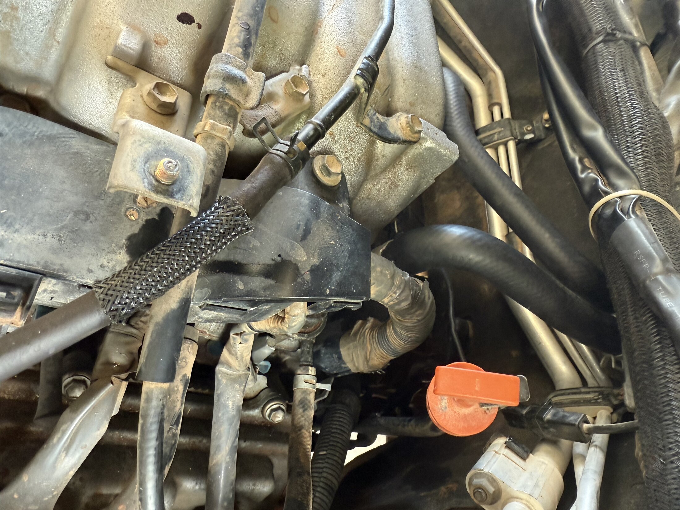

the new lines were cut by the foot from AutoZone (5/8" ID) and boiled to shape with rubber bands
