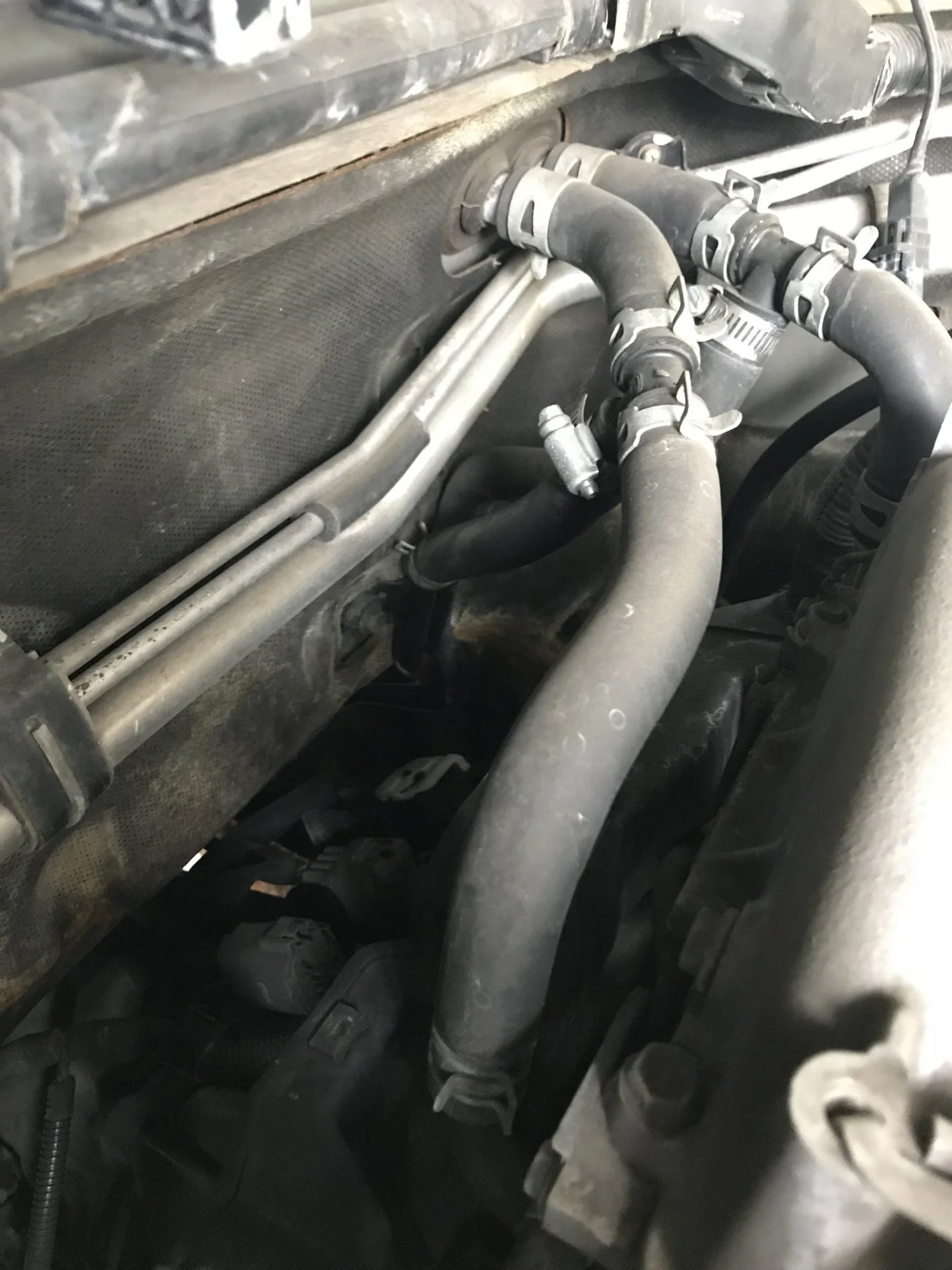

I had Steve at RPM in Monrovia look at my heater T's a few weeks ago. He thought they looked OK. It's possible they were replaced by the PO as the clamps on the vertical hoses are not OEM.
I decided to replace T's, hoses and clamps. I used the Four Seasons T's and silicon hoses from HPS.
Before.

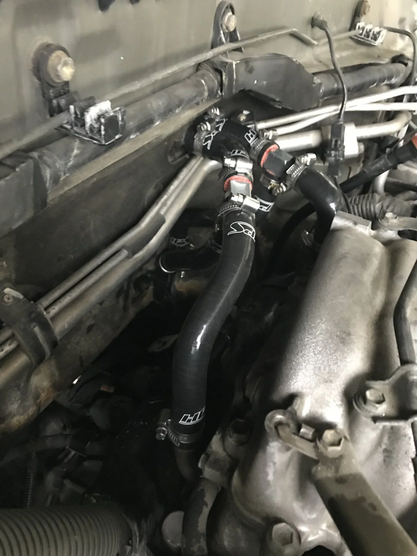

I razor-bladed the old hoses off and then assembled the new sets.
Here's what they look like installed.
View attachment 1565802 View attachment 1565803

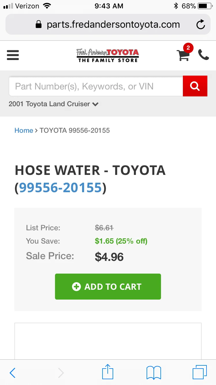

These are the part numbers from earlier in the thread that still show up in the online parts store I use. Fred Anderson Toyota, Raleigh NC. I bought these numbers and the install was straight forward.
(1) Coolant hose - PN# 87245-6A220
(1) Coolant hose - PN# 87245-6A210
(1) Coolant hose - PN# 87245-6A190
(1) Coolant hose - PN# 87245-6A180
(1) Coolant hose - PN# 87245-6A800
(1) Coolant hose - PN# 99556-20155
Hose Water - Toyota (99556-20155) | fat.parts

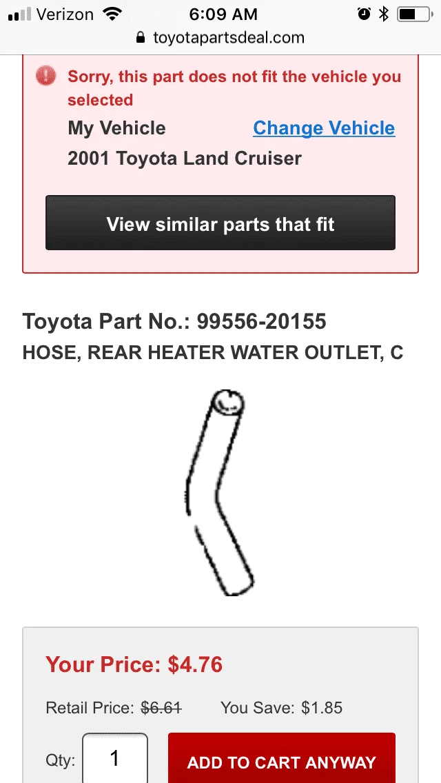

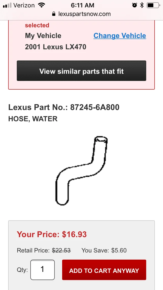

The last two part numbers show they don’t fit on both the Lexus and Toyota parts website and it shows me two that do with different part numbers. Damn don’t want to order them now and get the wrong ones.
I’m not sure if there are any difference between the LX and the Land Cruiser. You can go back a few pages in this thread and find pictures of the hose/tee assemblies on a workbench. You can compare the picture to your truck to see if everything looks the same. The tees are the same, so the hose diameters are the same between the trucks. The horizontal legs are one size and the vertical legs are slightly smaller. I wish I could give you a definitive answer.
I typed in the part number ending in 6a800 and it shows it to fit 03-07.
I’m so confused.

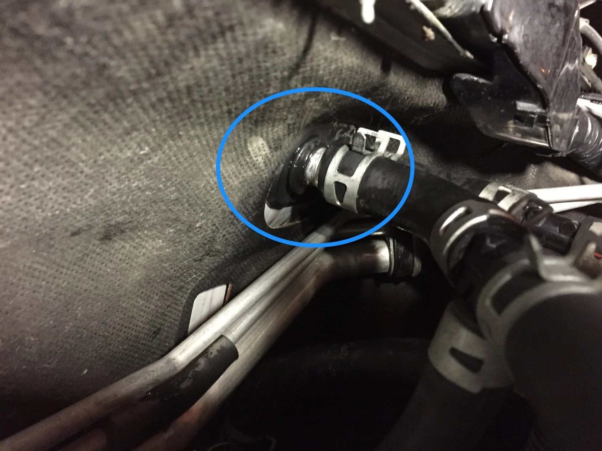

Just replaced my T's and hoses (all with OEM), went to fire up the vehicle and i have a bad leak coming from PS firewall inlet. I've double checked the hose, tried a different clamp and indexed the position of the clamp on the hose but it is still leaking...bad. Anyone have a similar issue? Any suggestions on what to try next?
You may have distorted the aluminum pipe when you remove the original hose, especially if you used pliers on it to twist the stuck hose off.
I'd remove the clamp and hose and inspect the pipe. Or you could try your luck with a full cooling system and attempt to squeeze the clamp lightly to try and 'tweak' the pipe round and reseat.
