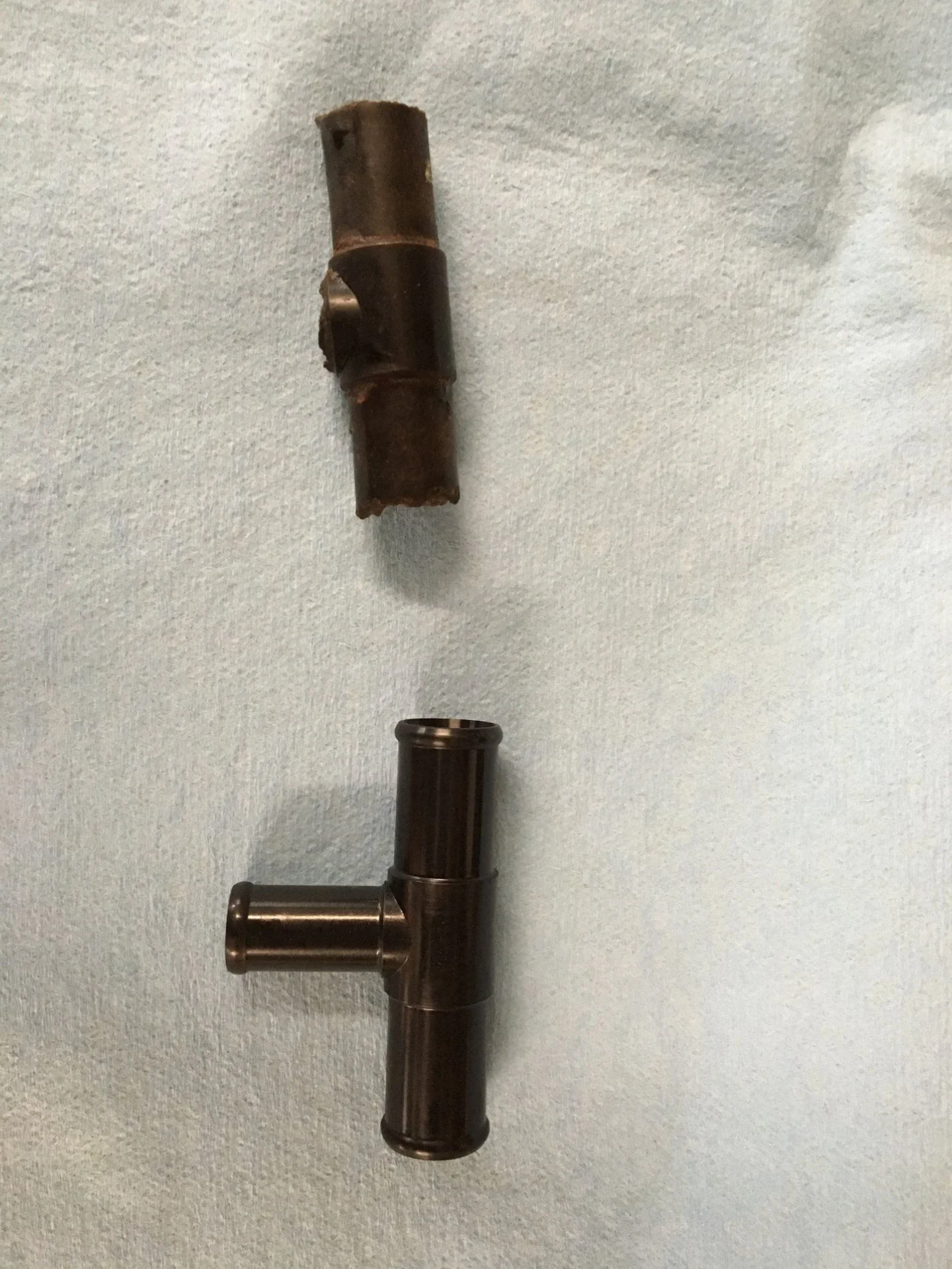

I did this job the other day, however as I was replacing the first one, a small piece of the end on one of the T's broke, and I'm not sure if it went down another pipe. I tipped out as much fluid as I can to "wash it out" If it happened to have gotten in my system, 1- what's the worst that could happen, and 2- what should/could I do to remedy before the worst happens. It's been a couple of days and nothing seems out of the ordinary

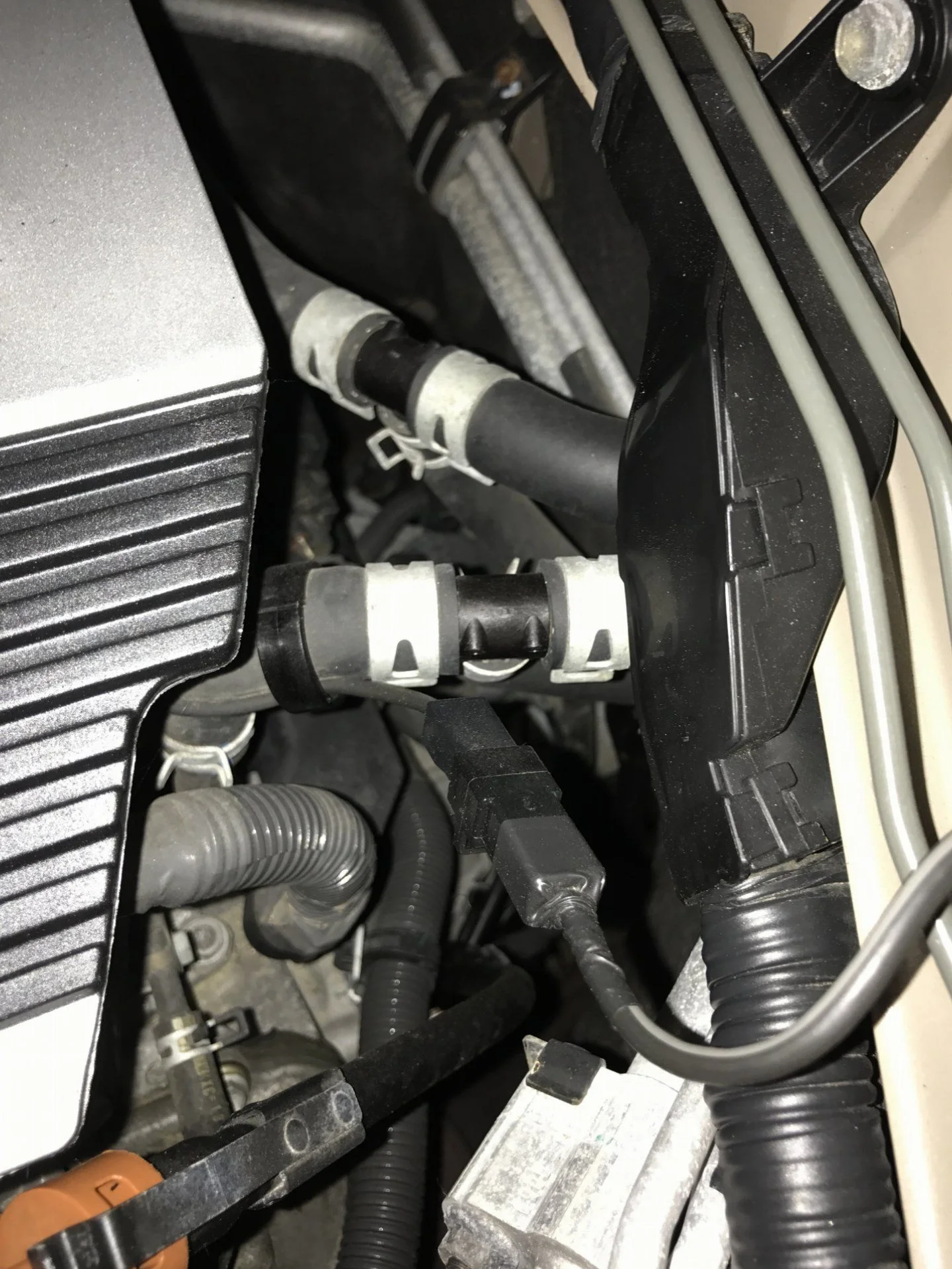

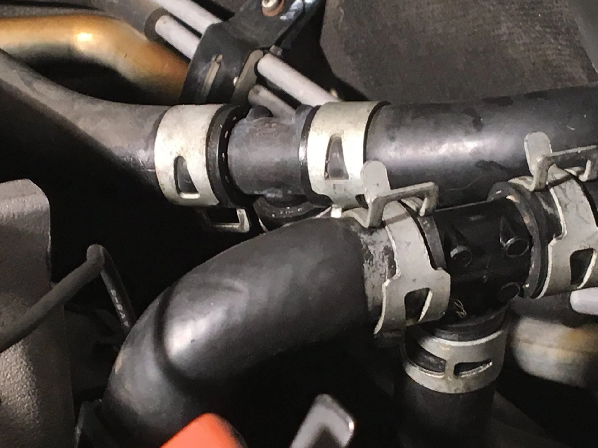

img_5119-jpg.1428444
img_5120-jpg.1428445
What is the extra clamps for?
Left the originals there just in case of a future emergency. If the worm clamps let go or something I have backups right where I need them.

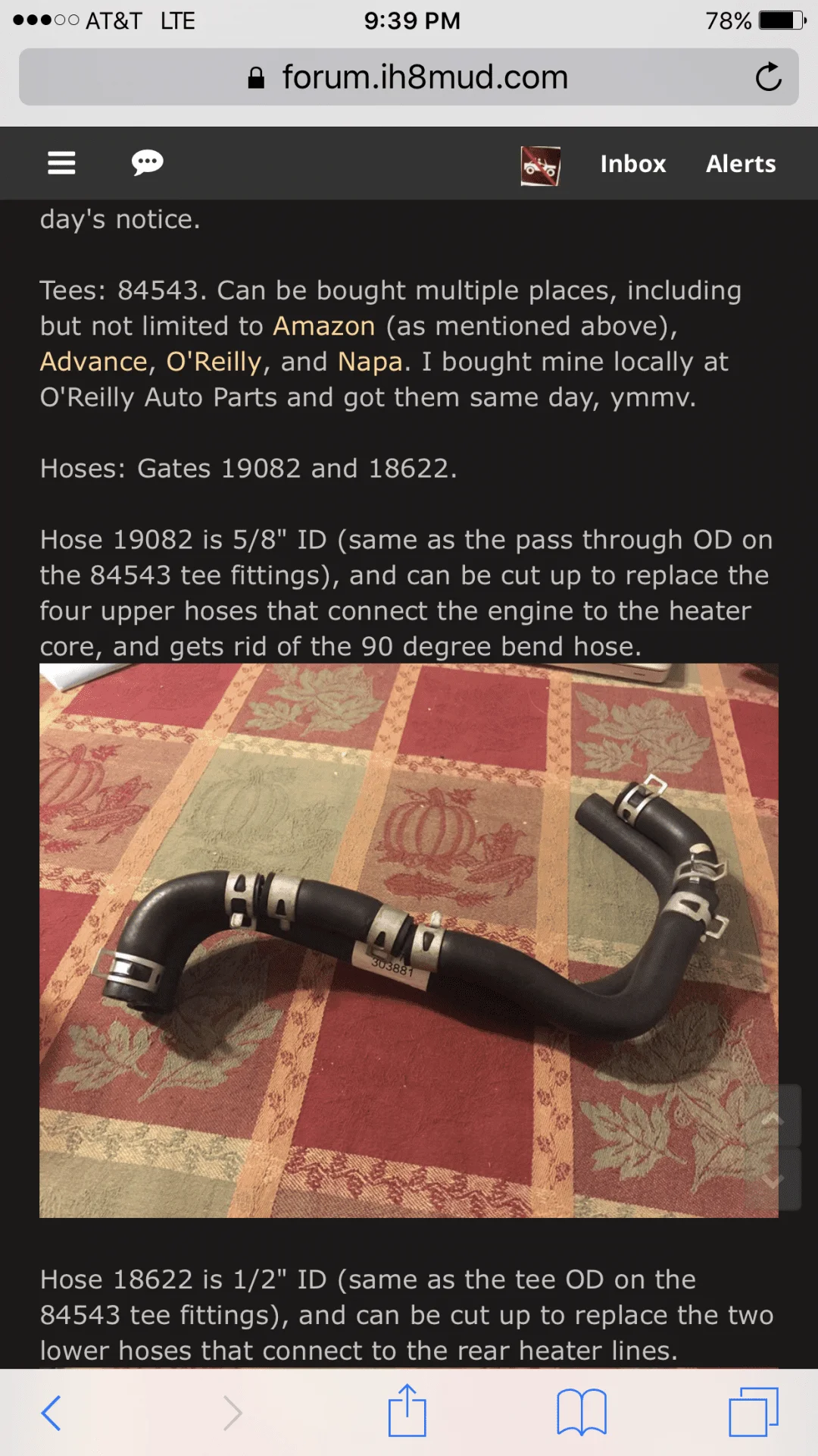

Id go with the stainless steel T's from 4 seasons. I paid $11 each for them.

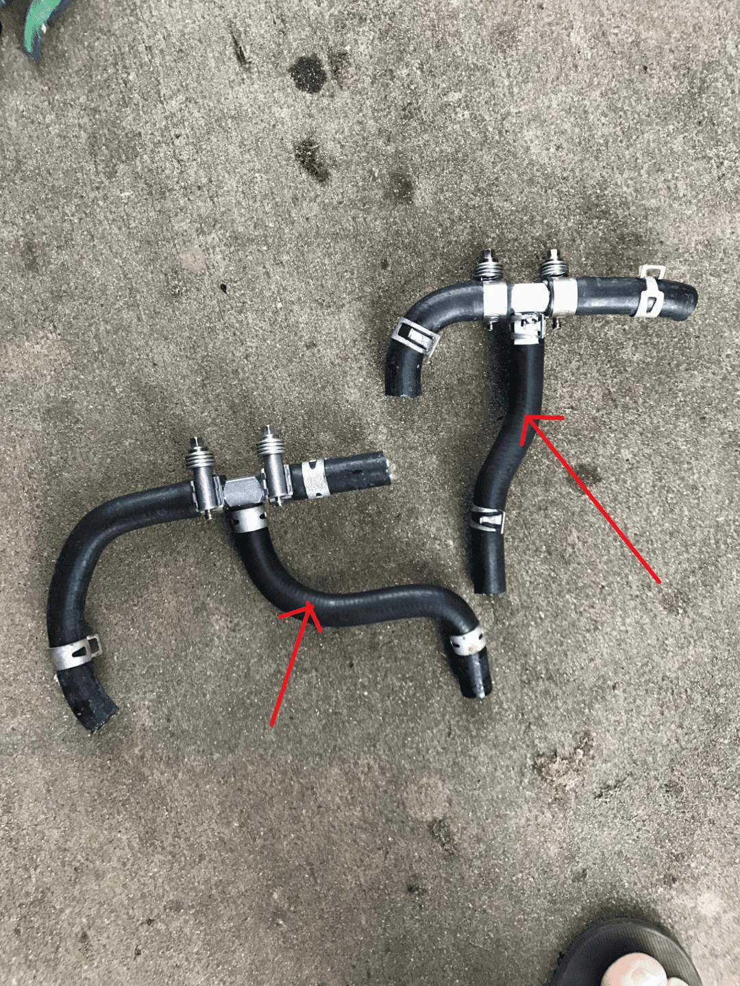

'04 w/ 101k. Replaced mine w/ 4seasons T's and Gates hoses a few days ago. DS had some cracking on one end:
0q7_i00XA-kkJEIazekNvApylcEItpB3iSmLlQZQa6O-JreU0OzsmzN-MLHWpaBKGagvH2q8_ooS7E9ySMkW-dSc7PSJZAEs6BqJyMd_x-pXXzzVXoJ3sLaPz6P4JJDKaueX-6pGM9dgKgh9gj83yCcmR71V7RnKZmvYCdyu5mWnJWcVQUyEHP51laKOtE7ZIcUh5190N58NkSG0Rm6Ph2y8lFpv0q_HaCbUBddRsO-C8q3ankoS9NaVx-nLbYuxdDU7tUUBtKRM3BfnCVDvwxxQqqbWp87vN8NF1KZHQb3W6Voqs9jdriU08a-h2pR33Srsof0Rn0N0Nd5Xo1U9O_DLkDAExD0gUf55lXP7tNnM6H2FBDm2kX-ekAuRhcffB42Z5FCsd2kMsuSLyRMRFOb4o5GlDnf_FkrSYKsPqOl-WB-nB-LxIKqKqctsMeBXLtBZcgW92YTcMzA94e8VZdzI-wJMC5qG2nXLoMN_jiGjfHCSoUhkOY8DH9pASey1SI3V-o-6vALVVUDhPdl4s8FKOgnsMOPazBMMvXQQ5-4JyUZmahNuoWguBva0jJG4pJkPnVDFwpgV7yFv1x4NBnwqgdPwvnMNHQXpB5uwDFhDx4GOaxun=w1920-h946-no
Trimmed and kept as spares, didn't look too bad overall. Hoses would have been good for another 90k, figured I might as well replace while in there.

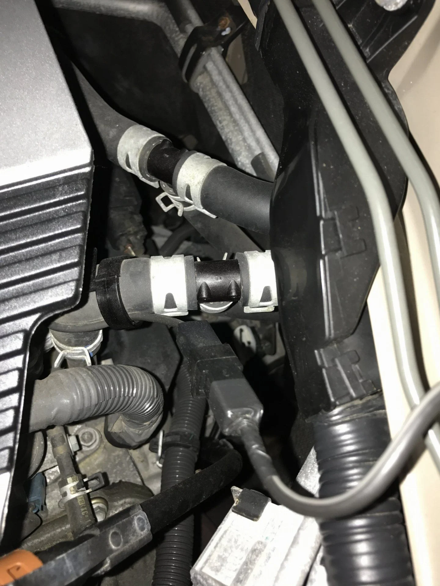

My 2001 LX470 is still at the stereo shop. So I was only able to take a picture of mine but, they look to be in good shape.
Unless y'all see something?

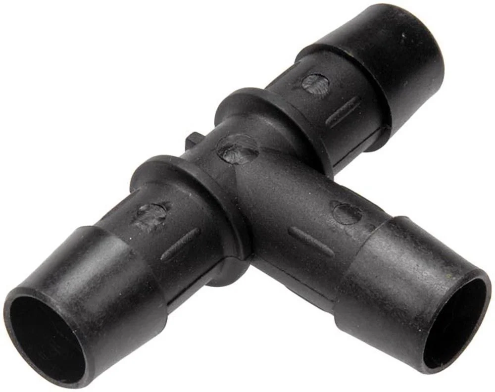

I got the Shark Bite brass Tees 3/4 x 3/4 x 1/2. They were way too small. I went with the $4 Dorman plastic 5/8 x 5/8 x 5/8 from Oreillys. It fit better. I guess due to the angled ends. It actually didn't look any smaller than the 3/4 brass. ????

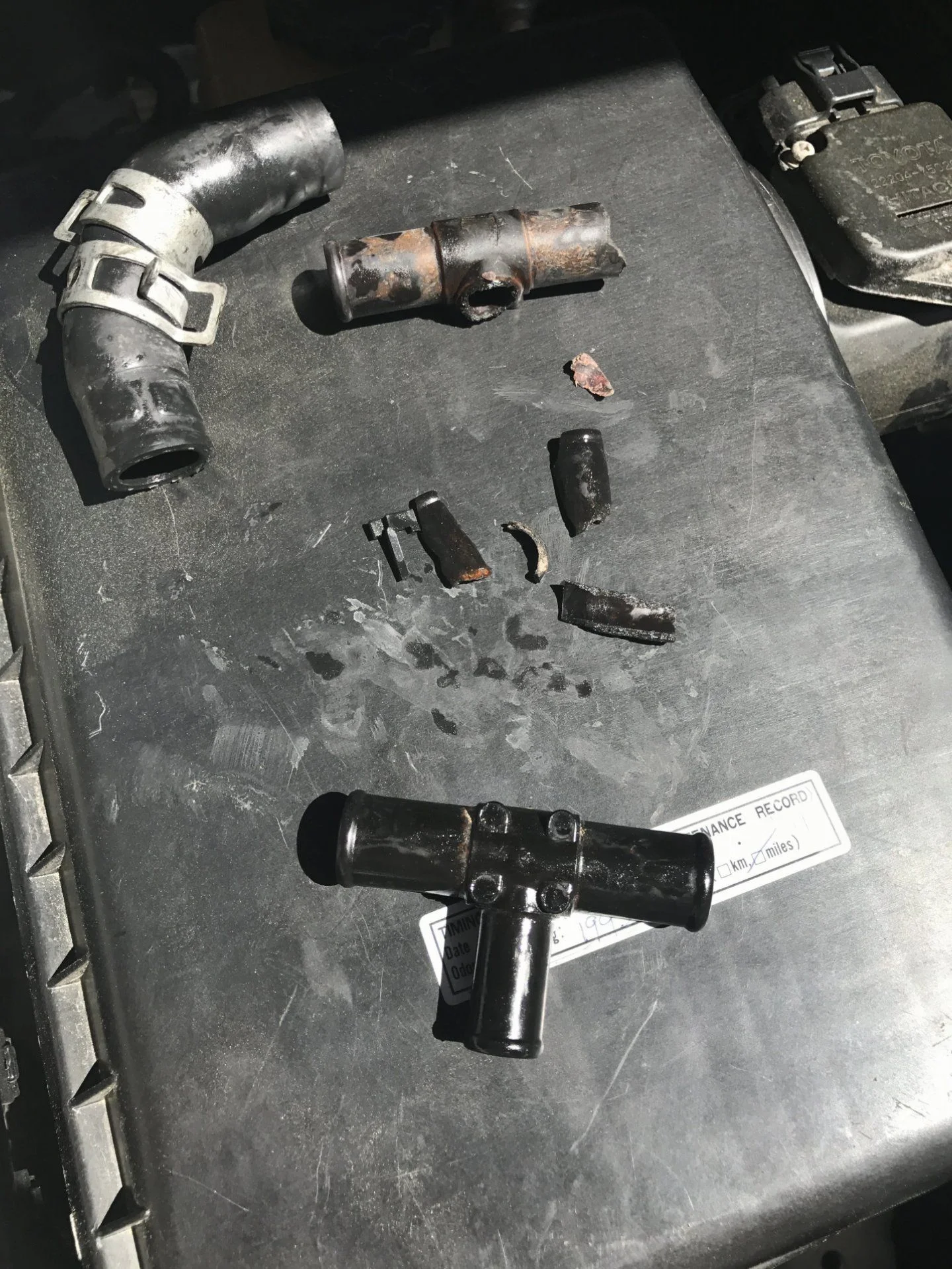

I changed one out today....I just lost my patience trying to get the one closest to the center of the LC. The outer one was in visually awful shape anyway and the other looks ok.
The one I changed crumbled as soon as I put any pressure on it. I left the clamps facing up for next time. Still need to do the other one but since it looks ok I will leave it for now.
So thanks to this post. I avoided catastrophic failure of my LC100. I originally replaced my radiator. Last weekend while replacing my spark plugs , I noticed one of these T's weeping. Ordered New T's from Toyota and replaced them this morning. The first T just crumbled when I tried removing the first clamp. This was a chore because both T's fell apart. I dug out the remaining plastic with a screw driver. Oh and I replaced the radiator for good measure. I think one good pot hole or bump could of split that T in half on the road. Who know what would of happened. Enjoy!

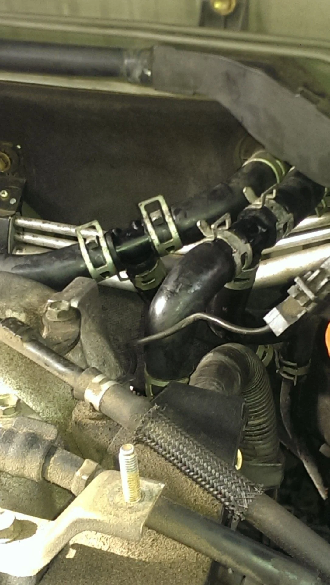

Here are what my T's looked like after 162,xxx miles:
njh4xJ2Wgpgj4y73qROIOikWrh_aBStJ25Dn6ruPxin3-POwgnoZeoQzKaAb8BFGwe00hGUB2H2nnUuwFqdlNLET25wzUzfTumc5RCrP9LY6R4DXSaDINnoQPIYJwTvW7owWWtHk6LpplPbWVq4Oyr8djwJF0ixURpDIx1kUqEVUs48wACLFVIuxEgX8mJd9YmjnJ0YPFFqpaUNIn5z1MdzBipRfr_f5bynuukng-BZ5a2PqGTakE9kpVKV_jzZTYHziUee3CeGm_fW-ptfZp9oLgSgRn3ruPBqa_ZfFGj2kJhBKY1KWA8O-hkJAWPfzuaZpVE_pbtTfEFS1sQWgzu83mk-P7W7fBVgLyMgbTkFgyQ8knvcxS9ohFuyscvjrRmNOikgaKee1fajG4EY6xWWgs-0guq8bw6-FVGj2m6j9AXXqq-kxc8ppz6lD8kTiZNjLv508rcEbjFiaNwlrLW06SwClEoZbXzBrlRK5AypBnfrgEpfZKqtDcBNxxMtaRpVS3IEB4fIuz_AvhzeK_W9m1ZX6Vb_Xh79OFUkWT5vMRuQuSn459ka6fyUADvWpr_NzM9xVpxdVmUR524Z5craz5RSC38wMGnt6M1iQbUafvXR08QL0vmpGvi2TYK-TyXvY129wGtIFTEYLeJLmVBUyVsxoLB3VV9IAxdOrQ2EpQXG0elfmQ-raYs0OBOIFeloxbkEc3cDEk1r9ErUq7kxYvA=s0-l75-ft-l75-ft
I couldn't break either T with my hand, but as you can see the ring broke off on one end of each T during removal. I didn't notice until installing the new T's, but these rings had become embedded in the hose preventing the new T's from going all the way in. I used a small flathead to pry the pieces out of the hoses, careful not to let them fall down the hose.
