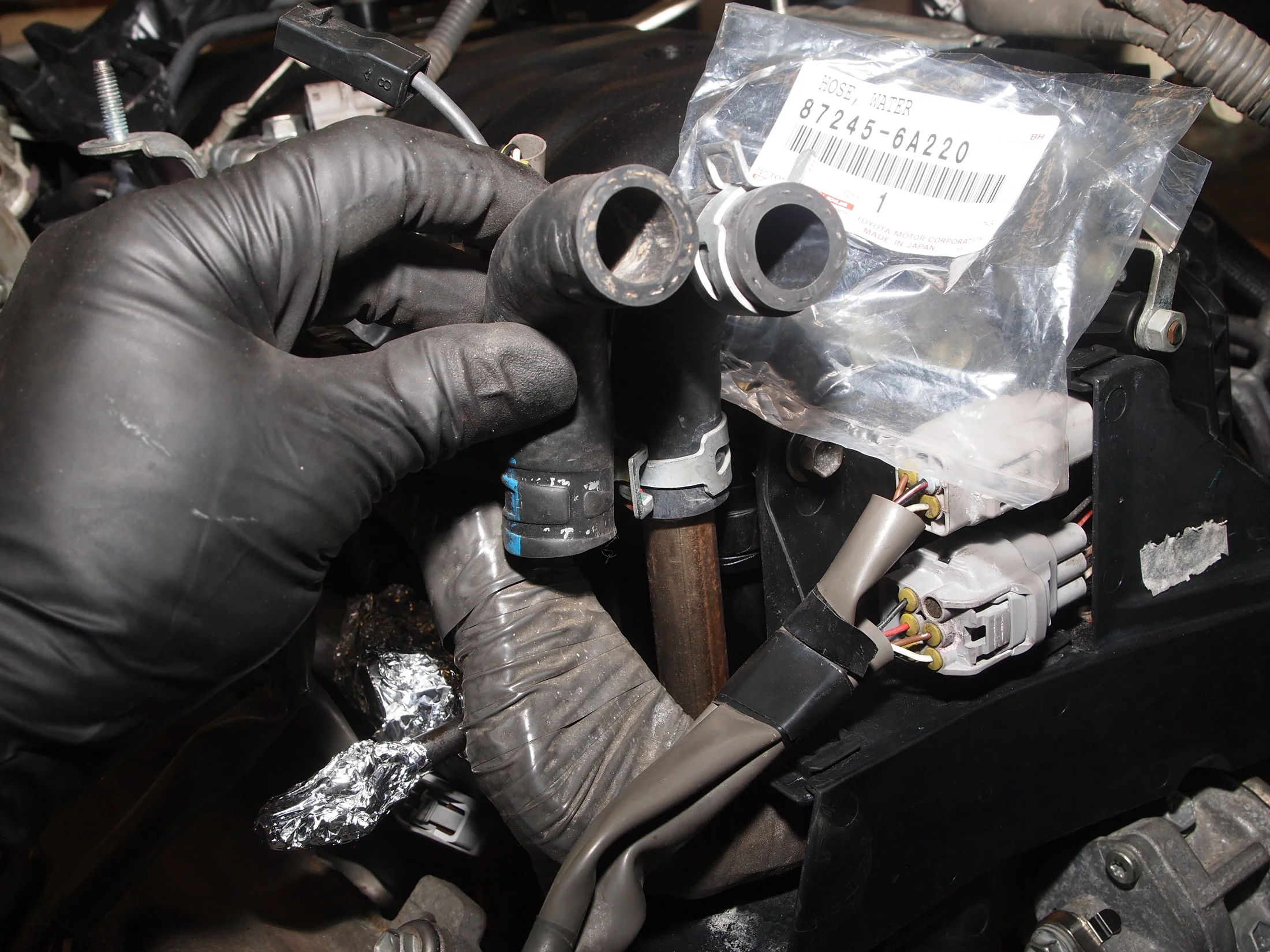

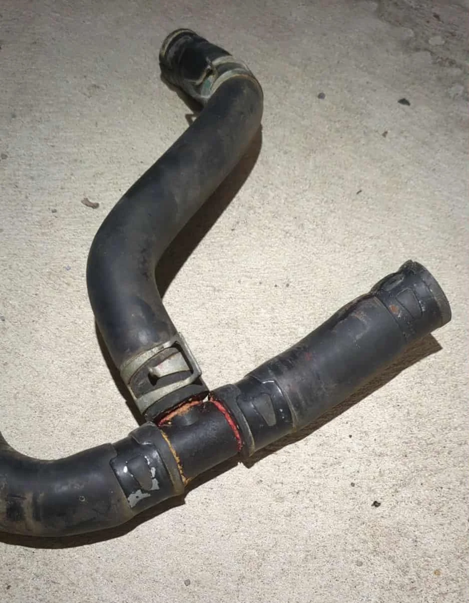

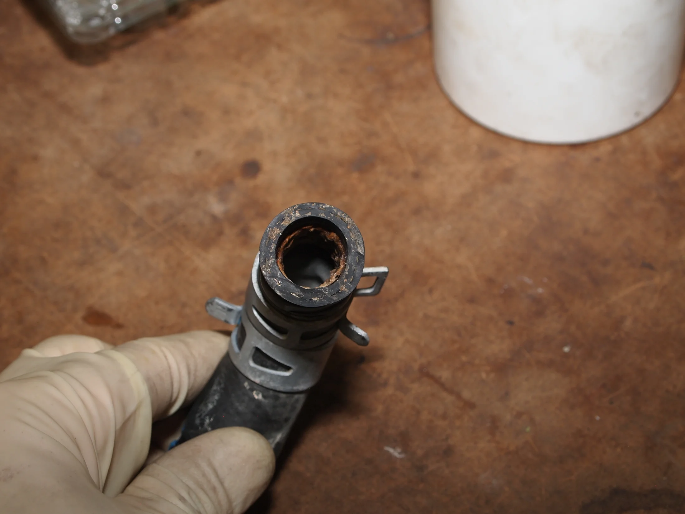

Personally, I only replace the first hose in most cases. The hot (driver side) 90 elbow hose. Unless heater hoses, are swollen. Swollen, as seen near clamps (puffy look down stream side of clamp) indicates overheating, which is hard on the rubber hose. Those hoses, are trash. The typical hose in well care for engine, are fine. Even at 25 year and 400K mile, that I've seen.
I replace the 90 degree elbow, because. Removing plastic Tee from engine side of hose, they'll often crumble. Which result in plastic dropping into engine side 7 out of 10 times. I can blow out heater cores, but not the engine side. So plastic ends up, in coolant system. Sometime behind thermostat, which I can get to. But sometimes, gets into oil cooler. Which I can't get to, without removing oil cooler (PITA).
When removing that 90 degree hose, I cut it off. Using a hook razor blade. I'm very careful, to not score the metal pipe coming up from engine (rear water bypass), as I cut the hose off it. I'm just as careful, to not put any lateral pressure on that pipe. That pipe is pressed into rear water bypass. Too much side to side pressure on pipe. The fitting where pipe pressed in, will leak. Then, rear water bypass, must be R&R.

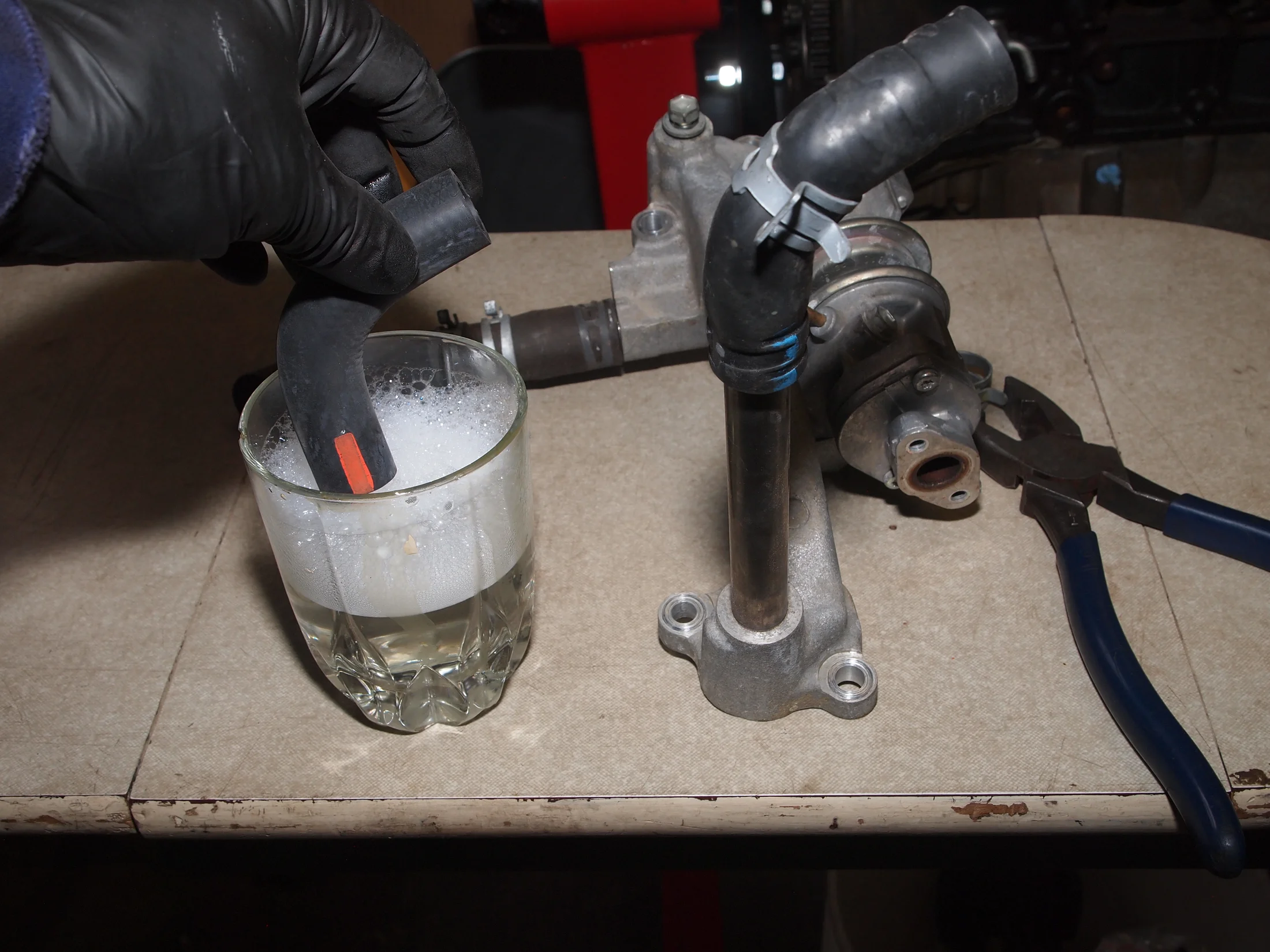

Toyota recommends soapy (dish soap) water ( I use Dawn). Which, helps slip hoses on. It also aids in, rubber hose light attaching (fusing) to metal pipe.

Place clamps, back into the impression they made on old hose and same orientation. Which is a Toyota how recommends Which helps, reduce chance of leaks.
With new hoses we place clamps in any ortation we like.

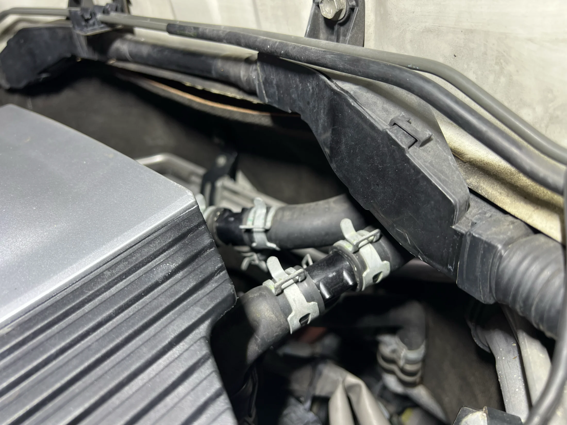

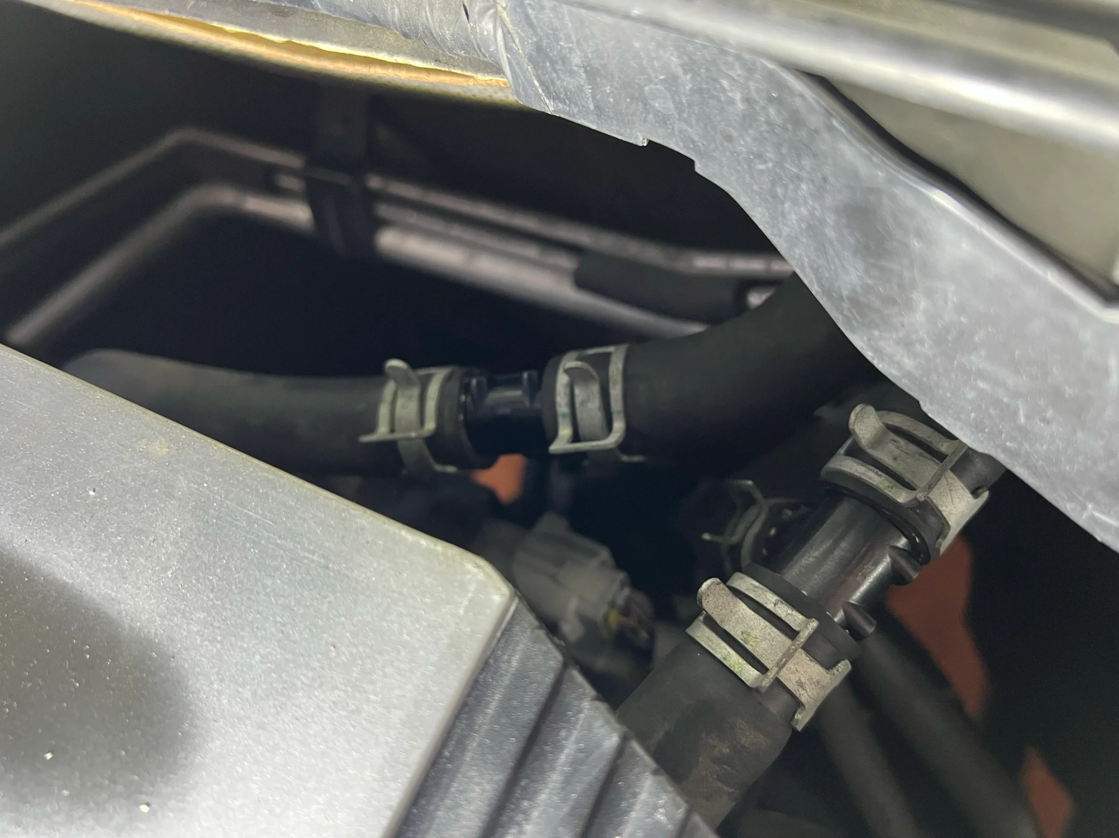

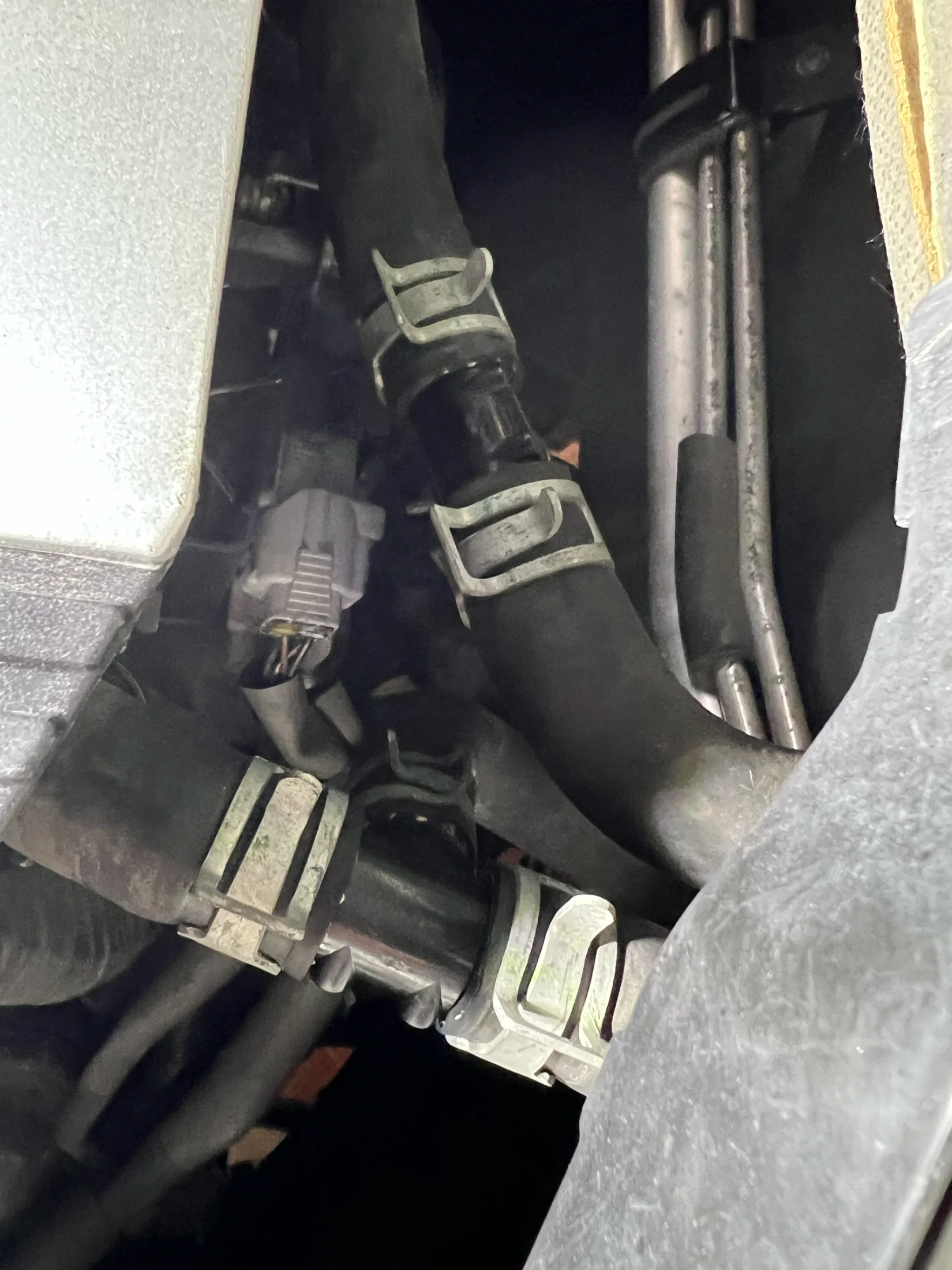

Checked my Ts and it looks like one of the previous owners already replaced them. Here are some photos. Maybe someone can chime in?
I mean at the expense of $30 and a half hour you’ll know they are good for another 90kmiles. I don’t think external visual is the best indicator of remaining life and I wouldn’t pull apart the hoses without have a spare set of tees on hand. 8724860460
Likely, they've been changed at least once because the original orientation of the clamps is 180 degrees of what you have it at. 😉
That was my initial thought as well. I t seems like the second previous was an enthusiast and took care of the truck.

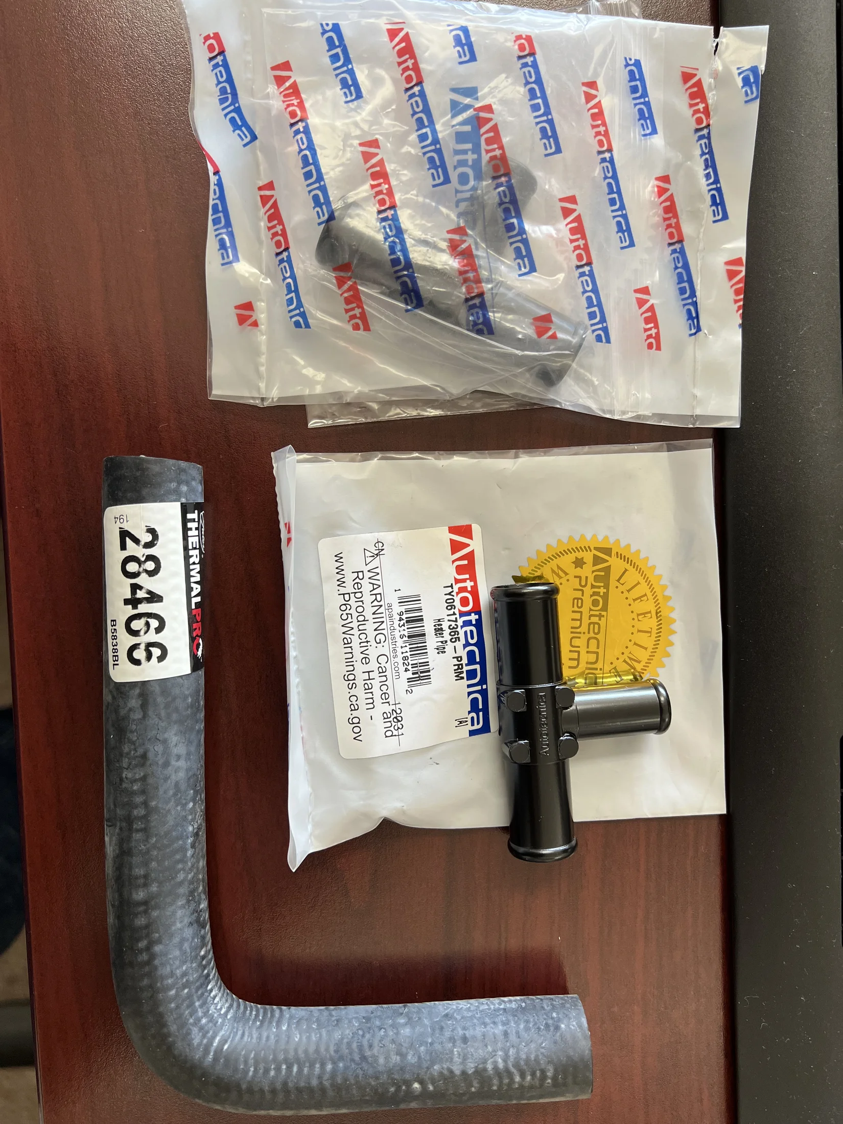

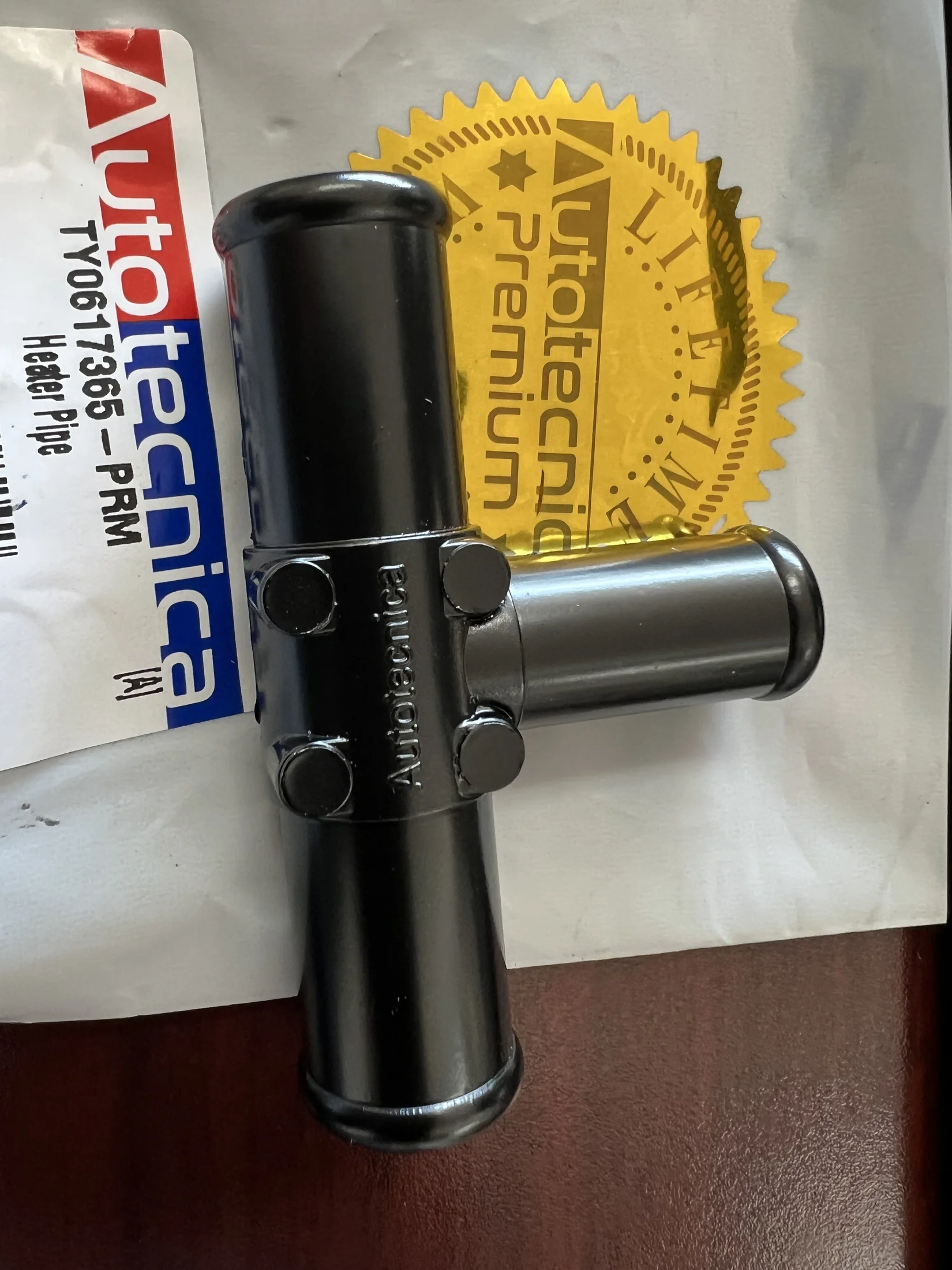

Received my Ts and hose from RockAuto. Ts are made by Autotecnica from very high quality and sturdy plastic. They also comes with the Lifetime warranty. Hose will need to be cut to size but feels really good too. Will throw them in glove compartment for now just in case.

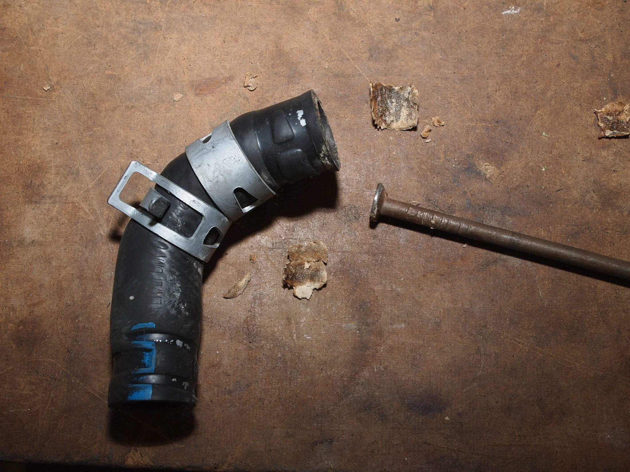

Just replaced my heater Ts and I'm glad I did because it didn't take much force to snap the base off one of the Ts; I did have to slice the hoses to the firewall but the others just twisted off.
