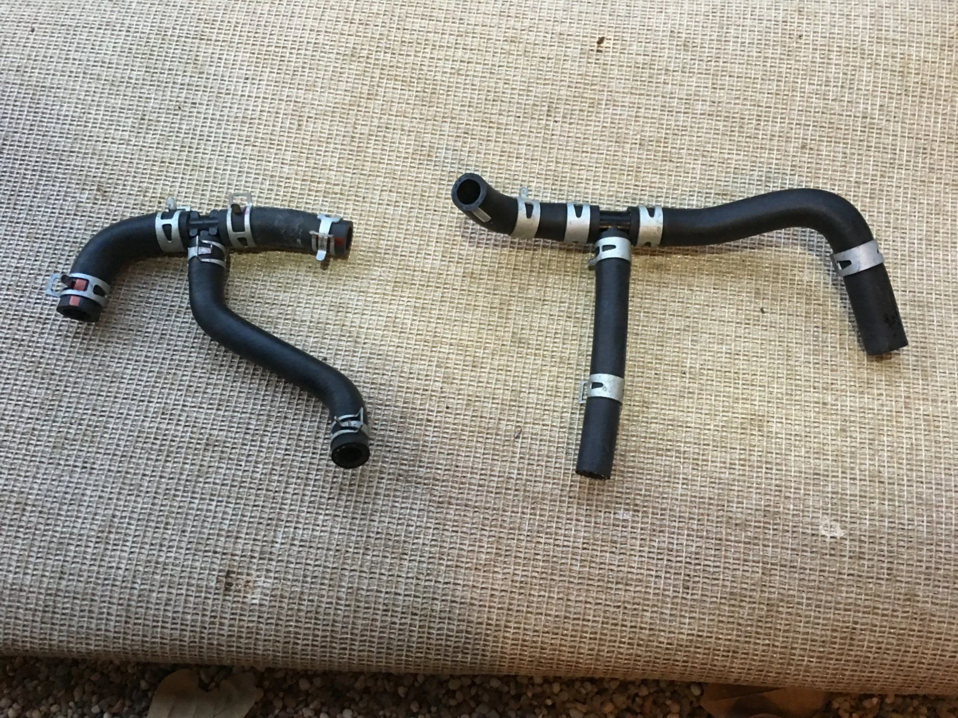

As i removed them i mocked up the new hoses and t's. This is on my 2006 and the one on the left is drivers side. Tomorrow im gonna try to get them installed.

Pre-assemble the T and hoses in your work bench, then all you need is just install.

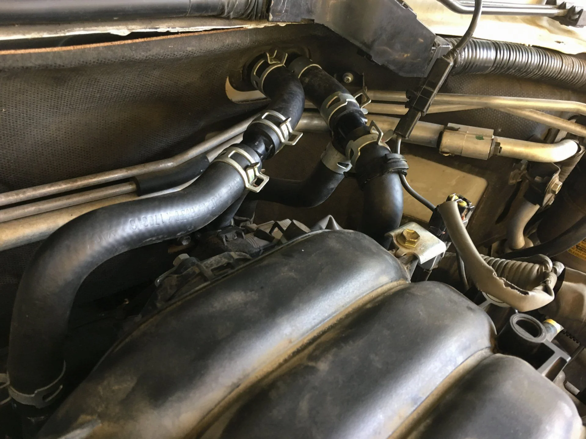

Got the new hoses and t's installed on the 2006. You can feel the flared end of the hose pipe under the rubber hose and tell where to position the hose clamps but you need a method of precisely placing the clamps. I finally just laid on the top of the engine to get my hands back there which was okay since it hasnt been started in a week.

i just did this the other day...literally took me 20 minutes to do. used a small step stool and draped a towel over the driver side fender and leaned over (had to remove plastic engine cover). but then took another 15 minutes adjusting the clamps so to stop any drips. not hard at all with some small channel lock pliers to rotate the clamps for better access.
