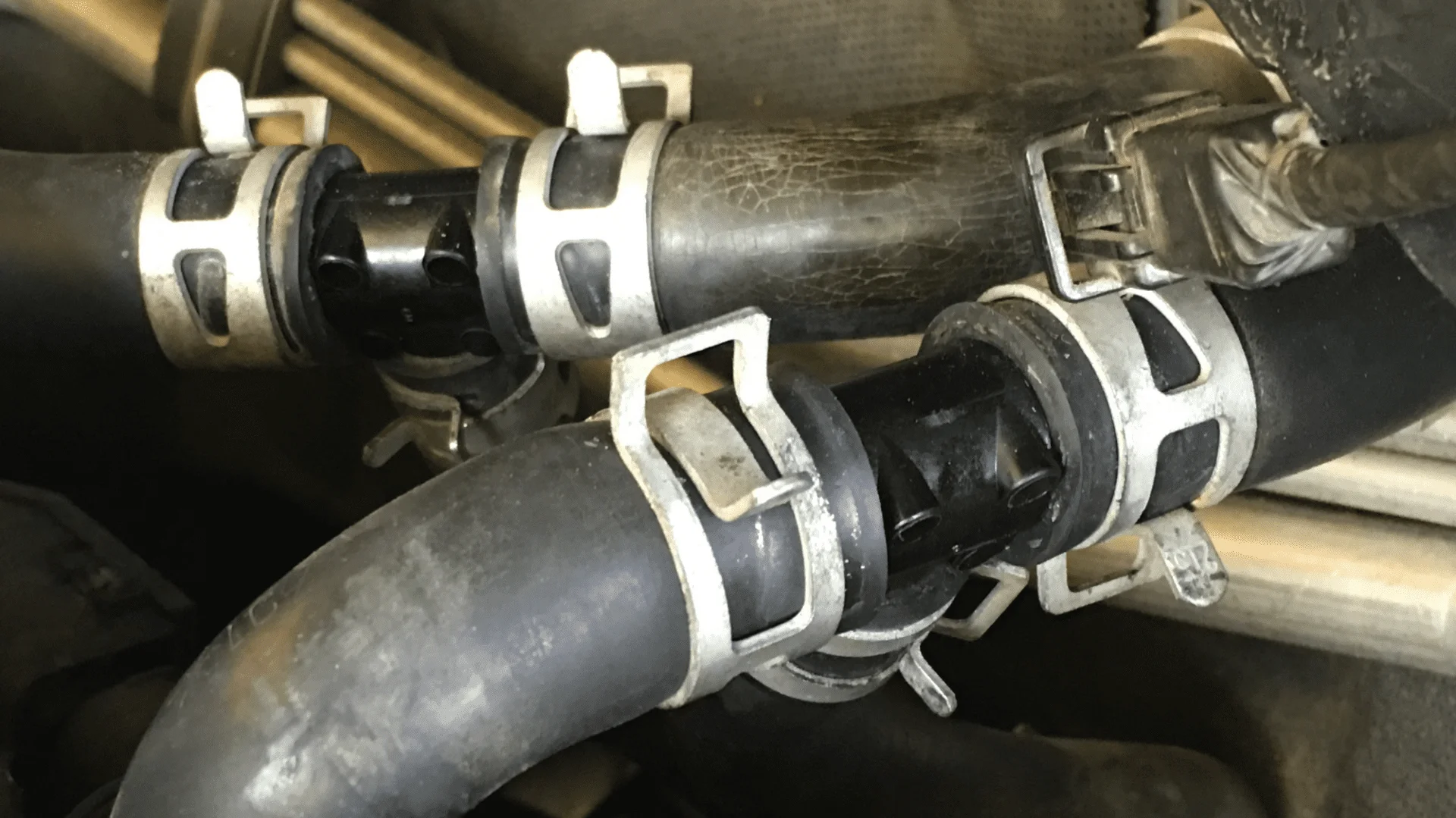

after removing the big plastic cover I put a couple layers of old blankets over the engine and climbed up/layed on top (it was quite comfortable!). not sure why but the clamp ends were all positioned in their worst-case-scenario orientations (so unlike Toyota...) I used large curved-end needle-nose pliers like the kind shown below, they really helped to access & rotate the hose clamp ends so they could be fully compressed & slid down each hose, that made it super easy with no fussing.. i used a small flat blade screwdriver & gently separated the hose ends from the barbed T ends, after which they came out with practically no effort. despite ~225K both pipe T's showed very little deterioration and didn't crack. also very little - like maybe 3-4 oz. of coolant was lost. I used brass replacements with full-length barbs, they took a little persuasion to fully seat, then the curved pliers to re-position the clamps. no leaks.

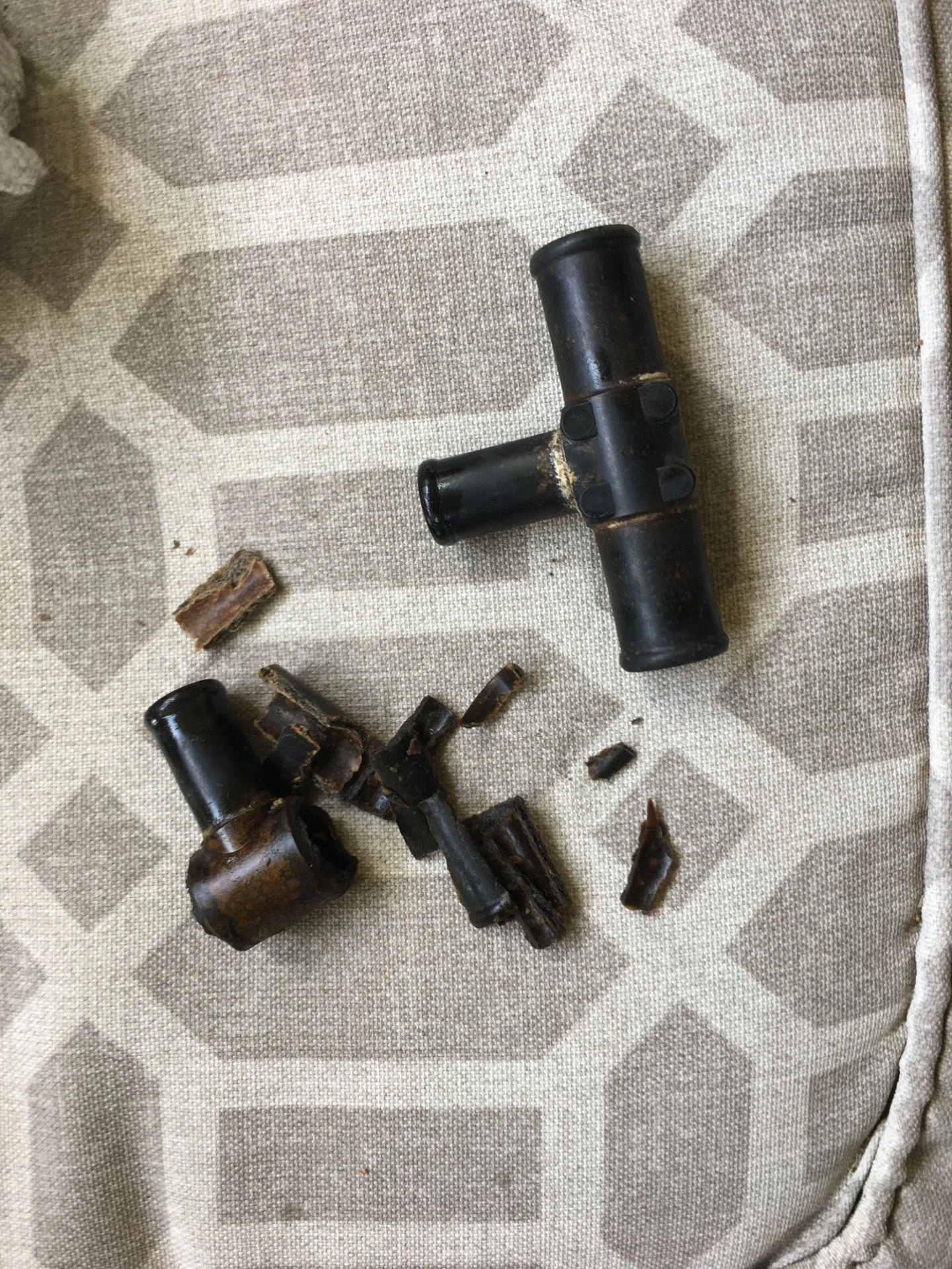

So, on our 06 with 182k my drivers side T started seeping so I ordered all new hoses and T's. Upon removing the drivers side T it crumbled in my hands. I plan on replacing it every 100k from here on out.

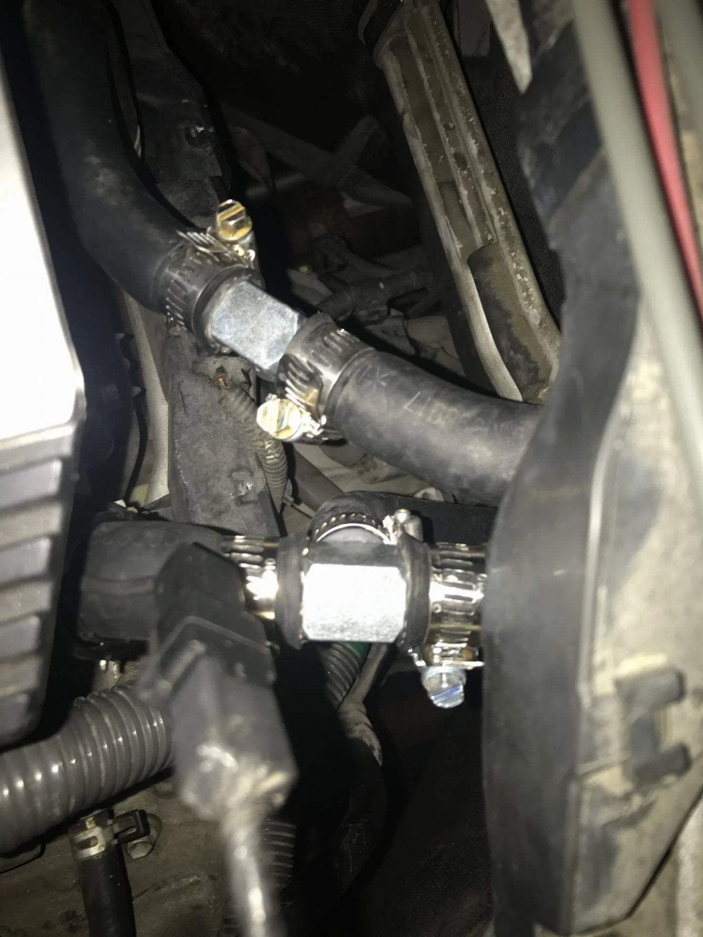

I then installed stainless Ts and clamped them down with new hose clamps.

I used hose clamp pliers and it was a pita but its done. My t on the driver side crumbled but i was able to use a coat hanger and get the pieces out. Glad its over and i positioned the hose clamps where they will be easier to engage when i find some hoses. Speaking of replacing hoses, that was my goal but the first hose i tried to remove would not come free (driver side hose that attaches to the firewall) and i cussed and gave up.
