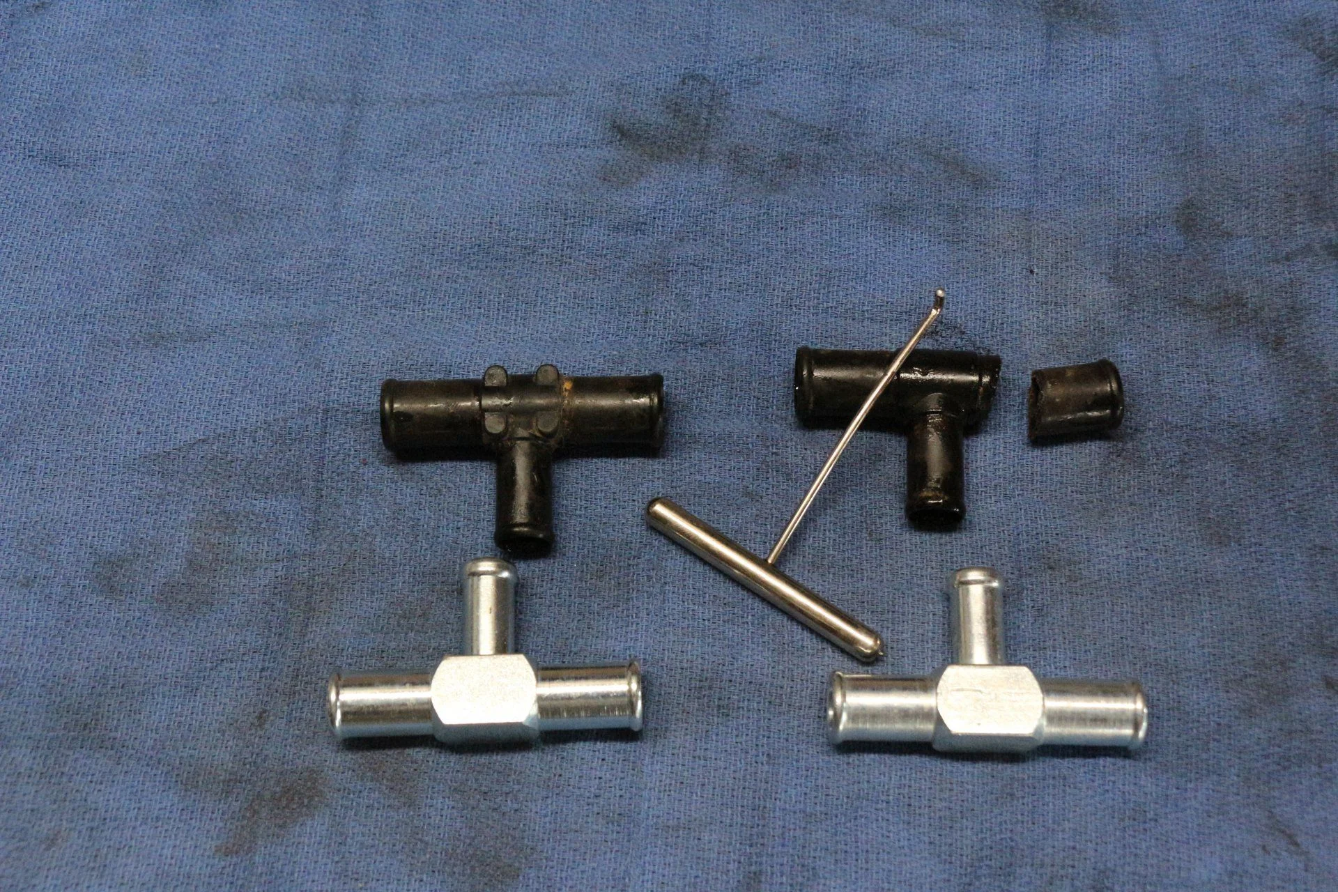

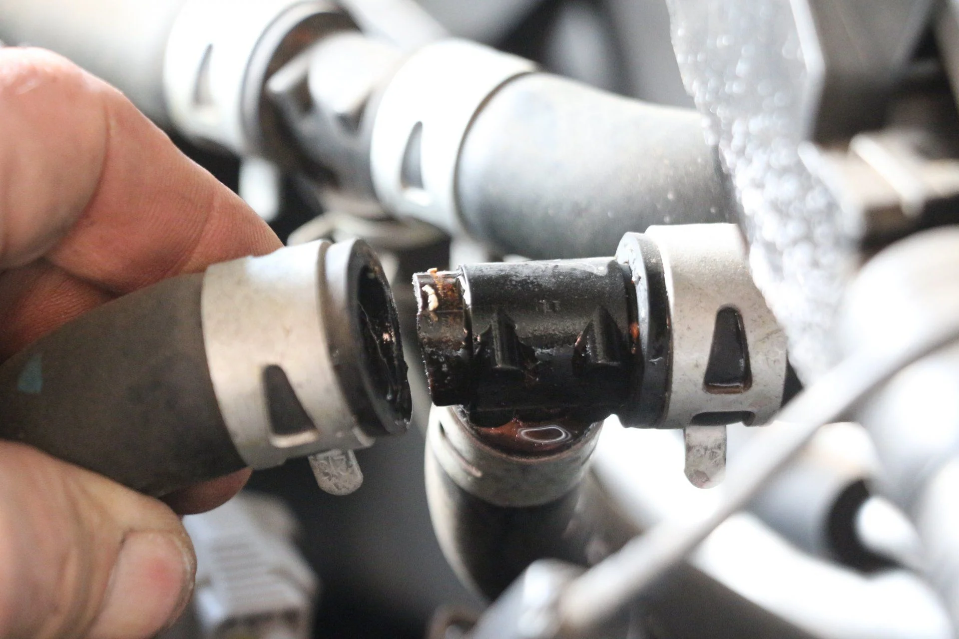

My heater T broke when I lowered my drivetrain when I was converting my t-case to part-time.
I was happy when I realized I have the correct one time replacement 4Season T's (part #84543) on the shelf. The 4Season T's have 2 - 5/8" and 1 1/2" nipples being SAE and not metric the factory clamps will not seal on used hose so I used the correct sized Breeze clamps.
I did make a tool for removing the broken piece on the fly that worked great.
I have now put an end to heater T's failures forever.

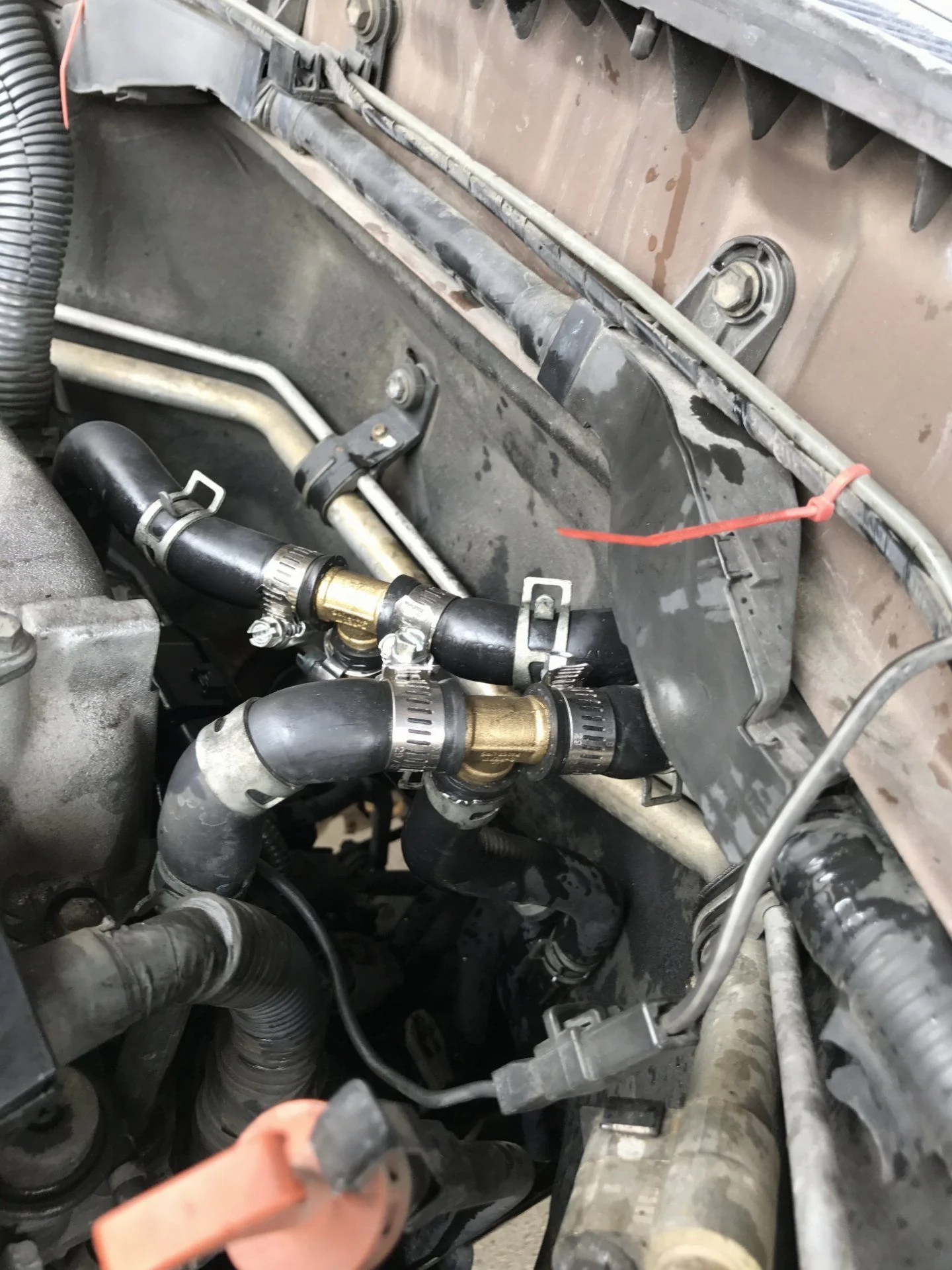

2001LC, 109k, swapped oem T's to brass. Bought worm clamps but thought better of it and used the constant torque oem clamps. Repositioned clamps just in case I ever need to adjust.
Quick 30 minute job, but what a pain in the arse! I'm 5' 10" and had all the right tools for the job, but I had to put my right knee on the battery and left knee on the intake manifold to get in the perfect position to move some of the clamps. Glad I never have to do it ever again. Original T's actually looked to be in pretty good shape. It looks like the PO used oem red coolant changed regularly and the truck had been garaged in SoCal all of it's life, so I'm thinking good preventative maintenance and fewer extreme temperature fluctuations helps to extend the life of the T's.

12mm hose on a 5/8 barbed brass fitting?
I'm not necessarily endorsing those specific brass T's for anyone else... I recommend thorough research and to choose the approach that works best for you. Someone else described the 5/8" brass T's earlier in the thread and there was also a discussion about the discrepancy in sizing for one of the hoses, so I won't re-hash everything here. Like others have mentioned previously, one of the hoses is snug but it does slide on. Personally, I think it is a good idea to inspect the hoses and connections at each 90k service regardless if you have metal or plastic T's. My hoses were also in great shape, but FWIW I plan on inspecting and possibly replacing all of my hoses when I get to the next service.

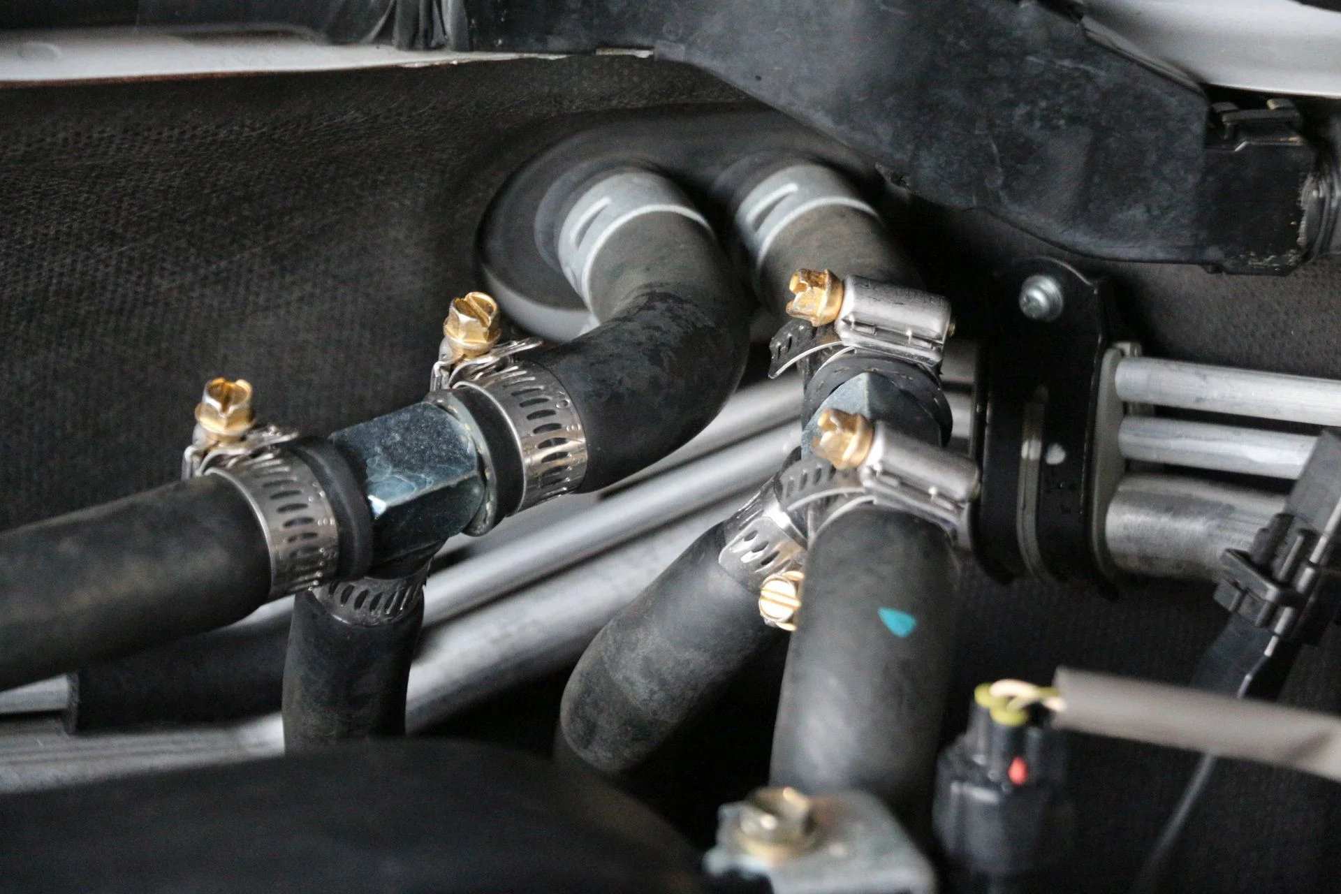

This is the constant torque/tension clamp I am talking about. The OE clamp is also a CT design. The one pictured go for about $5-6/ea though. Here is some additional info...
"Virtually all rubber hose compresses "cold flow" after installation of a clamping device, resulting in an almost immediate torque loss that can exceed 80% of installation torque. Similarly, virtually all metal connections expand as a system heats up, and then contracts as the system cools. Conventional worm-gear, T-Bolt, and other clamps are passive, in that expansion and contraction of components cannot be compensated for without retightening or loosening the clamps. This Breeze clamping system is an "active" clamp mechanism, which monitors and then compensates for the temperature changes by actually changing diameter through a unique worm-gear Belleville assembly."
http://www.breezeclamps.com/ct.htm

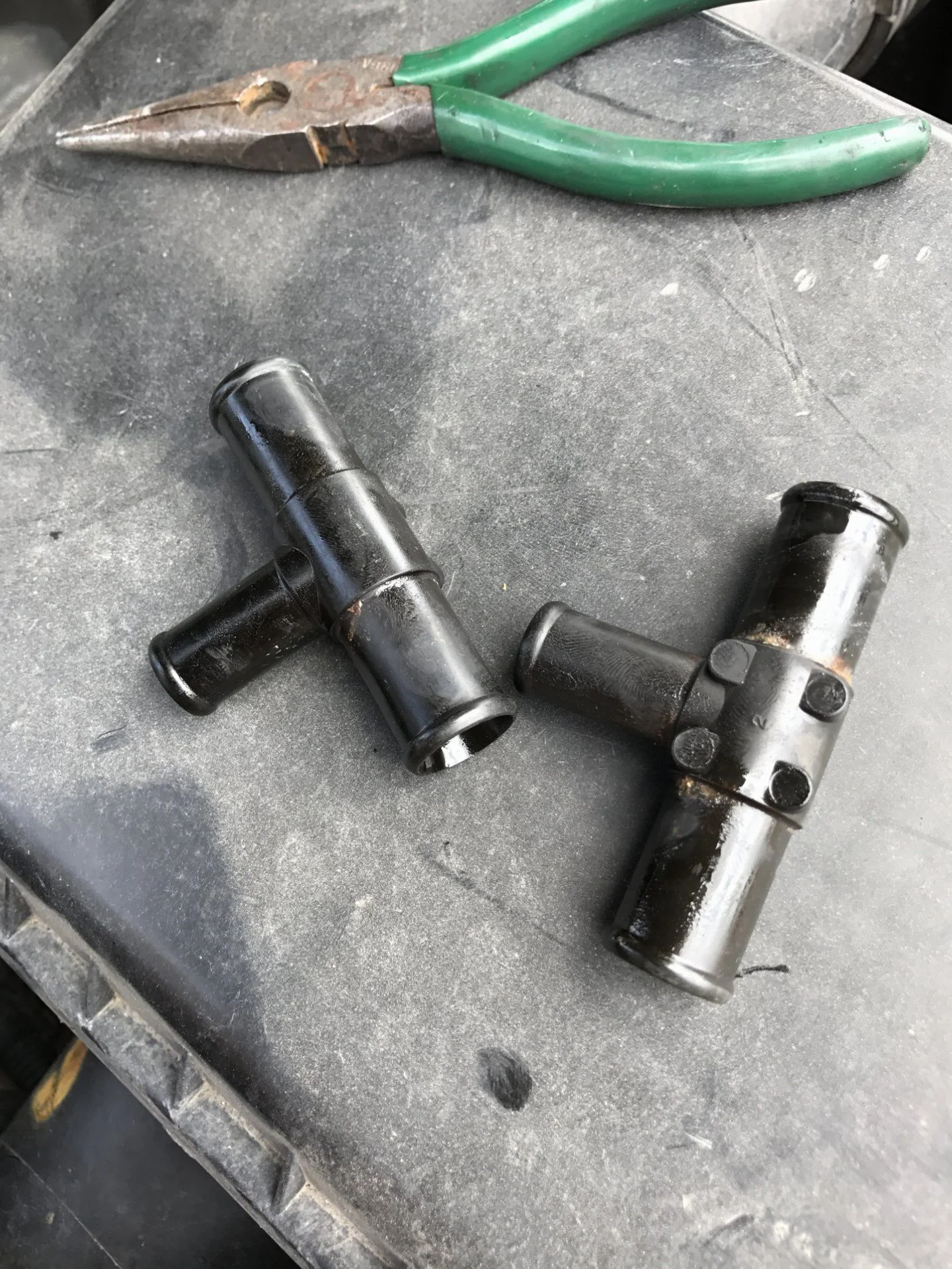

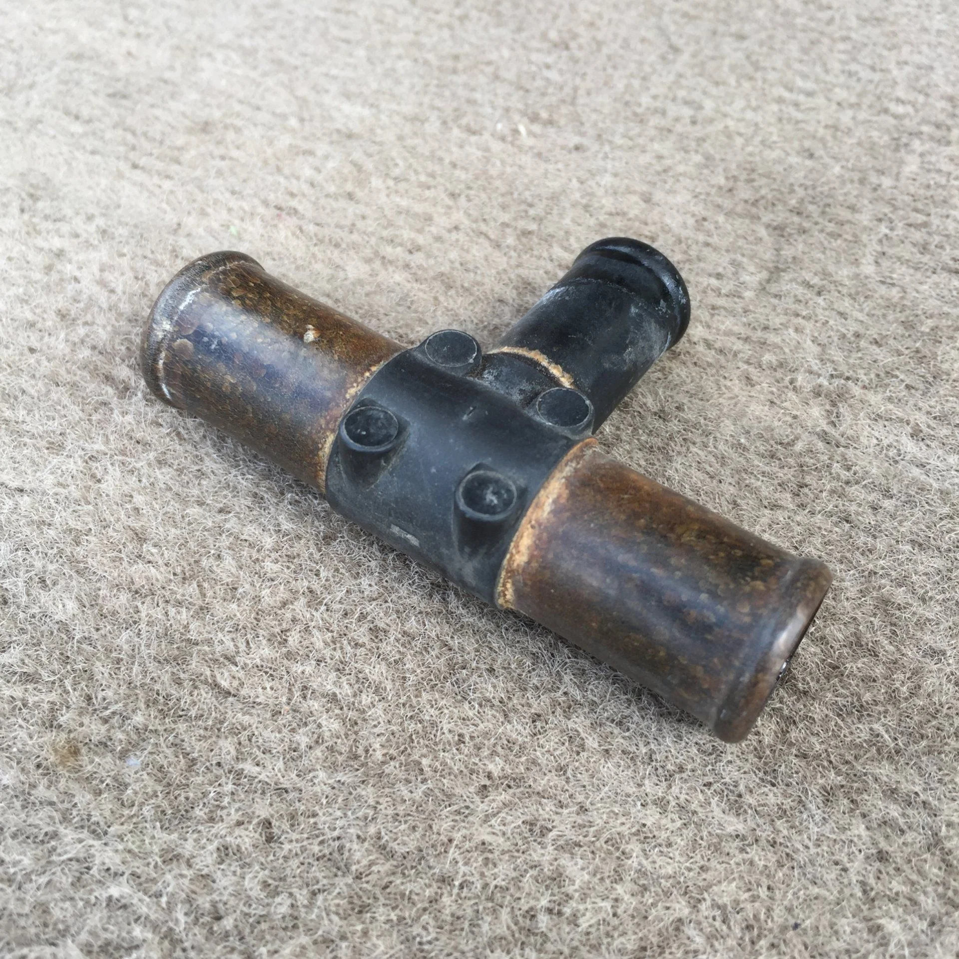

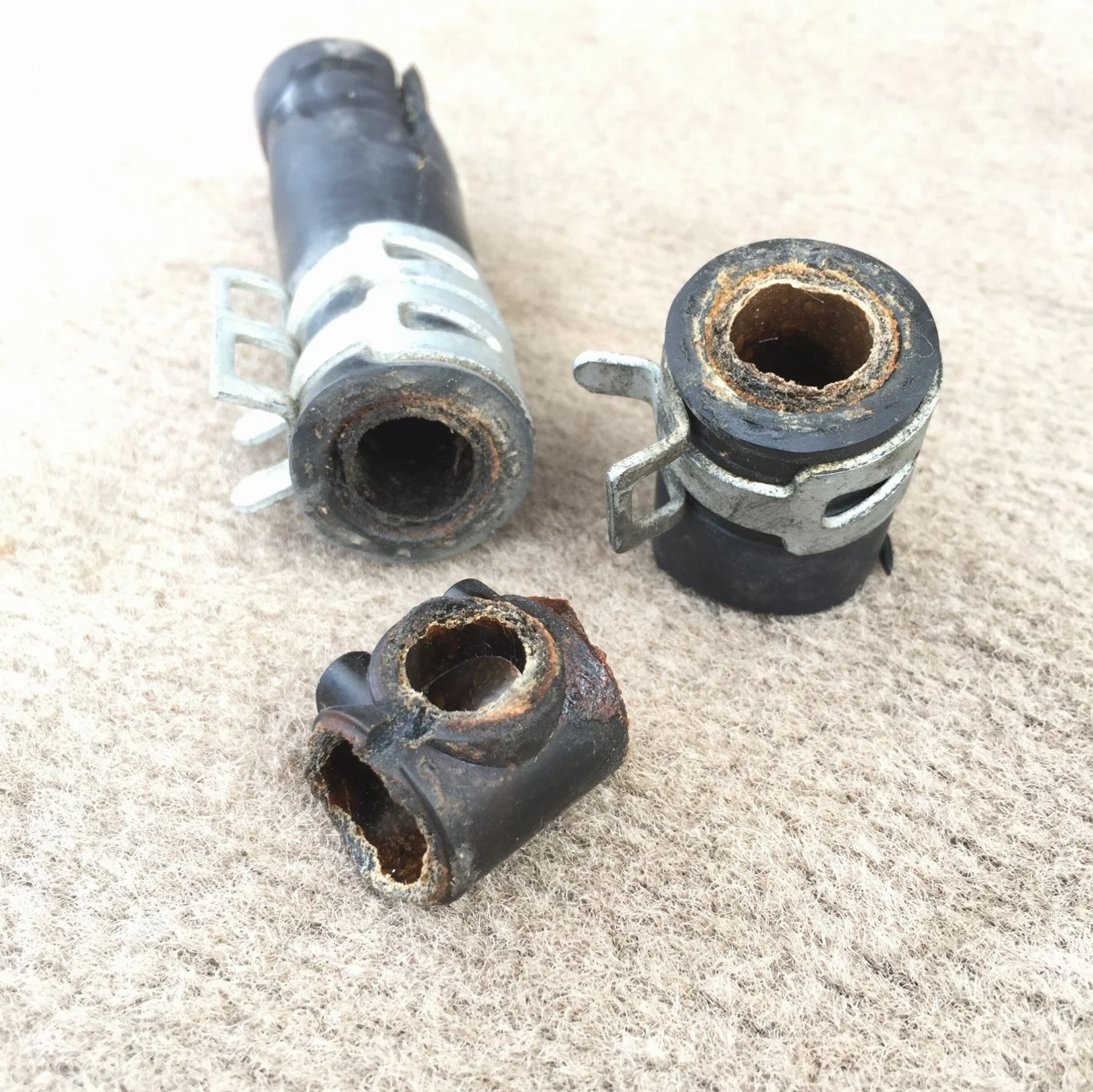

From what I can tell from my '98's service records the heater T's were original. So here's what Southern Oregon T's look like with 280k miles on them. One was seeping and easily broke apart during disassembly. The other wasn't much better:

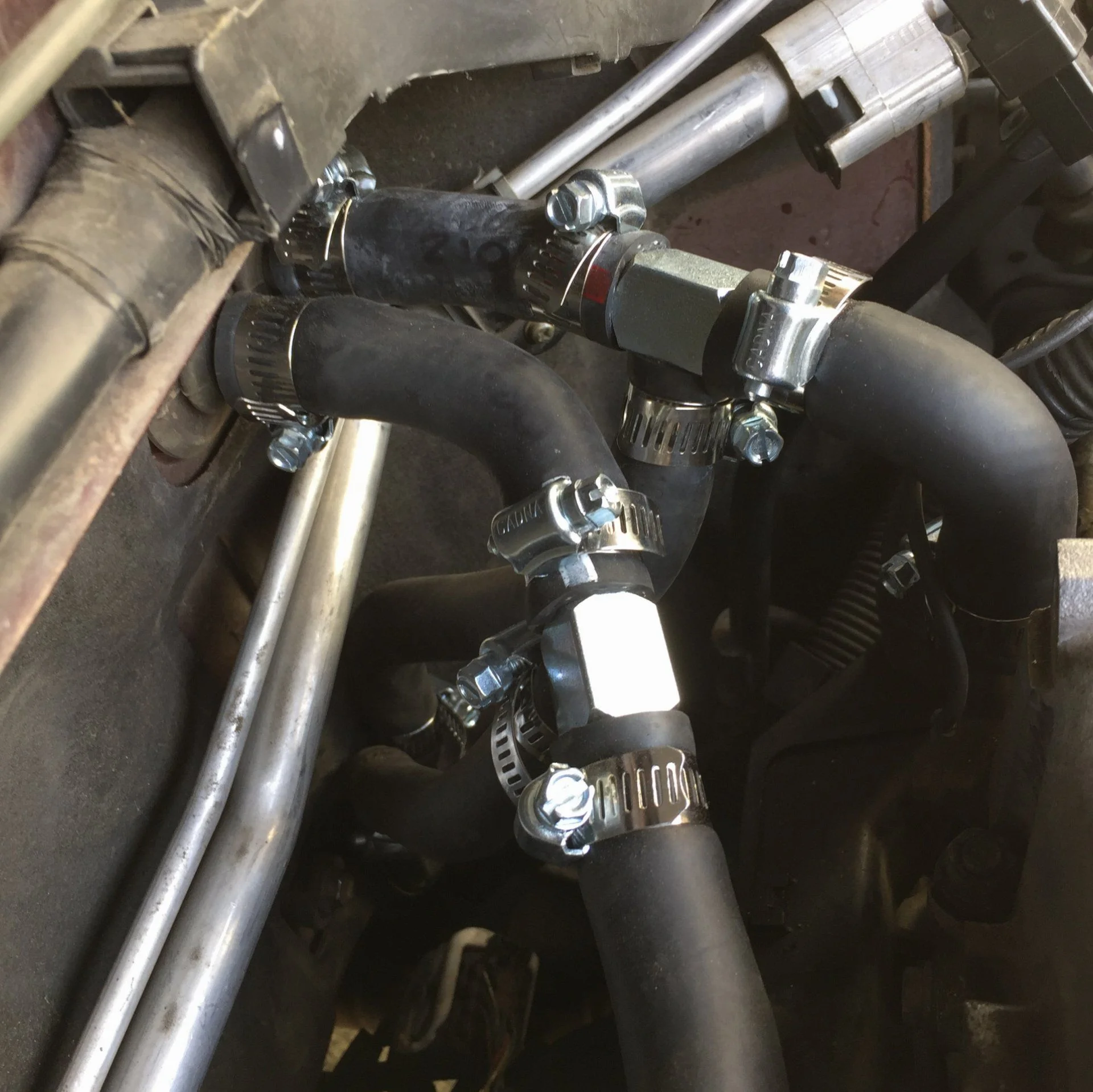

Replaced with stainless T's and OEM hoses:
Just ordered stainless T's, gates hoses and new radiator hoses. I'll be tackling that job next weekend.

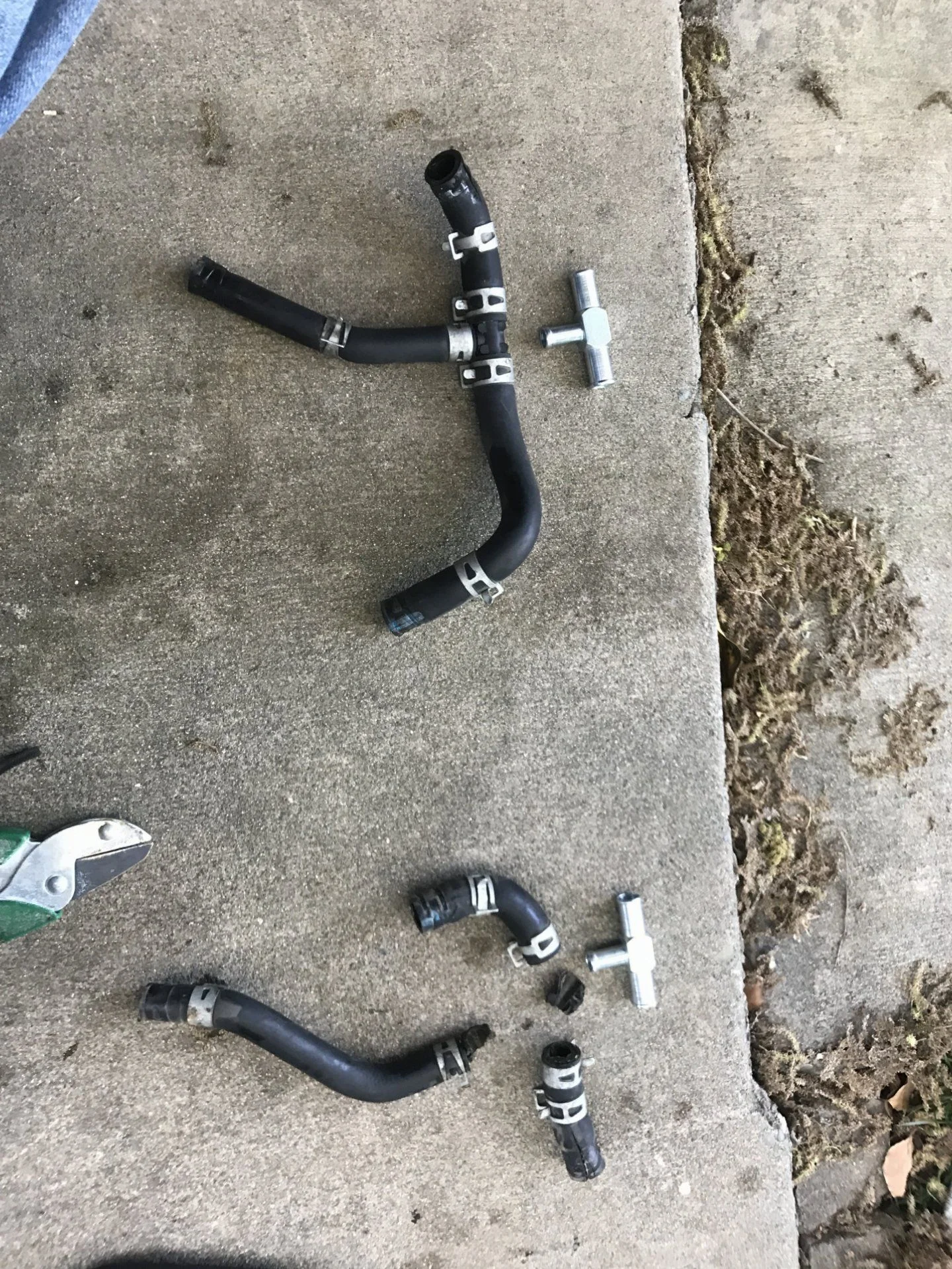

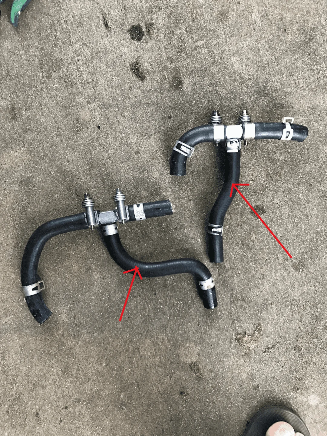

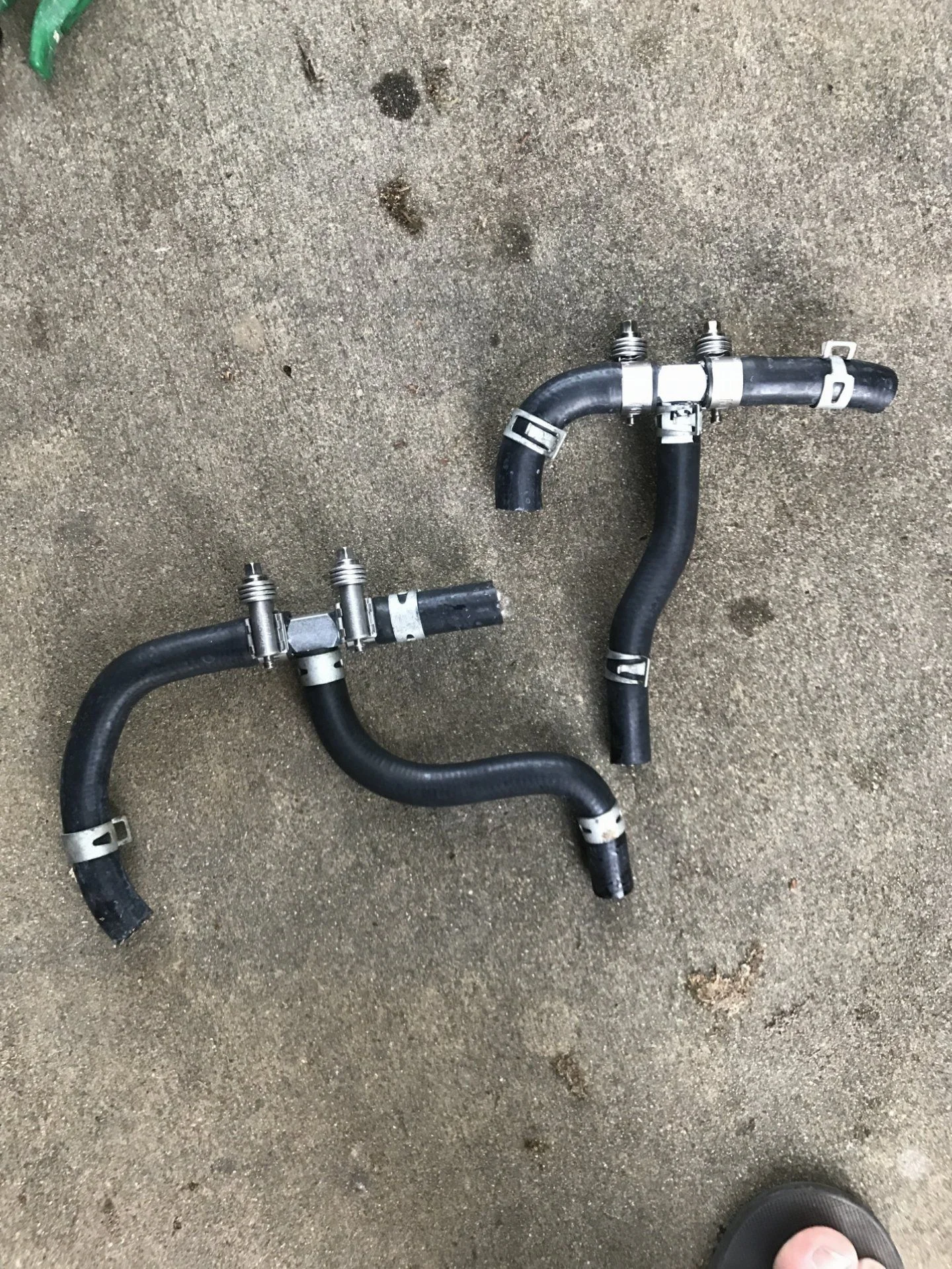

One T disintegrated when I removed it and the other was brittle and was on its way out as well. I used the gates hoses method and cut the pieces from the molded hose. i used the constant torque clamps on the stainless T and reused the other clamps. So far so good!
Can you post the Gates part numbers for the noted hose parts?
