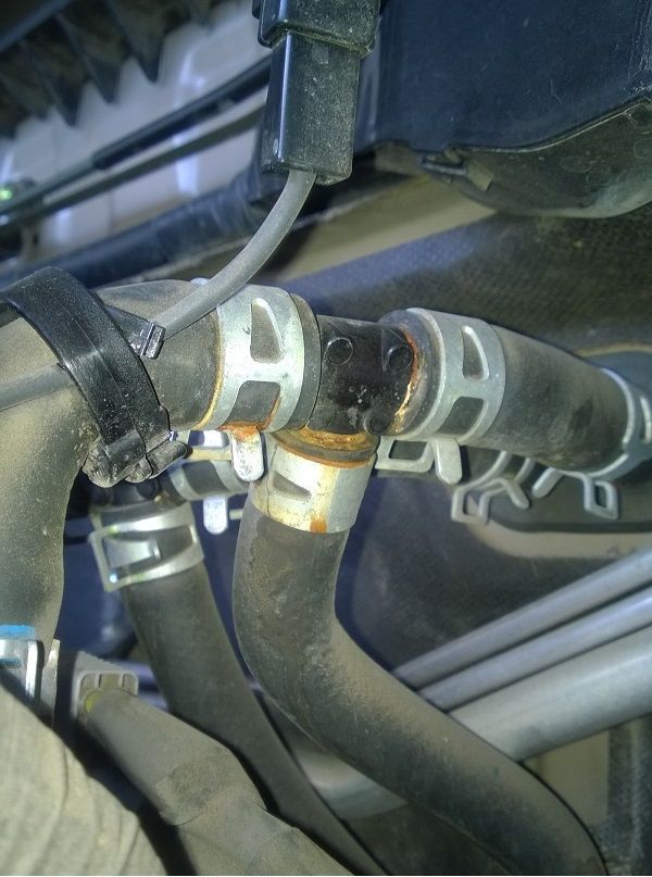

Hoses in good condition with tiny bit of seepage at DS Tee:

Swollen hoses replace with larger Tee or/and screw clamps. Cases where changing hoses would be a good idea:
Swollen hoses replace with larger Tee or/and screw clamps. Case where changing hoses would a good idea:

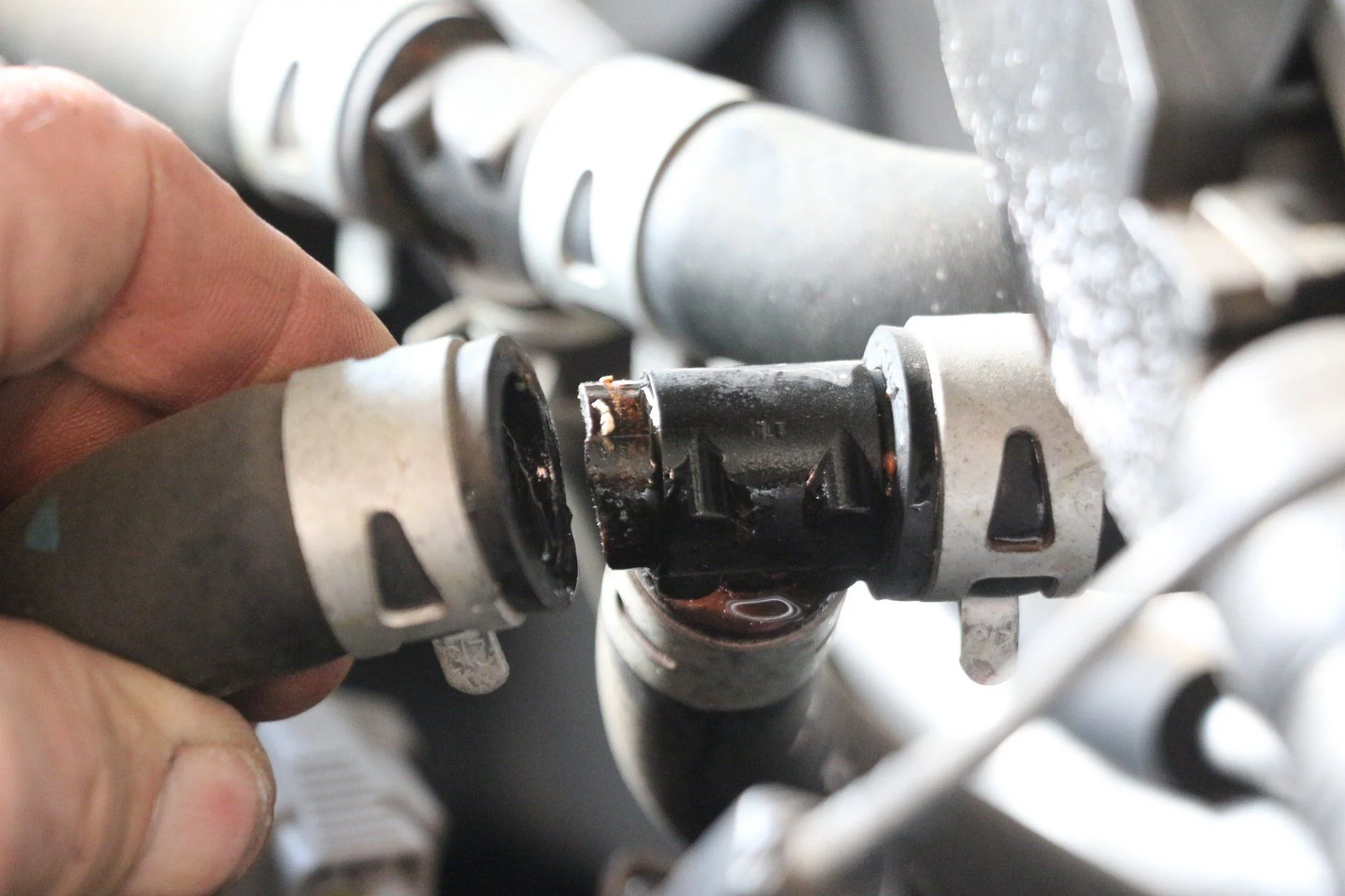

Replaced all my heater hoses and Ts this week. 171k, original still. One of the Ts desinigrated while I was removing it. Very glad I did them before they failed (soon).
DO THIS REPAIR ASAP if you haven't already:)
I've been meaning to do this for a while and finally got it done today. Man was I on borrowed time. The hot side was starting to leak and snapped when I barely handled it. This hose hook made it very easy to remove the hoses. As others suggested I removed and reassembled as a set with new hoses. Thanks OP. Such an easy job to prevent a major problem.

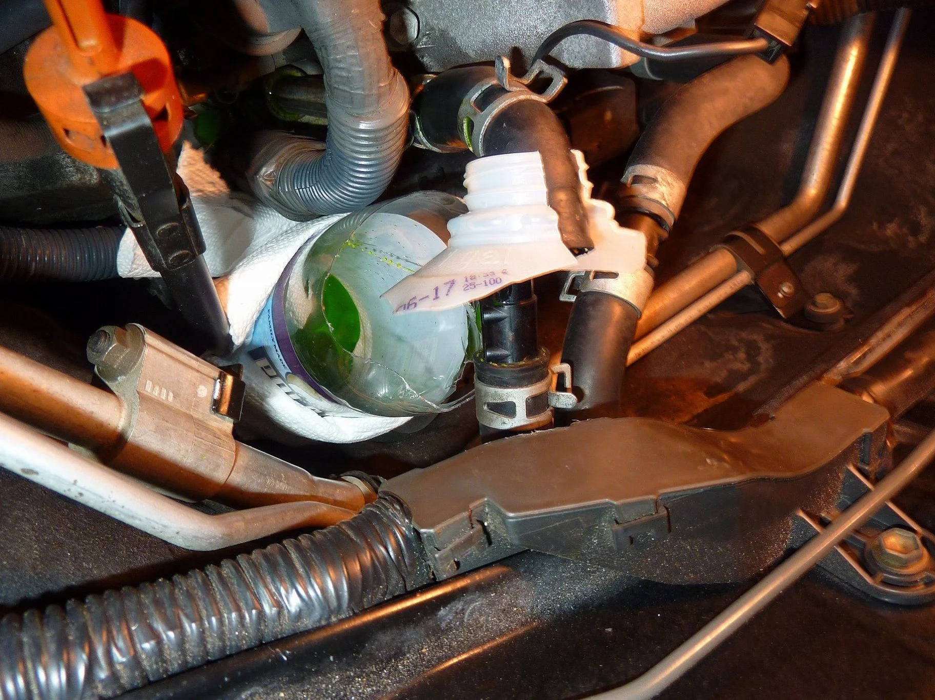

My two notes on this: You are probably going to lose more coolant than you expect so prep and count all your hose pieces. I had to do this job the night before a 5am family trip. The good news is that I saw the problem while doing some other work (it was ready to split in two and would have left us stranded) and had the part (was going to do it after reading all the threads here). Downside was I lost more coolant than I was expecting and I didn't realize until a day later than I was missing some chips out of the remains of the broken T. I went back in with the home built catcher below and couldn't find the pieces. The catcher is just a one liter bottle with the top chopped off and the spigot of a gallon milk jug to redirect the flow into the bottle. I also made my life easier by laying a 2x12 board across the hood with towels wrapped to protect the paint. I just stretched out on the plank to access the T hoses. fyi - T-pipe was failing at 148K.

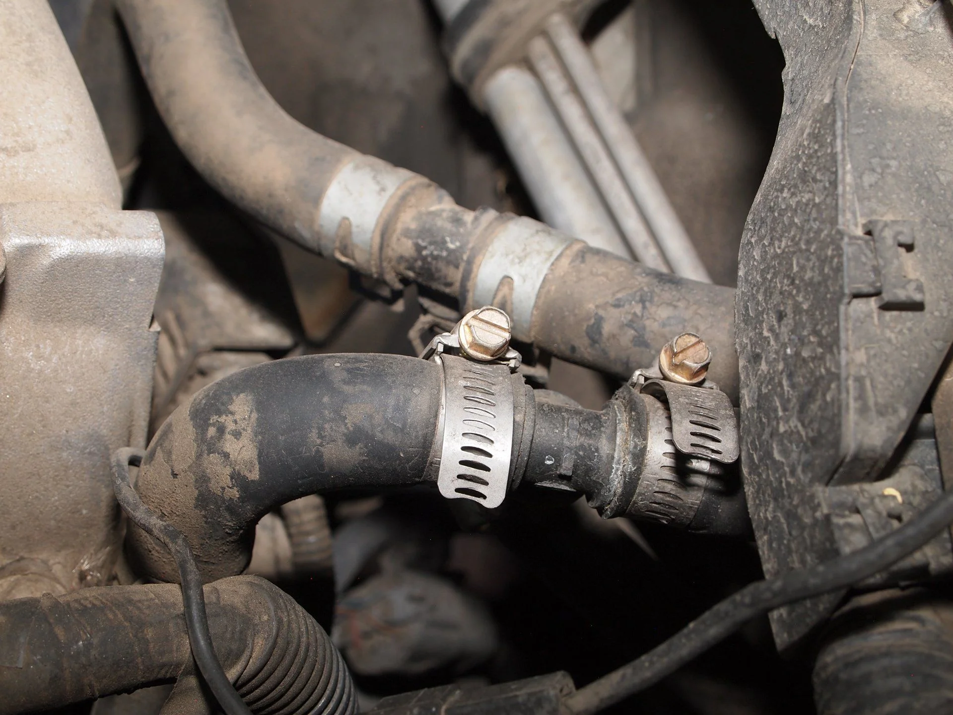

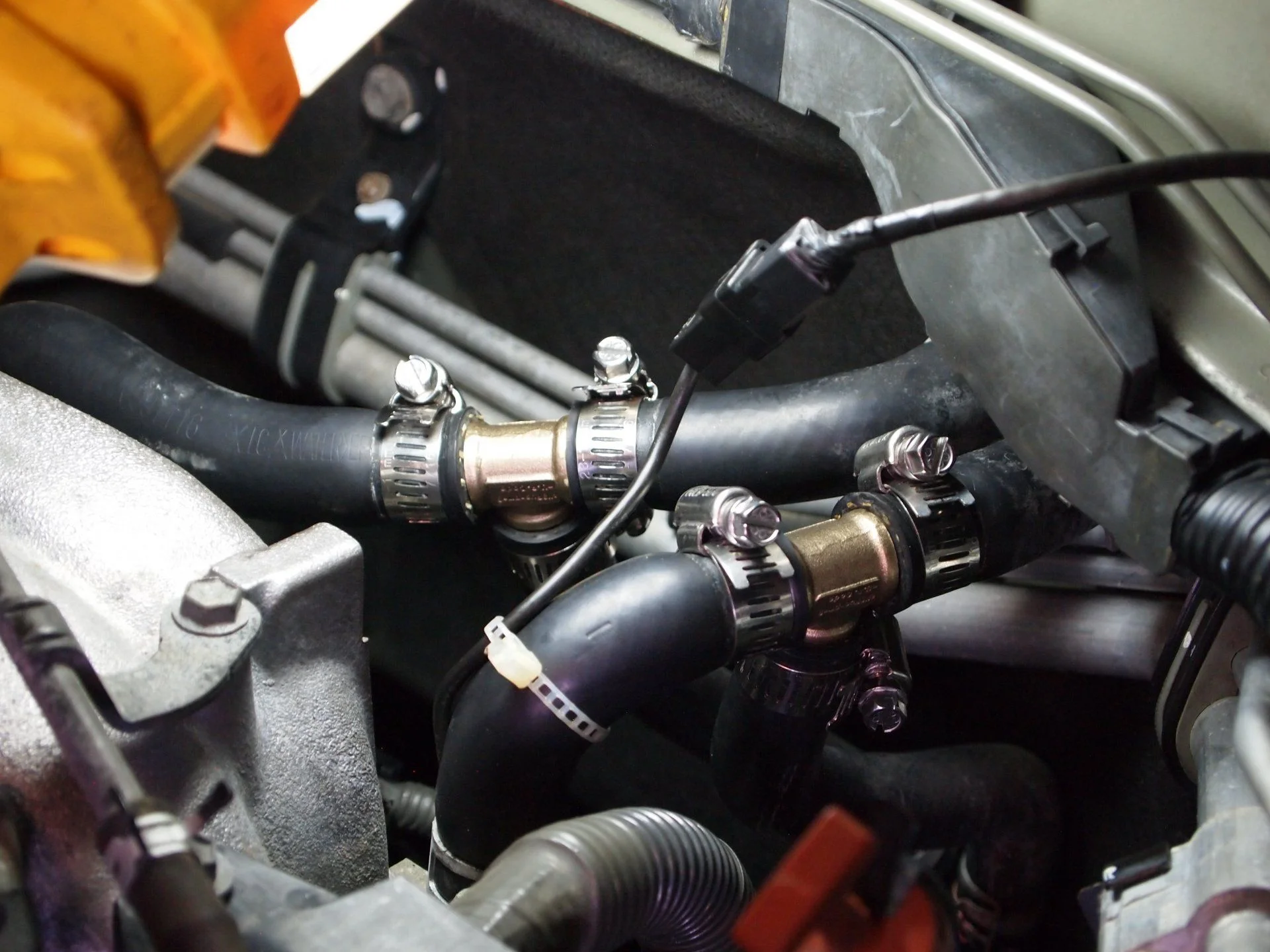

Did a decent amount of research and definitely considered going with metal t's instead of OE plastic but wanted to share the following:
I work for an automotive research lab and we do a lot of work on coolants. Per our analytical testing lead, a number of the ASTM test methods for coolant use brass to assess corosivity most likely because it reacts preferentially as compared to other metals. He said that while the radiator/cooling system may have some brass in it, it isn't just a matter of presence/absence. Changing the ratio of metals could theoretically increase corrosion potential throughout the system.
His $0.02: better to keep replacing cheap and "easily" accessible t fittings than risk creating an issue somewhere more internal that would be harder to find and more expensive to fix.
While I doubt any members who went with brass are going to suffer any ill effect w/ regular coolant changes, Toyota did pay a bunch of engineers a bunch of money to design the cooling system in a holistic manner. Why second guess all of those man hours?

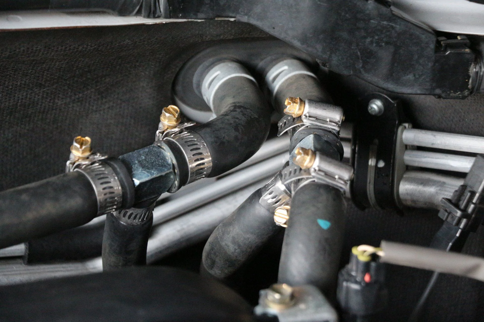

Just put an end to heater T's issues for ever.
My heater T broke when I lowered my drivetrain when I was converting my t-case to part-time.
I was happy when I realized I have the correct one time replacement 4Season T's (part #84543) on the shelf. The 4Season T's have 2 - 5/8" and 1 1/2" nipples being SAE and not metric the factory clamps will not seal on used hose so I used the correct sized Breeze clamps.
I did make a tool for removing the broken piece on the fly that worked great.
I have now put an end to heater T's failures forever.
