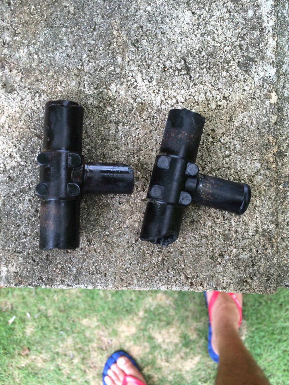

My mega machines and good friend agree to make me a pair out of TIG welded stainless steel, can somebody measure the plastic part for him please..
Ps: I love this community, is very positive and proactive, one of the main reason we end up with a Land cruiser and not some other POS.
Factory tee's measure 17mm X 14mm X 17 MM.
Pass through; 17mm (.67 inch) OD on shaft & 18.44m (.726 inch) OD on barb, 13mm (.50 inch) ID.
Tee (smaller down hose): 14mm (.55 inch) OD on shaft & 15mm (.59 inch) OD on barb, 10mm (.40 inch) ID.
Length of shafts are 25mm (1 inch).

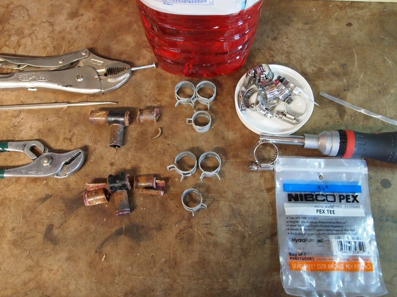

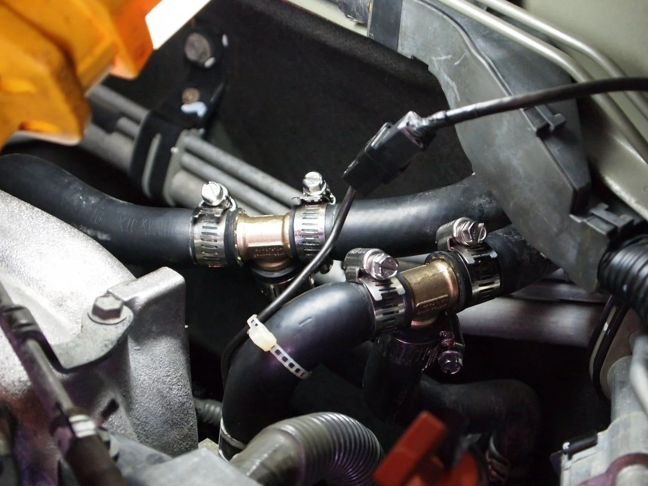

Sunday, so I just pick up two 3/4x/3/4 x3/4" brass tee's and six ASS screw claps, cost ~$20. The smaller hose side fit snugly over the 3/4" tee, but I could have gone with 7/8" or greater on pass throughs. The originals factory clamps probably would have worked fine. But felt with old hoses (expansion) screw clamps would a good idea.
Drain off a little coolant first thing, didn't lose any during replacement of tee's.
All hoses where swollen a bit. I'll schedule for replace on next flush, all though rubber felt good.

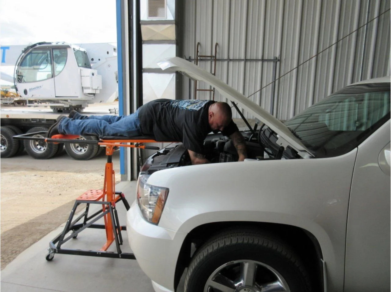

Quick job like this I just lower AHC, which was perfect for me on DS, and I use a step stool on PS.
Now for the starter, I'd really like one of the above creepers.

Just went through finding parts for going the non-OEM route, figured I'd share what I found... Because I went with smaller-than-OEM-tees, I thought it prudent to source the proper size hoses in as close to stock shape as possible rather than just clamp down as hard as I could on OEM hoses and hope for the best. Like I mentioned in my personal thread, I don't like the idea of getting stranded somewhere and not being able to get specialty hoses; I would much rather be able to use a hose that any redneck at any shop can get me on a day's notice.
Tees: 84543. Can be bought multiple places, including but not limited to Amazon (as mentioned above), Advance, O'Reilly, and Napa. I bought mine locally at O'Reilly Auto Parts and got them same day, ymmv.
Hoses: Gates 19082 and 18622.
Hose 19082 is 5/8" ID (same as the pass through OD on the 84543 tee fittings), and can be cut up to replace the four upper hoses that connect the engine to the heater core, and gets rid of the 90 degree bend hose.
Hose 18622 is 1/2" ID (same as the tee OD on the 84543 tee fittings), and can be cut up to replace the two lower hoses that connect to the rear heater lines.
