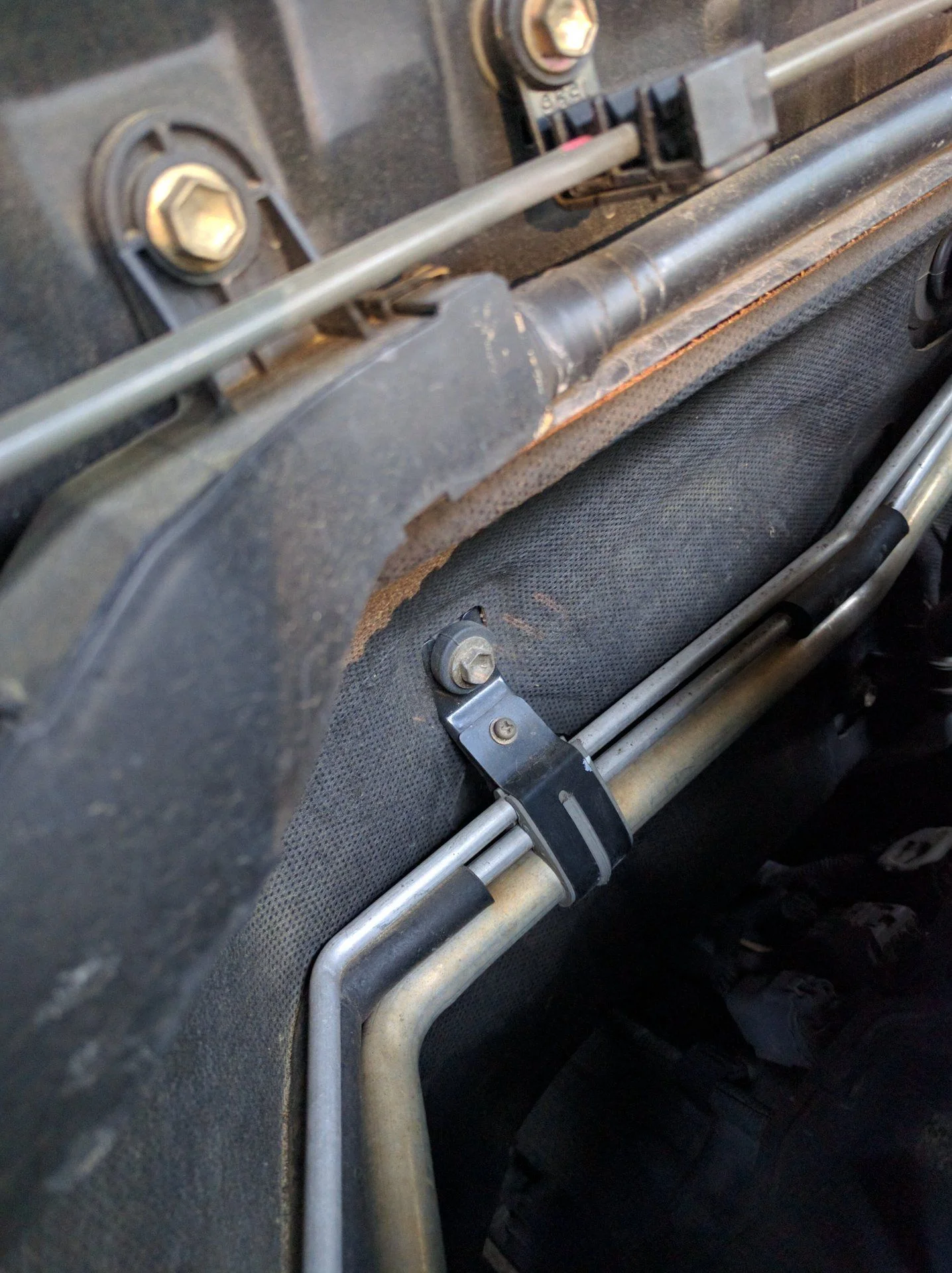

One question... When tugging on the hose I moved this bracket for the two lines. Can someone look at theirs and tell me if it goes in front of or behind that rubber grommet? I'm assuming behind. Thanks!
