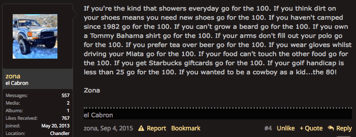

    For the price of @NLXTACY's Supercharger install (and motor rebuild and chasing down overheating) you could purchase a 2-3 year old 200!!! :rofl:
    GM V8 swaps are lame.
    Talk to Robbie. This seems like a brilliant option.
    As @zona eloquently put it...
