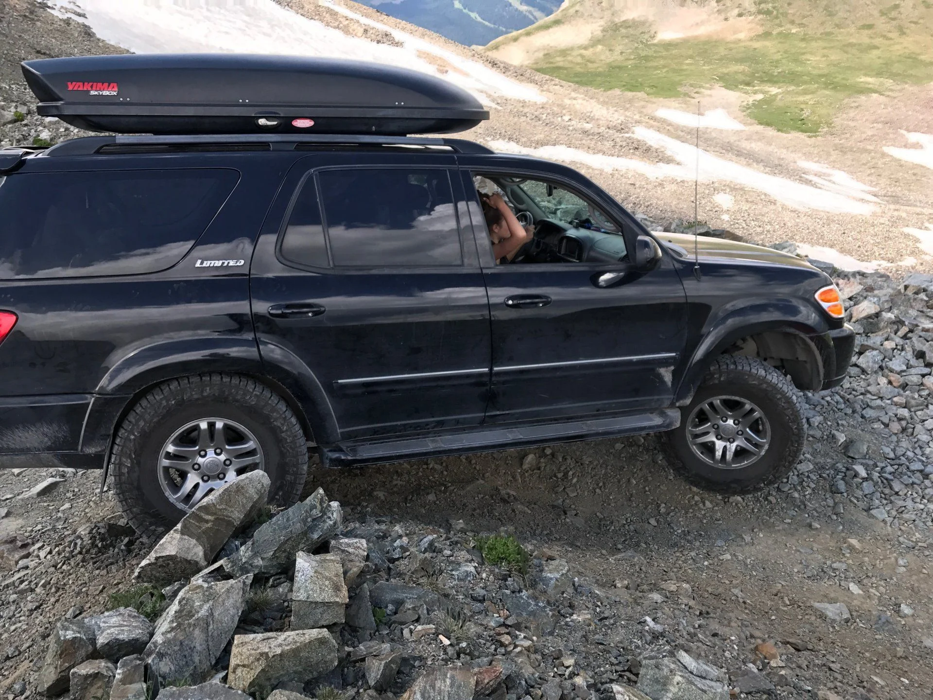

    Honestly, why bother with a Cruiser at that point? A first gen Sequoia can handle a lot more than you think without the size or cost penalty.
