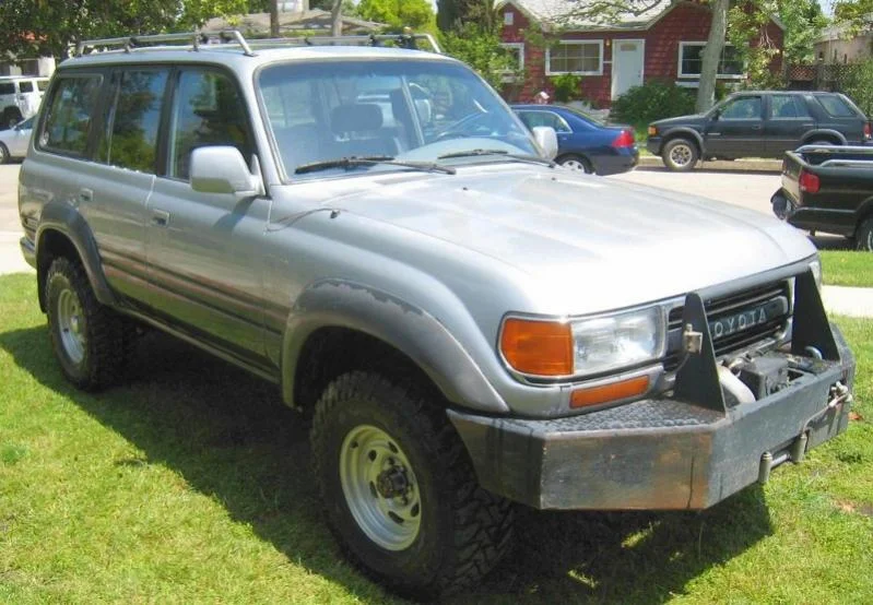

91 FJ-80 with 1HD-T swap
1. 1991 FJ80/1HD-T and a hydraulic A442F
2. Stock drivetrain with rear ARB
3. I didn't do the swap but the 80 was available with the 1HD-T so it fits well
4. California registration
5. A gianormous front bumper
6. Compared to my 1FZ it's louder, feels stronger
7. 19 mpg from Van Nuys to Berekely at 75 mph with 33s
8. * - since I didn't do it
9. As I picked it up
10. Project Stinky

Grumpy-
Is that Dana's (RIP) old rig?
-Matt
Grumpy-
-Matt
Yes, and here's a weird coincidence. When I picked it up his wife told me their daughters lived in the Bay Area now. Would you believe I know one? Small world.
Ken K. told me no one liked following Dana on the trail due to the diesel smell hence the name Project Stinky.

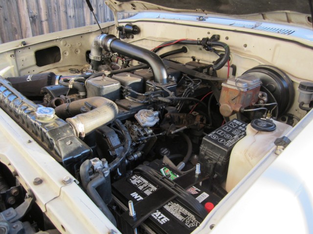

Also, considering the engine has been in the vehicle since late 2010, I thought I should get off my butt and get around to showing an image of the engine bay.
[QUOTE
Also, considering the engine has been in the vehicle since late 2010, I thought I should get off my butt and get around to showing an image of the engine bay.[/QUOTE]
Dude- That has to be one of the cleanest 6.2 / 6.5 installs I've even seen! Nice job!
-Matt

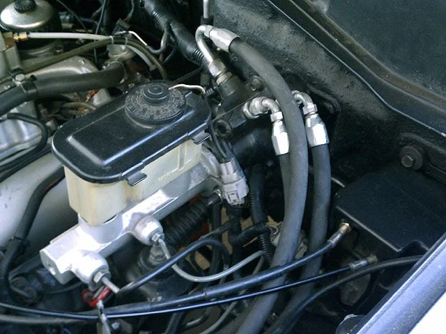

I was thinking the same thing. What donor vehicle did you use for the hydro boost setup and what modifications did you have to make to get it to work?
