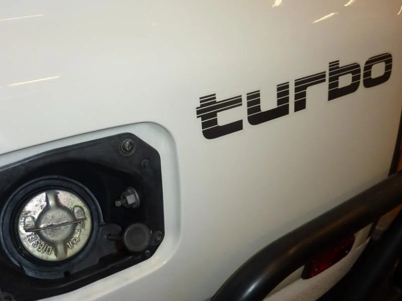

#3 = Fuel door (notice anything?...other then the decals not complete yet)

Nice decals, you need the "Direct Injection" one too. Let me know if you want a "Diesel" decal for inside of your fuel door as I have an extra one.
