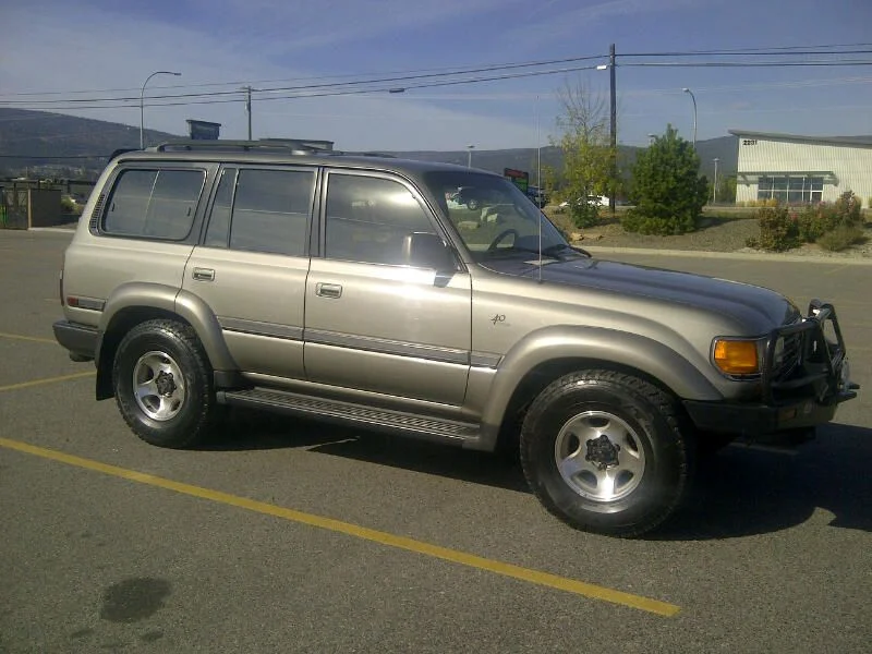

This is my locked 40th anniversary edition, 1HD-T/A442. I completed the mechanical portion (the easy part) myself and then handed it over to a wiring guru. Let's just say that didn't work out too well. It sat for the next 2.5 years. Thankfully I discovered Tor and his excellent little business just south of me. I got the temp gauge and oil px working and drove it down to him. A little over a week later and under budget, he handed me the keys with every electric doodad working just as mister T had intended. Can't say enough good things about Torfab. Thanks also to Sheldon and Ciaran for their encouragement and help along the way!
Next on the list is to source an AC compressor, install my OME lift and my Auber egt/boost gauges.
