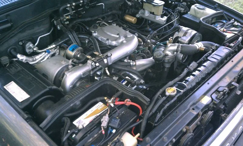

FZJ80 to 1HZ built, with full auto
Started the project a few months ago.
1. 1994 FZJ80 Auto, 336,000km
2. Engine 1HZ with new Toyota 1HDT rods and pistons, new cylinder head, diesel pump upgraded with pressure compensation, fully blue printed, all Toyota fastenings and gaskets. Gearbox from 94 1HDT Auto, non electronic valve body A442, transfer case fitted with Marks Adapter centre diff.
3. Complete harness change from 93 1HZ manual, dash from 95 Turbo.
4. Dash, engine and gearbox harness required complete custom re-work as new harness had older style 5 plug harness and dash was later 3 plug. Electronic speedo
Forget the numbers as I cant remember the order.
Garrett 30/73 (from memory) Full ball bearing turbo
I am a qualified mechanic with 30+ years. It was a challenging conversion but all works now. Lots of little differences in the cars, fan depths, change over switches.
Got Lola going this weekend and very happy. :steer::steer::steer:

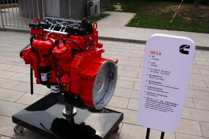

Gathering information about new ISF 2.8/3.8 engines: Cummings put into production new line of light engines. I believe these are the best match to put into ANY Land Cruiser. As they have way better torque in stock. ISF 3.8 capable of 600 lb-ft!

This is the 3D of 3.8 given in Youtube

These engines are produced in China in Foton-Cummins plant. And a lot of vans and trucks are getting powered with these engines including 8.5 ton trucks which means they have enough power to handle any type of TLC.
Like the Chinese made Foton truck 3.8 LWB - and it is mated with ZF-5S420 manual trans.
http://www.fotontrucks.com.au/model/isf-3.8-mwb/
There are some interesting pics with that engine in the bay of that truck.
Dimensions given in the Cummins data sheet definitely shows that the engine is smaller than 4BT or any stock engines of 80s. Another thing is the way how they built, Cummins used modular technology. Any engine can be modified for vacuum pump, air compressor, power steering pump can be supplied in any combination. Including AC compressor or they can be supplied with front and rear air compressors. Plus they can be programmed differently for different power/torque output.
I will definitely go in that direction. :) These engines are getting really popular! Even Russians are getting these for mid size vans.
I did some research and contacted dealers in China - FOB terms brand new engine is $ 7 to 10K depending on the accessories and ECM options. It is pretty much the same price for used 1HD-T or 1HD-FT.

The 3.8 will definitely have 80 series fitment issues due to the sump and starter location methinks...
-Phil
I have seen different pics of 3.8 with oil pan turned 180 degrees. And I believe it is also option when ordering engine. With the exhaust - they have Foton Tunland we need to see how it arranged there. Could not find any yet :(
MOD - I have found picture where the oil pan is opposite way. Thanks to modular construction the accessories can be installed on different positions. Contacted Sino-Cummins and asked for more details. So far I got this: standard package includes engine with accessories: ECM, alternator, air compressor (no idea why), power steering pump, AC air compressor, vacuum pump and additional fuel filter with housing. Engine can be preset for certain torque, three options: 450 Nm, 600 Nm and 780 Nm, speed also can be increased up to 3600 RPMs. Extra package includes cruise control for manual trans, 220V heater and aftercooler. Keep digging for more info. By the way they are for sale in South America so can be easily sourced in US.
