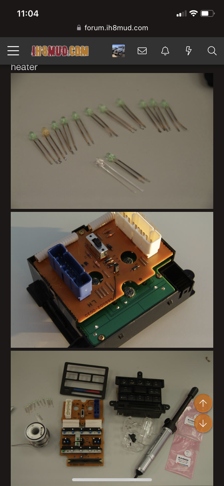

Looks great! Any chance you have done the HVAC panel? I can't seem to find the 3mm "long wire" LEDs to solder that are mentioned in page 1 of this thread. Amazon??

I haven’t done those, just the mini wedge bulbs in there. I didn’t search to the point of finding what I’d order, but found a variety of results just searching “3mm led,” and adding “through hole”

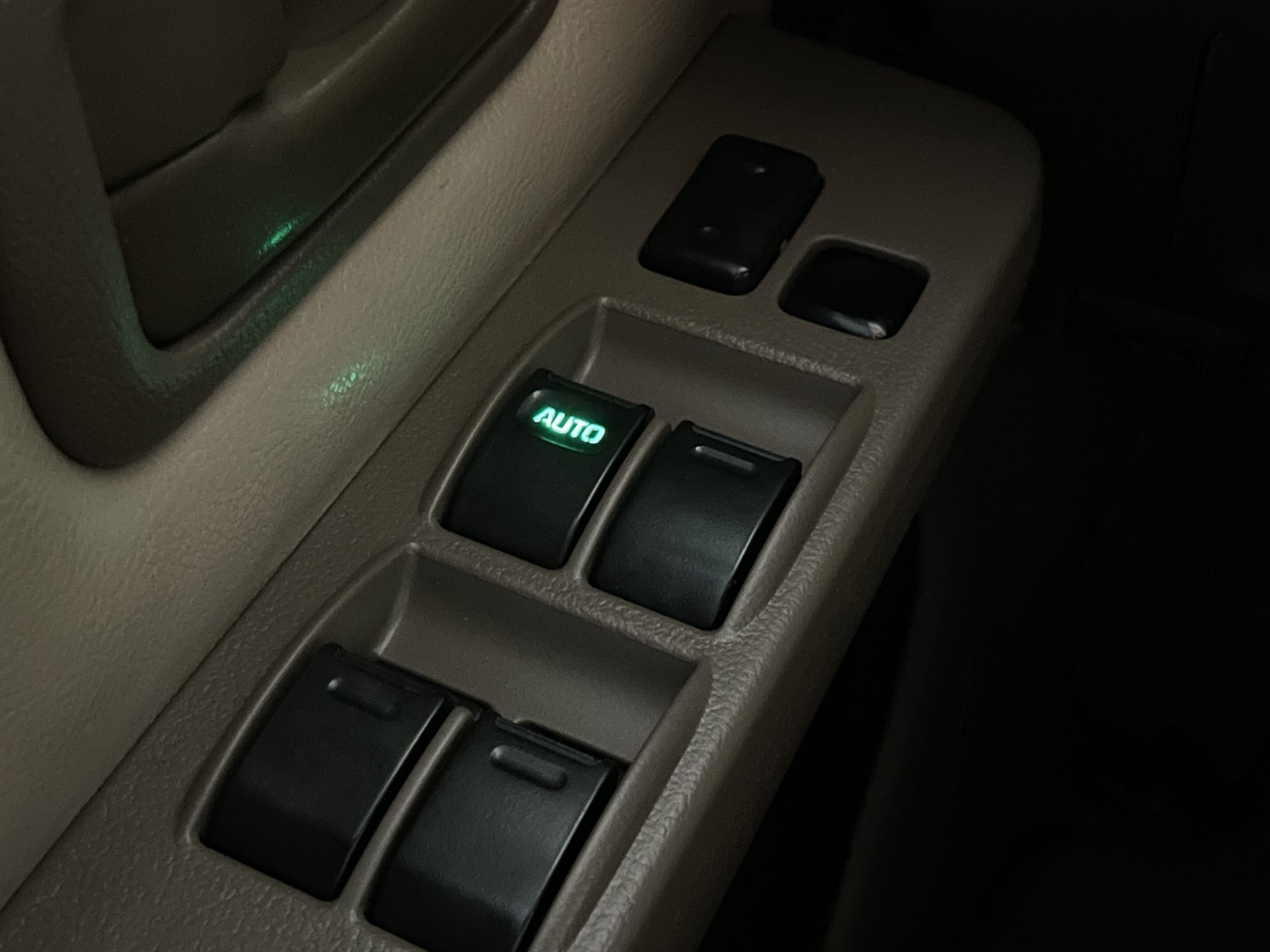

I replaced the LED in my driver window switch. For some reason it is always on, even when the car is turned off, until I open the door to exit the vehicle. Then it says off.
Also, does not dim when the headlights turn on or when I control the instrument dimming knob.
Is this in line with what others have experienced? Or might I have a bad/insufficient resistor on the small board where this led sits. Thanks
I just ordered all the button from my Toy dealer, $47 for all of them. I found the LED's on Amazon for $9. I am going to invest in a soldering tool on Amazon for $40. Play around and learn how to do it and THEN do the HVAC panel. I am a couple months out on this project, first the engine completion, then lift, then tires, then move to inside cabin for full restore. Preping all parts and an exhaustive part number list in a spreadsheet.
