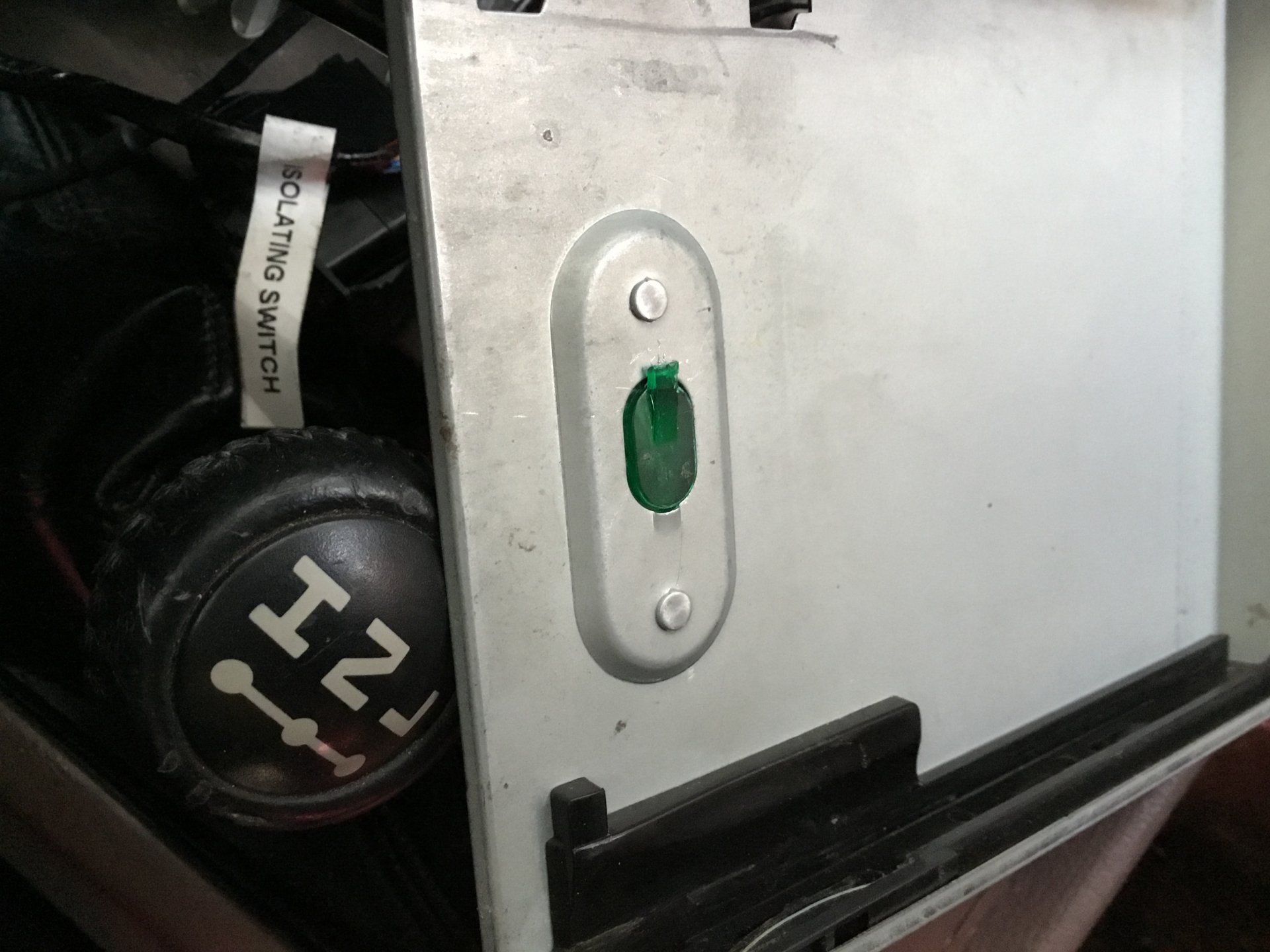

Let me start by apologizing for not reading through all 23 pages of this forum. I would appreciate the secret of knowing how to change the little light bulb out of the ashtray? second I am thinking about ordering LED lights from superbrightleds.com for the dome lights, door lights, glove box, vanity visor lights, and the map light. I did read a lot of the beginning pages and I came across the concerning issue of the LED early demise due to voltage surges in the LED vs halogen bulbs. So do I need to install an inline voltage regulator or something along those lines?

Yes but how do I get to the light bulb in the first place? I tried twisting and pulling, pushing, twisting, pulling.... I tried to take out that green plastic piece but I dint want to force things and break something. i checked the owners manual but nothing tells me how to access it.
The green plastic stays. It's been a while since I worked on it. So, actually don't remember. Don't want to give you wrong info.

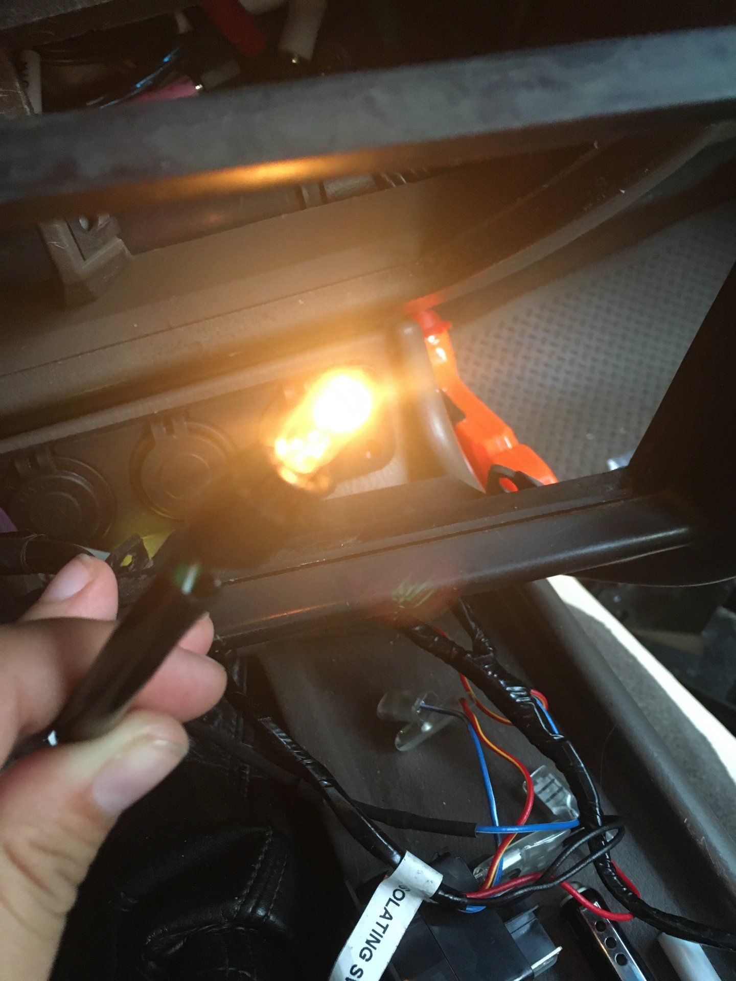

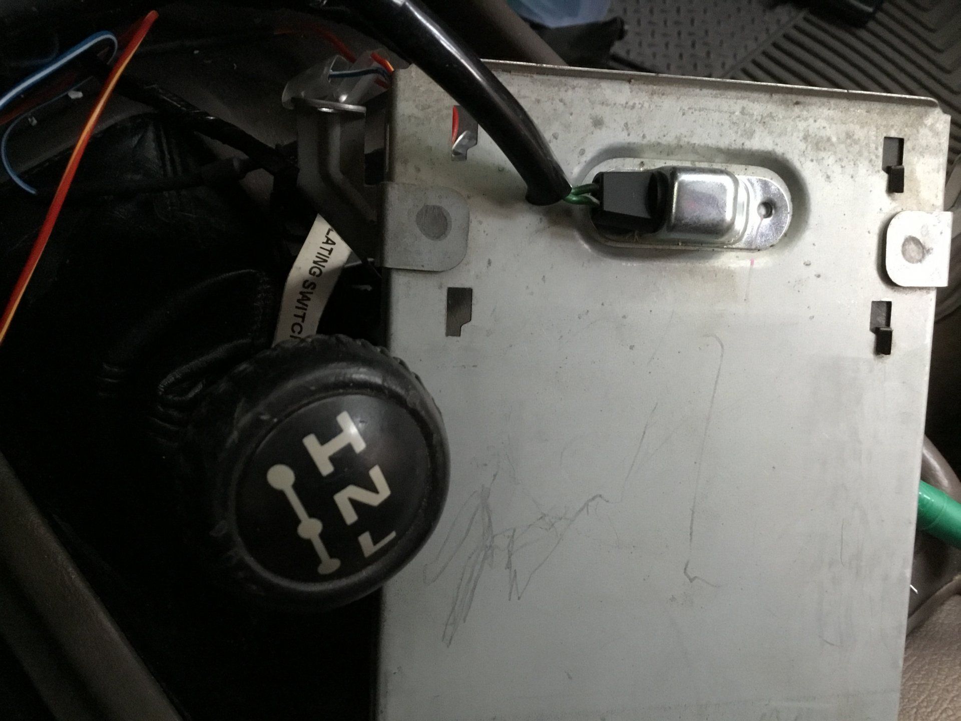

Success... next road block! Now how do I remove the light bulb? I mean wow it just seems to be one whole mechanism sorta like the 12v lighter bulb.
for anyone stumbling across this the black port going into the ash tray needs to be twisted so that those flat grip areas are accessible side to side and then push it to an side angle and use a miniature flat head screw driver to pry it out.

It is a #74 bulb, the same as the glove box. I took the bulb out of the glove box and replaced the ashtray dead bulb to test it. For some reason the light bulb doesn’t work in the glove box, it just slips out of the socket... that is next on the repair list.
