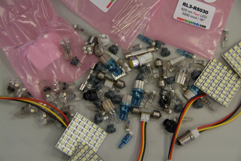

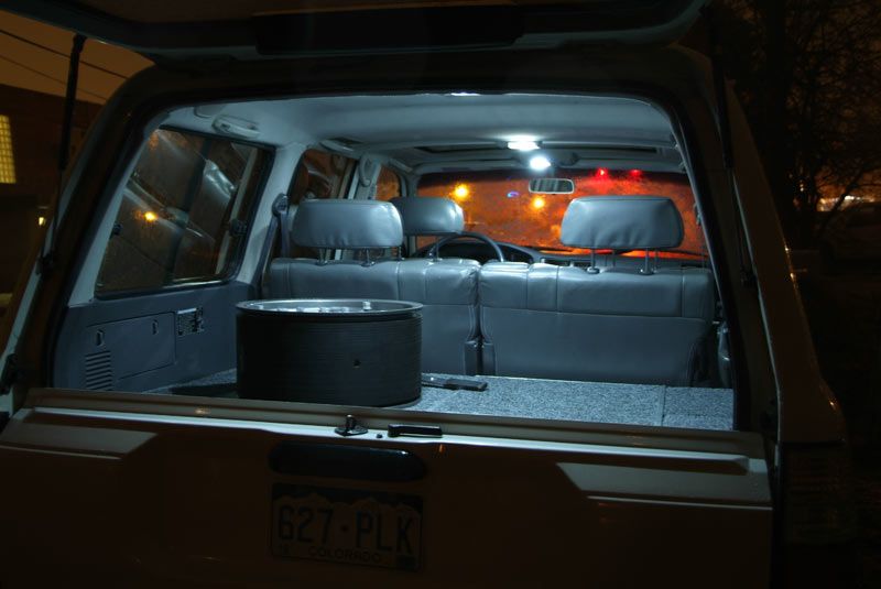

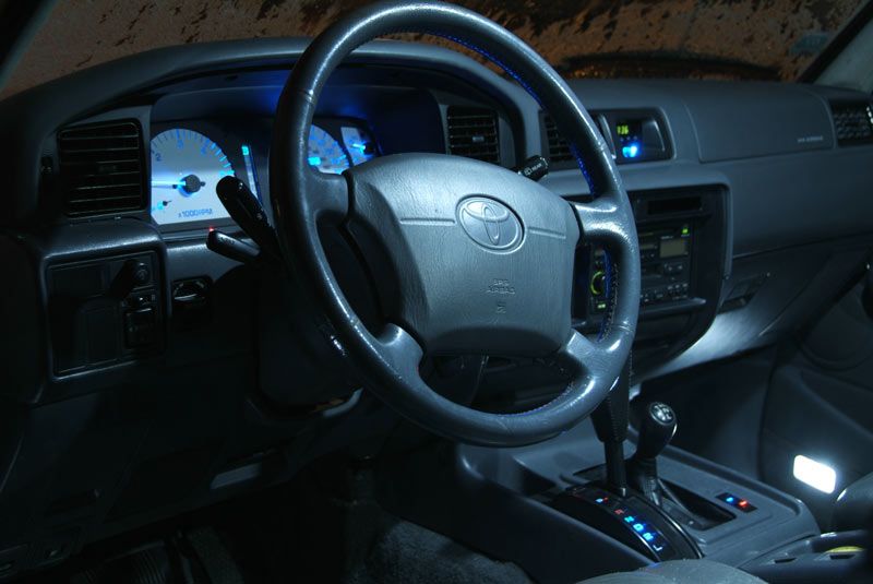

For myself, I can’t leave well enough alone and subscribe to the mindset of “if it ain’t broke, fix it until it is.” So I went through the trial and error process to find what works for me. I am happy with the leds I chose and I found jcardona’s post #402 to be the most helpful listing what I needed in a 1996 cruiser.
I prefer incandescent in the turn signal indicators and “D” light. The reason I prefer incandescent in the turn signals is because the leds I chose would slightly illuminate when I pressed the brakes. I like a dim “d” light so that’s why I didn’t use led there.
I also went incandescent in the actual turn signals and brake lights due to radio interference.
I recommend autolumination’s bulbs because they seem to be better quality than more common places (Amazon, eBay).
I did piece together some of my stuff using cheap 3v bulbs from lighthouse leds with resistors because they had the best and most even light spread.
