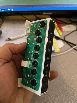

Shift Indicator
(1)Type B - green
(9)Type B - white
or choose your colors
In the pic above, the type A is on the left and the type B is on the right.
The top one is a Type C and your Land Cruiser doesn't use those.
Type A (T3)
8mm or 5/16"
Superbright NEO3-x is the T3 (8mm base 3mm LED)
Type B (T4)
10mm or 3/8"
Superbright NEO4-x is the T4 (10mm base 4mm LED)
Type C (T5)
12mm or 15/32"
Superbright NEO5-x is the T5 (12mm base 5mm LED)

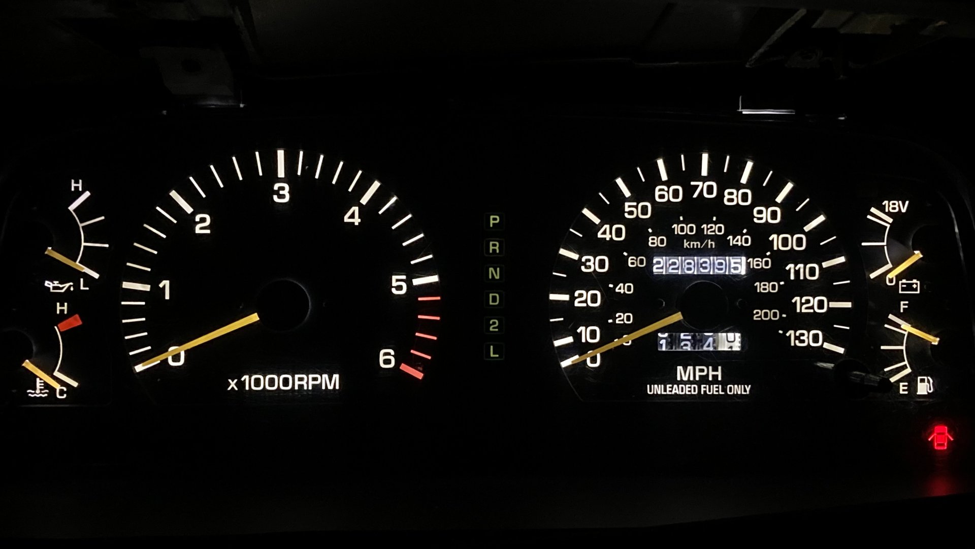

Been playing with dash colors/bulbs after one of the original yazakis finally died. The old green caps were fused/brittle, so put new bulbs in clear. Didn’t mind the off-white, but they were a little “milky” without the diffuser-effect of caps. Ordered green caps, and also white LEDs to give them a shot. New green isn’t bad, but very green - originals are a little softer & have more yellow. Then tried the LEDs, which I chose because reviews said “I wish they were brighter.” I’m not a fan of bright instrument lights, and they are within my range - brighter, but not crazy. Yeah, dimmer knob, I know.. but I need to address stereo whine first, which it interferes with if not maxed.
The white is nice (link). We’ll see how they last.
Put an LED in the shifter, but too bright for me. Really like them in the map & dome lights, and changed the glove box too.
Probably going to try them in the AC buttons & shift indicator to match, and then adjust my scangauge color too 😜 side effect - I’ve become a pro at pulling this stuff apart, not that it’s hard.

My CEL bulb went out when messing with cap colors in the cluster today (I have the 0401 code).. swapped and tested, confirmed. Picked up a couple 74s, but they are ever so slightly larger and the base is thicker, which required more force to push into the base, and then the base was spread apart and no longer fit in the cluster hole. Are we positive those are a 74, or does sylvania have a thicker base? Or is there a “special” 74 for this? Search didn’t help me out.
This is also the case in my shifter. I can’t twist the base in the hole or it squeezes it together and pushes the bulb out a hair, losing connection, but at least I can finagle it into the hole at all.
