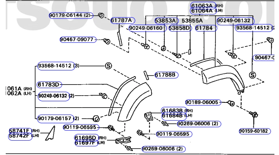

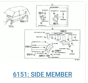

If you want new parts, use your VIN and search the PartSouq website for the part numbers you need.
You want the BODY/INTERIOR category and then this panel:
Then email Dave Stedman at Japan 4x4 with the part numbers. No one can beat Dave's prices.
