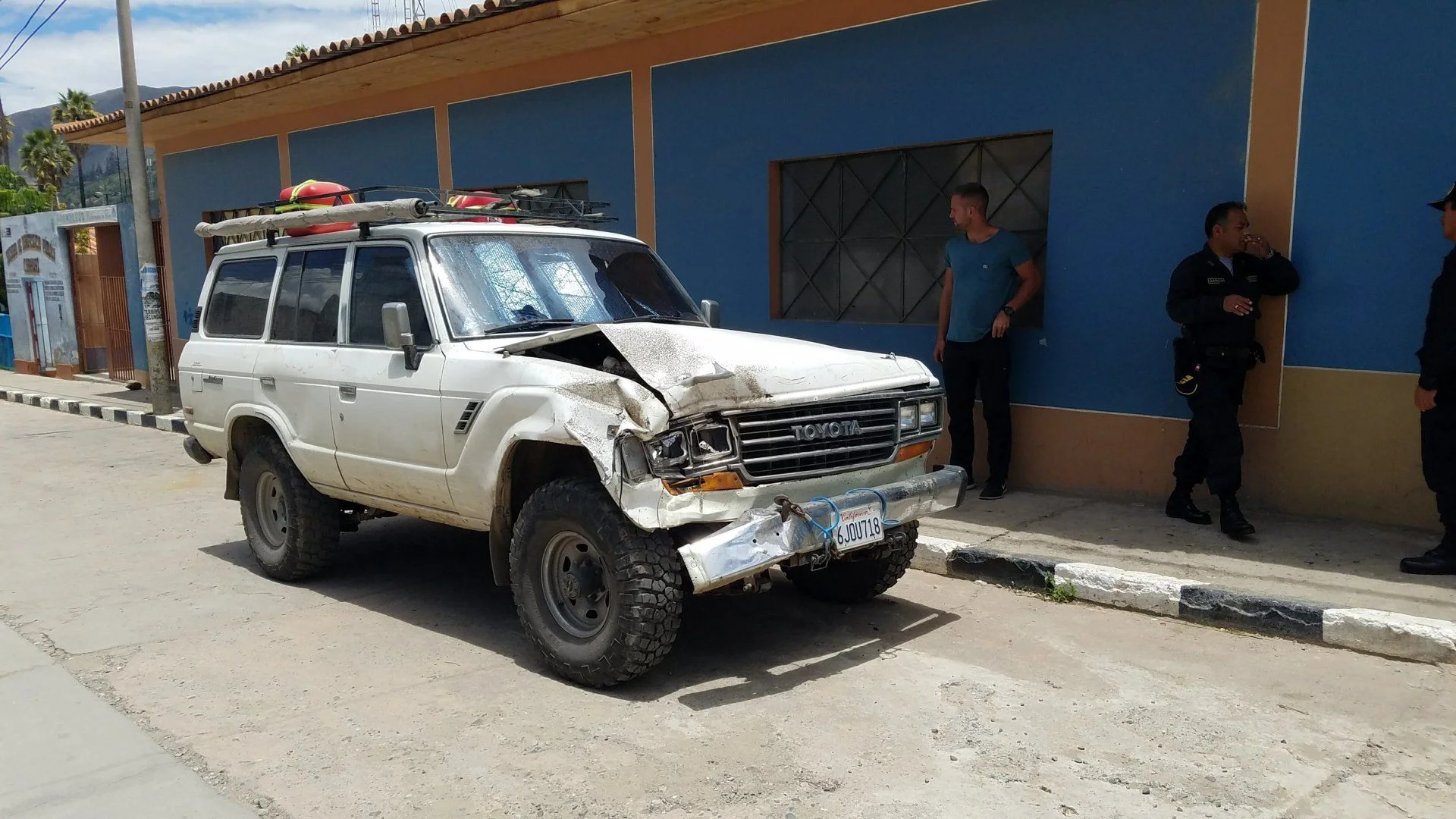

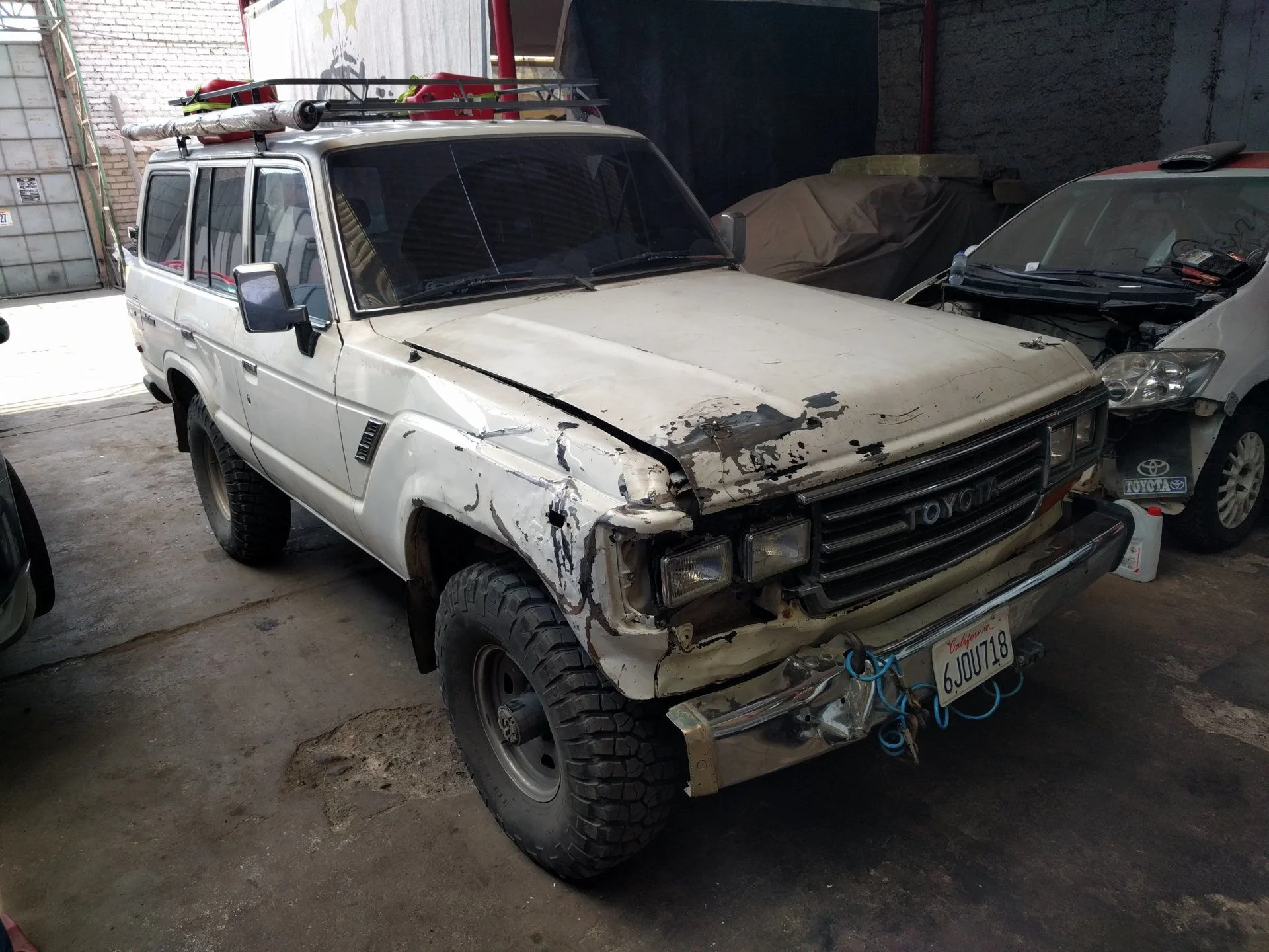

Outside the police station in Peru, after the incident with the bull. At this point I thought I wouldn't be able to continue.
20 hours later with help from 3-4 mechanics working the car with jacks, chains, hammers and whatmore we regained hope, that I'd might be able to complete our trip. They did not demand a single penny for their help. What a bunch of guys...

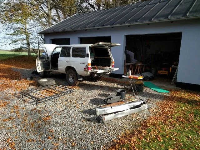

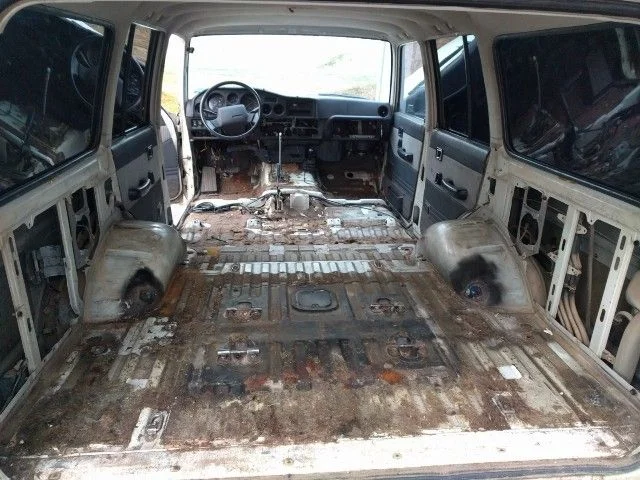

Results from day one of taking apart
- Everything came out pretty easily
- It's going to be a mess figuring out where everything needs to go, but there's no other way to do this but to just go ahead
- Every bolt or screw is saved, but I will try to replace everything with new ones
- Dash board doesn't come of easily. This will be the next thing to do.

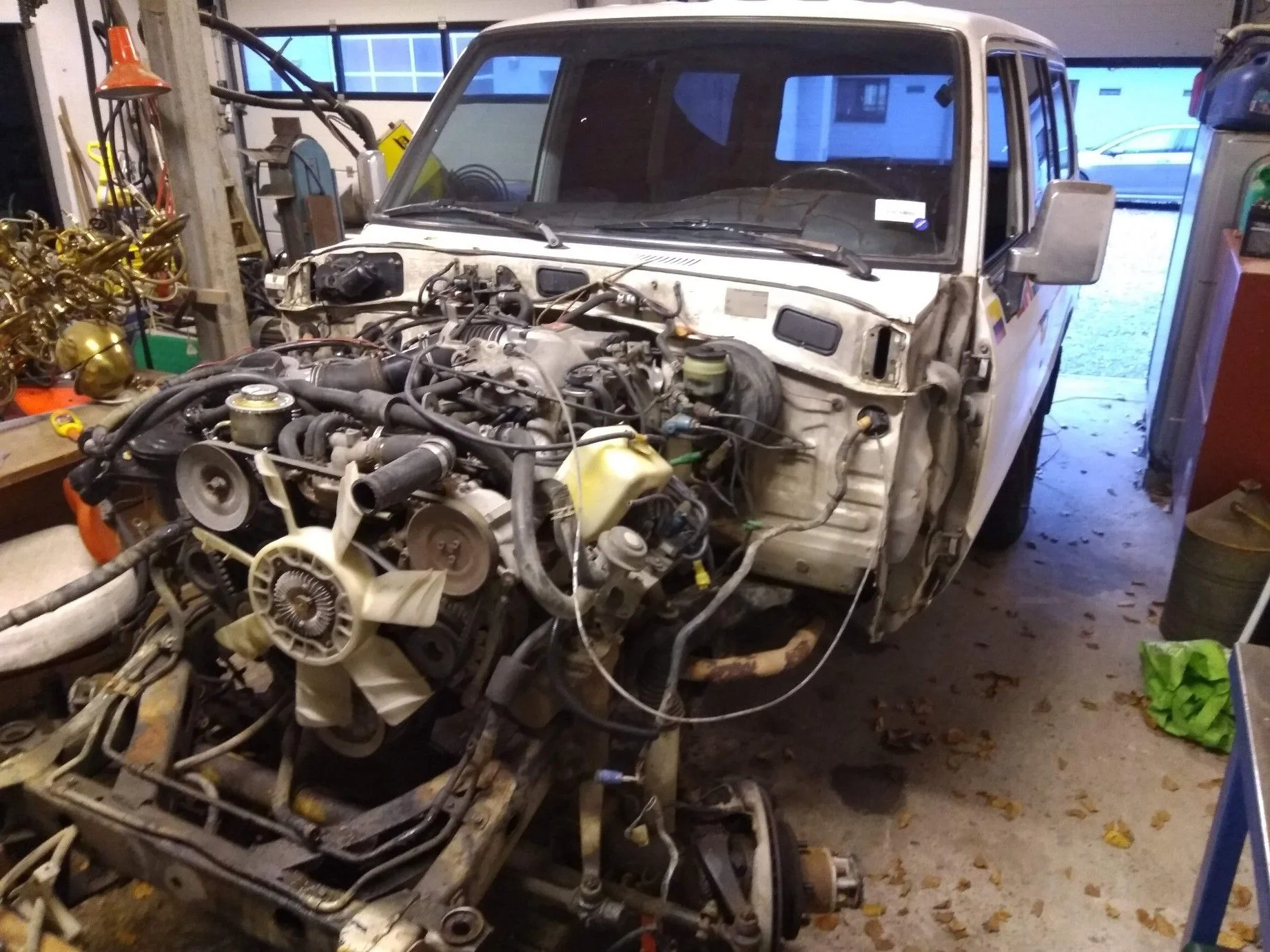

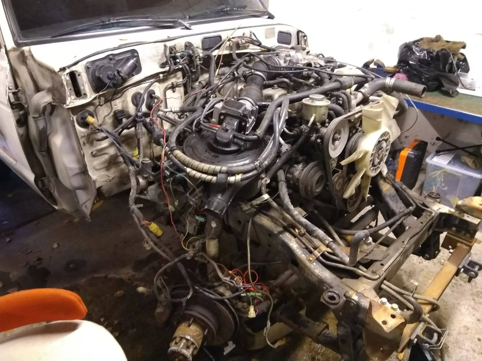

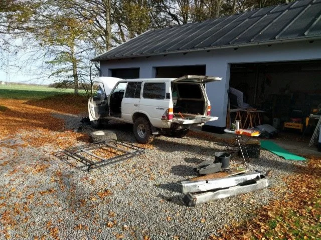

Got the car on stands, front wheels off, panels of in both sides, radiator and radiatormounts off. I'm surprised by how fast this was. I love the simplicity of the mechanical structure. It's straight forward. And almost everything is metric. Feel sorry for you guys but for a European like me, that's just easier.
Now I'd say I'm ready to take off the panel above the dashboard. I'm going to leave the dashboard in, as it's in good condition (I think so). Th panel though has been damaged by the Californian sun and looks like a moon crater. I saw some posts in here of ways to fix it. I might try that.
The panel is not very easy to get off though. I do not understand why it is bolted so well on. I should probably look into the manual to make sure I'm taking out nothing more than the necessary bolts.
After the panel I need to get a bunch of small stuff out, and then it's the body. I gave it a quick look today, and it didn't look like much more than 6 bolts holding the body on.
Does anyone have an idea how much the body weighs with everything out? I have a tractor with a fork lift to lift it off.
I would like to start buying spareparts, but living in Europe it's not that easy. Shipping is expensive so I need to make as much of it as possible and make large orders. So I'm going to have to work intensively and then wait and wait and wait and then start the routine again. There is a spareparts place in Netherland (8 hour drive away). I'll might go there later this week. But it would be awesome to have the body off and know if there's something I need for the frame.
Out for now. The job continues tomorrow. With a broken hand by the way. Annoying as hell.

taking the body off the frame will be a monumental job. Much more than just unbolting body mounts. You need to be really sure that you want to go that far. Is the frame that bad that it can't be welded? Are you doing a frame swap? body off means disconnecting fuel lines, brake lines, heater hoses, taking the fuel fill out, removing shocks, removing shift boots and maybe shift sticks, disconnecting electrical grounds and any electrical harness on the frame, unbolting the exhaust, prob a lot more I'm not thinking about. I'd only remove it if I was doing a frame swap.

@dogfishlake thanks a lot! I just looked through the manual and found out exactly which bolts I need to take out. Guess there's not that many after all!
@g-man thanks for the input. You've made me reconsider. However I have no end date for this project, and I am doing this because I want my cruiser to be in great shape when I finish, and because I want to learn a ****ton about it. The more the merrier. From the tasks you mention, I am not so worried about the most of it. I've tried most of them before. But I haven't tried disconnecting fuel lines before. A note on this task is to bleed the fuel system when I fire it up again I assume?

I really don't think removing the body from your truck will be tough at all, especially if you have the means to lift it off easily. One of the MUD members here suggested renting a crane service for the job. It looks like an excellent idea since it only costs around $150 to have it done on each end. I have a guy near me that has moved stuff with his crane at my shop for $100 and a case of beer. Not bad. I will be using a fork lift to remove mine HOPEFULLY this weekend.
