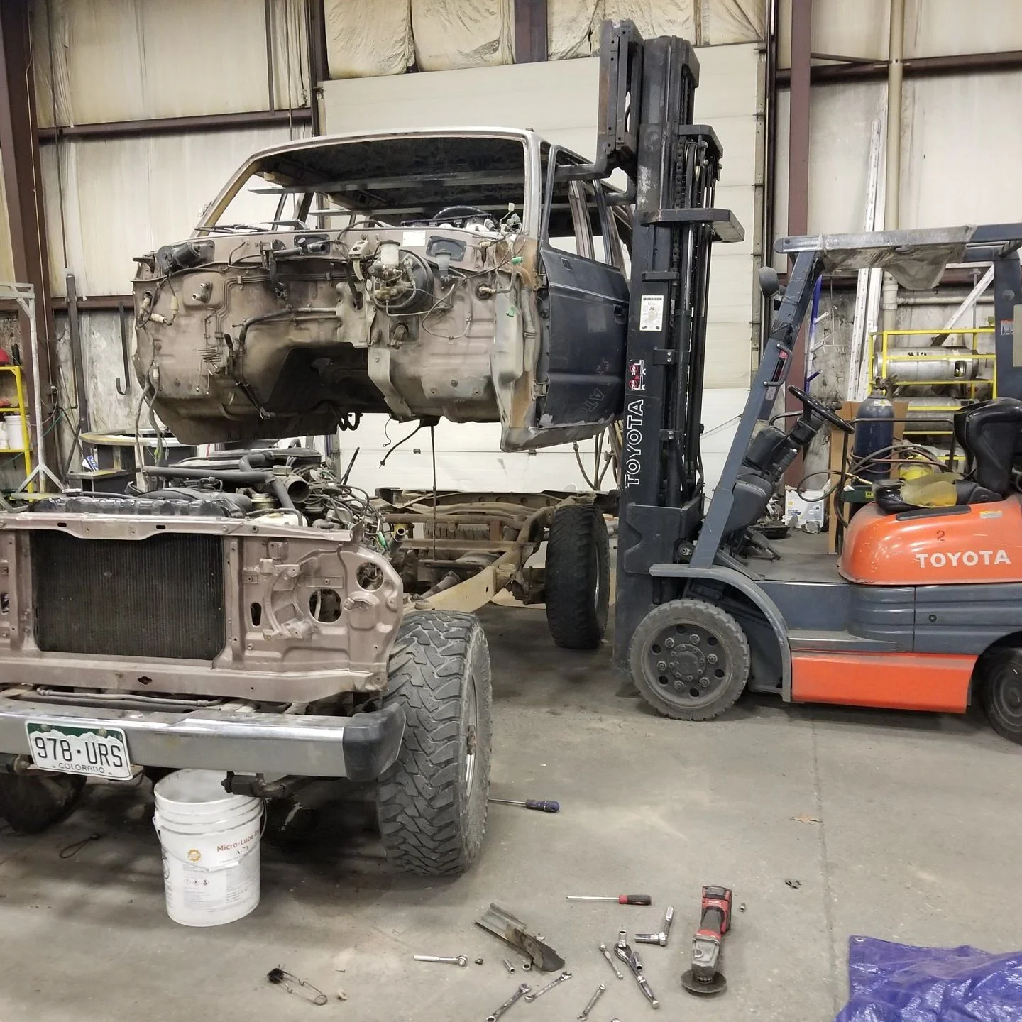

I lifted mine on and off a few times through the door openings. It was stripped right down so really light.
I didn't touch the door frames, they are open just enough to put blocks in the roof at the door jamb
Thanks @dogfishlake ! My cruiser is also pretty much stripped down to nothing, so I should be able to copy your lift.

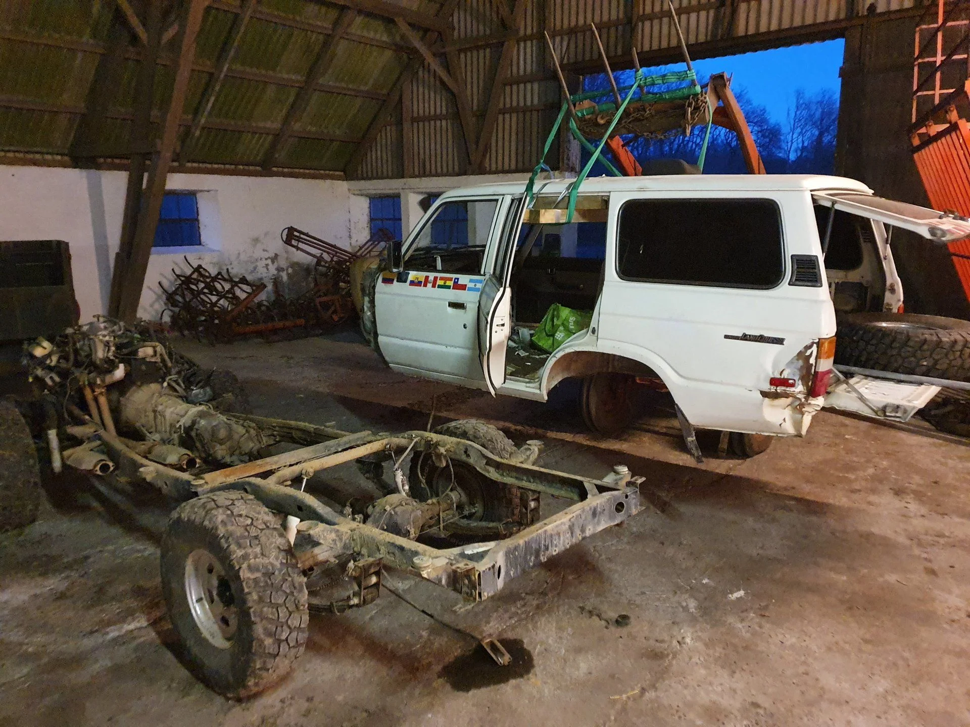

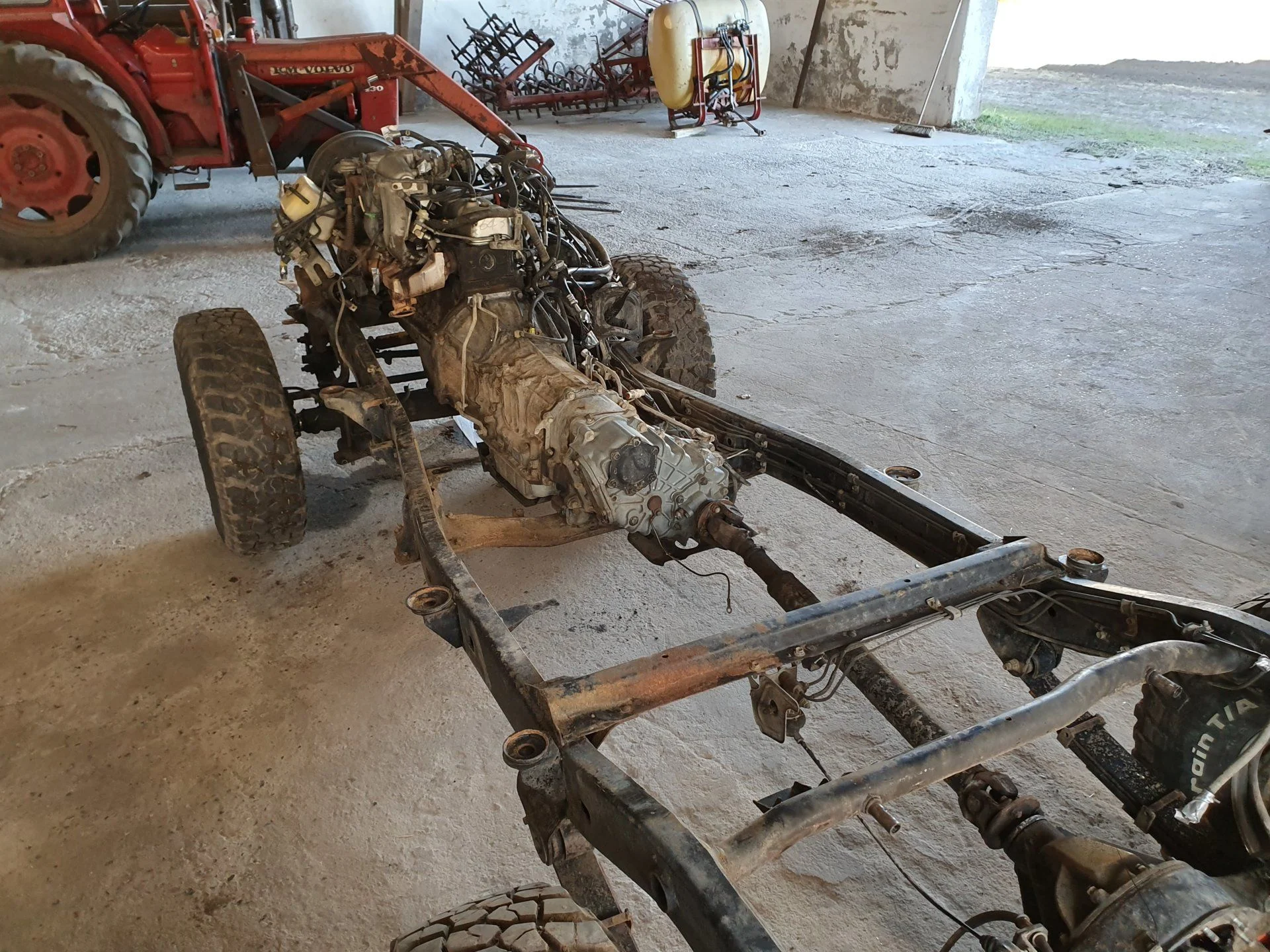

@dogfishlake as promised here's the body lifted off the frame. It was a bit difficult as the tractor couldn't lift very high. But with a little bit of jiggling, it was a great success. As you can see on the second picture I had to balance the body with a spare wheel in order to keep it horisontal. Worked like a charm. Poor old tractor was working hard for the job.
Next move will be to get the frame outside and clean it as it's never been cleaned before. I'm not going to do very much about the body for a while now. My focus will be on the frame. I need to:
- Have more light installed in the barn (on it's way my old man promised).
- Clean the frame
- Galvanize and paint the frame (if it makes sense; I'll know that as soon as it's clean)
- Buy the differential lockers that I've found in Denmark (ARB air controlled) and install them if possible on my axles. From what I know my front axle is a full float and my rear is a semi float. I need to make certain of this, and then I can buy the lockers. If it's not possible I need to find full floating axles.
- I am considering new shocks and springs with the same 2 inch lift that the old ones had. What else should I look into now that I'm down there? However this can be done while the body is on.
- I need to install new transfercase mounts and engine mounts. I want to do this while the body's off.
List to be continued. I'd appreciate input.

Looks like a great success! Nice work. I think your idea of galvanizing the frame is a good one, as long as you are prepared to strip all the accessories off, which it seems like you are. It appears you have semi float rear axles which are fine and you should be able to source an arb locker for it. If you want to go with a full float rear then you will need an axle out of and HJ-61 most likely. I know there are some threads on the different axle widths on different cruiser models. I will see if I can find it and report back, or others with more knowledge than me (not hard to find lol) can chime in.
While the body is off you really only have to make sure the frame is the way you want it, and the bottom of the truck is the way you want it. Everything else can be worked on later to spread out the restoration cost. It gets your truck back on the road quicker too. I suppose it would be nice to freshen the brake lines and fuel lines, since it is so easy now, and maybe clean the transmission/transfer case really well now.

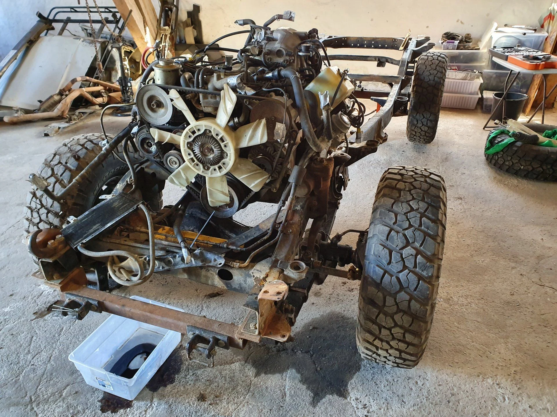

Body's lifted off, and frame and engine is washed down. For now only with a high pressure washer and spray can engine cleaner. It didn't do as much as I hoped. The old grease wouldn't come off.
Any advice on how to get that stuff off? (Rather than scraping)
Next move is to start dismounting everything that is still on. Engine, transmission, transfer case, brake lines, steering and so on. I want the frame sandblasted and painted. So everything needs off.
It does start to look fine though after the thorough wash.

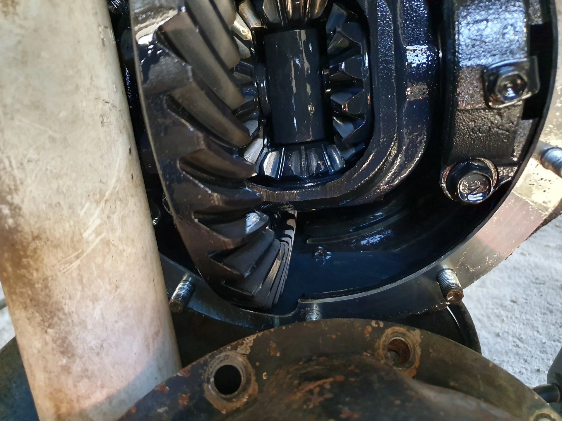

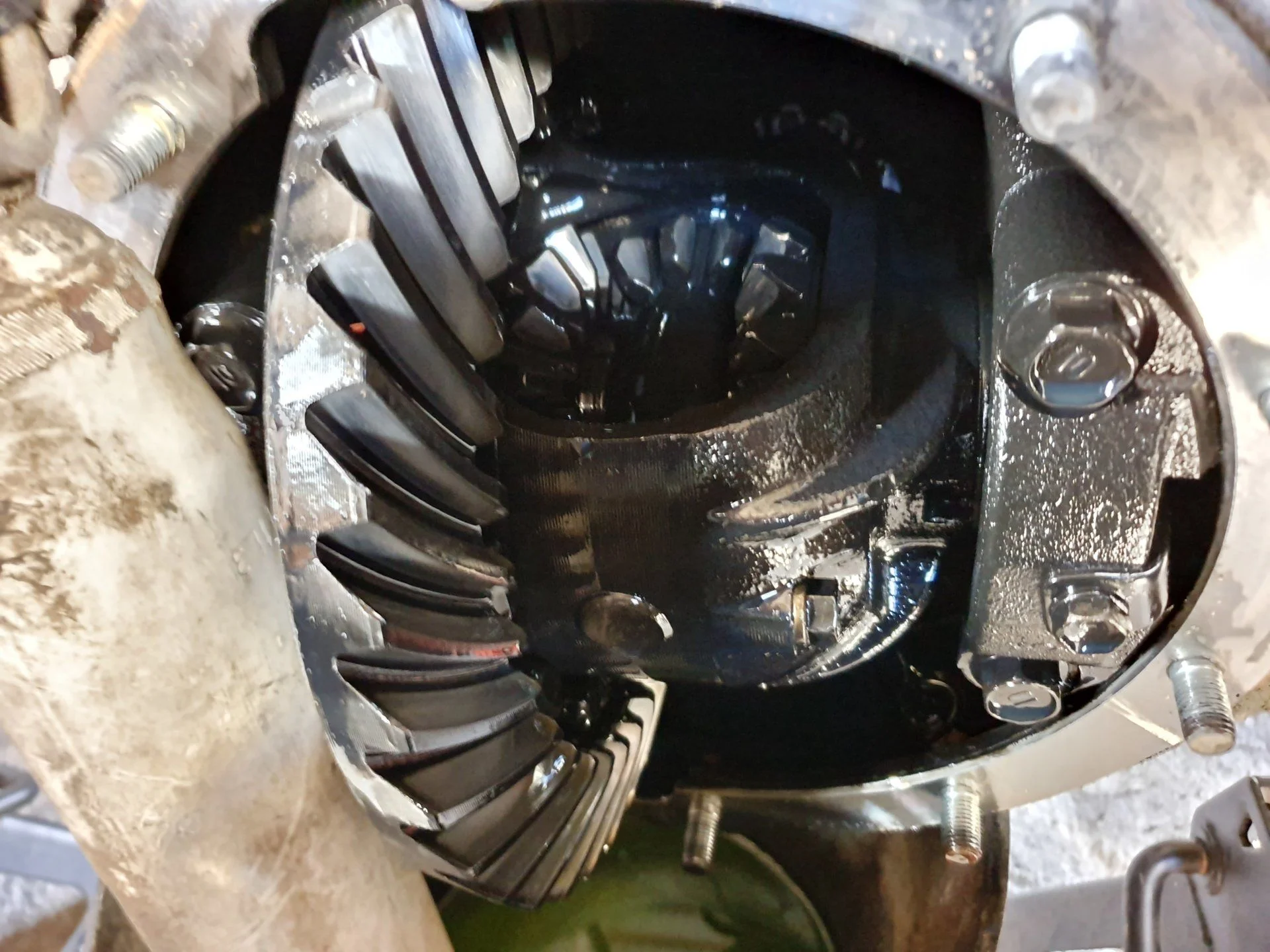

I also took the cover of the rear differential. Everything looks fine in there. I counted the teeth to make sure I wouldn't get problems with gearing when installing the ARB air lockers.
The shock is there to empty itself into the same bucket as the diff.
