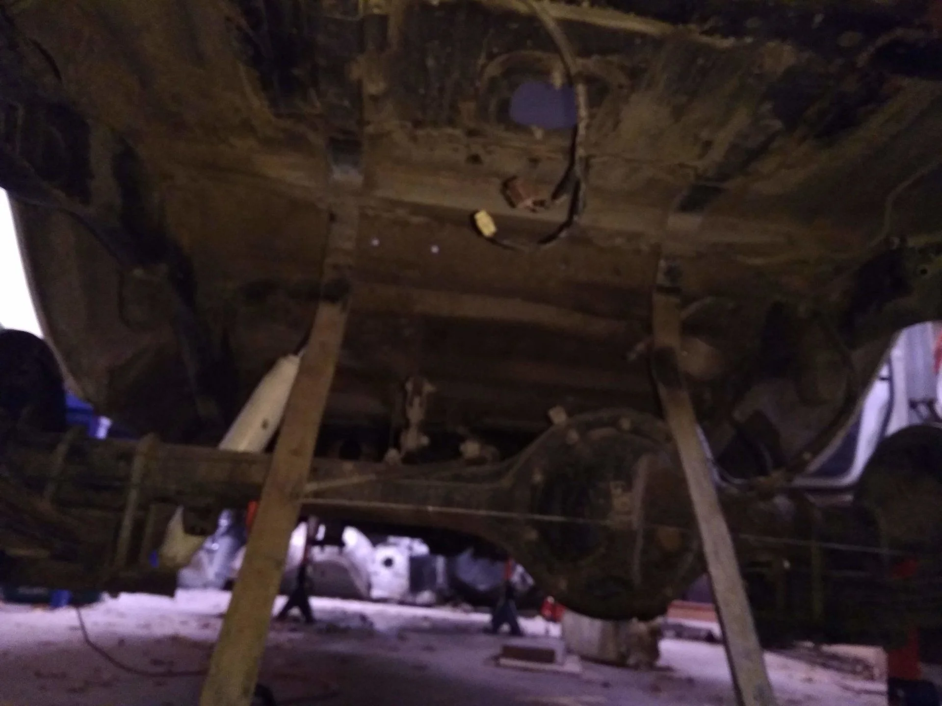

I got the body off of my 60, it was pretty easy. I did not have to remove the gas tank, or even the spare tire beforehand. Also, I did mine with a fork lift and used the side-shift to move the body back a little as I lifted it and that saved me from taking the shifters out. I think the whole effort took me around 6 hours to get the fenders off, and the body unhooked and off. I did take my whole interior out prior to all of this which was around 6-8 hours. Worth it I think. I will tell you if that is a true statement when it is back together!
Ill put up a couple of pictures.

@dogfishlake wow that's a pretty decent job there. I haven't gotten the frame off yet, but I am getting pretty close to do the lift. I might get in some hours tomorrow.

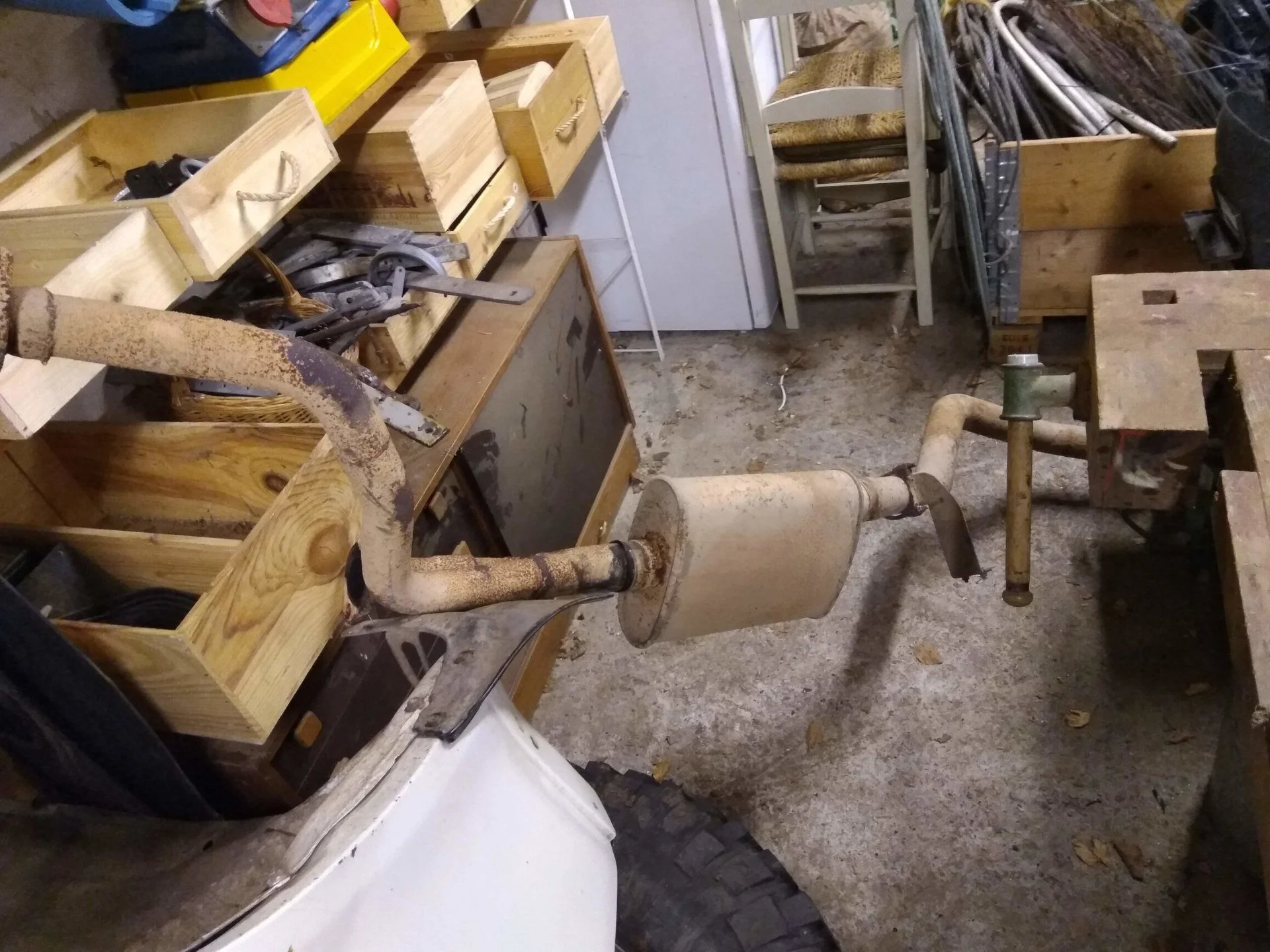

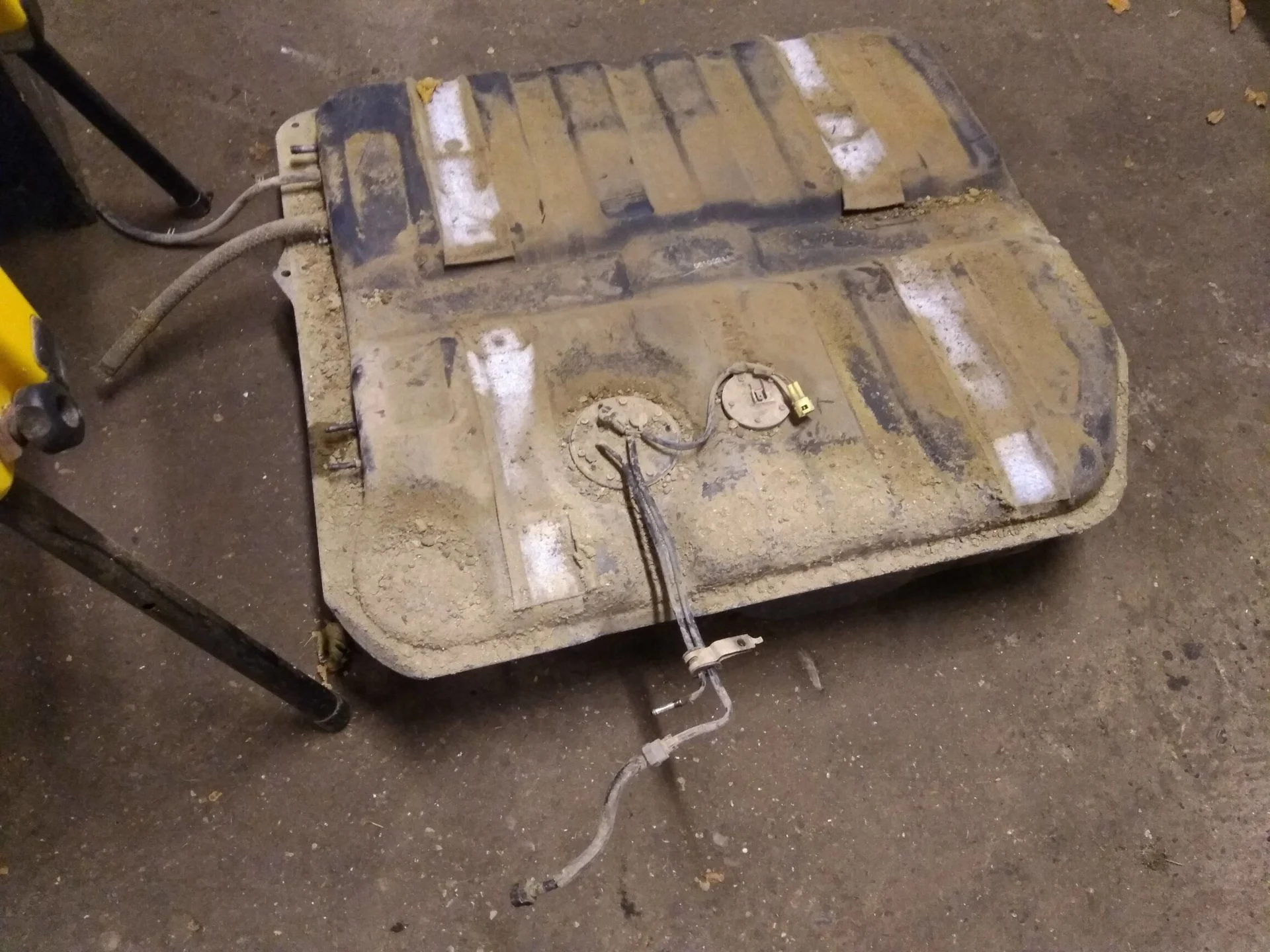

I took the tank off because I wasn't sure... In order to remove the tank I had to remove the exhaust pipe too. I thought that I only had 20 litres in the tank. When the first bucket on the floor was full, and the flow wasn't slowing down, I quickly realised that there was more than 20 in there. More like 40. Anyhow I threw a new bucket under there and one more, and that saved the night. I had to burn it all because the buckets I used were so dirty that I'd never pour it back on after an overhaul.

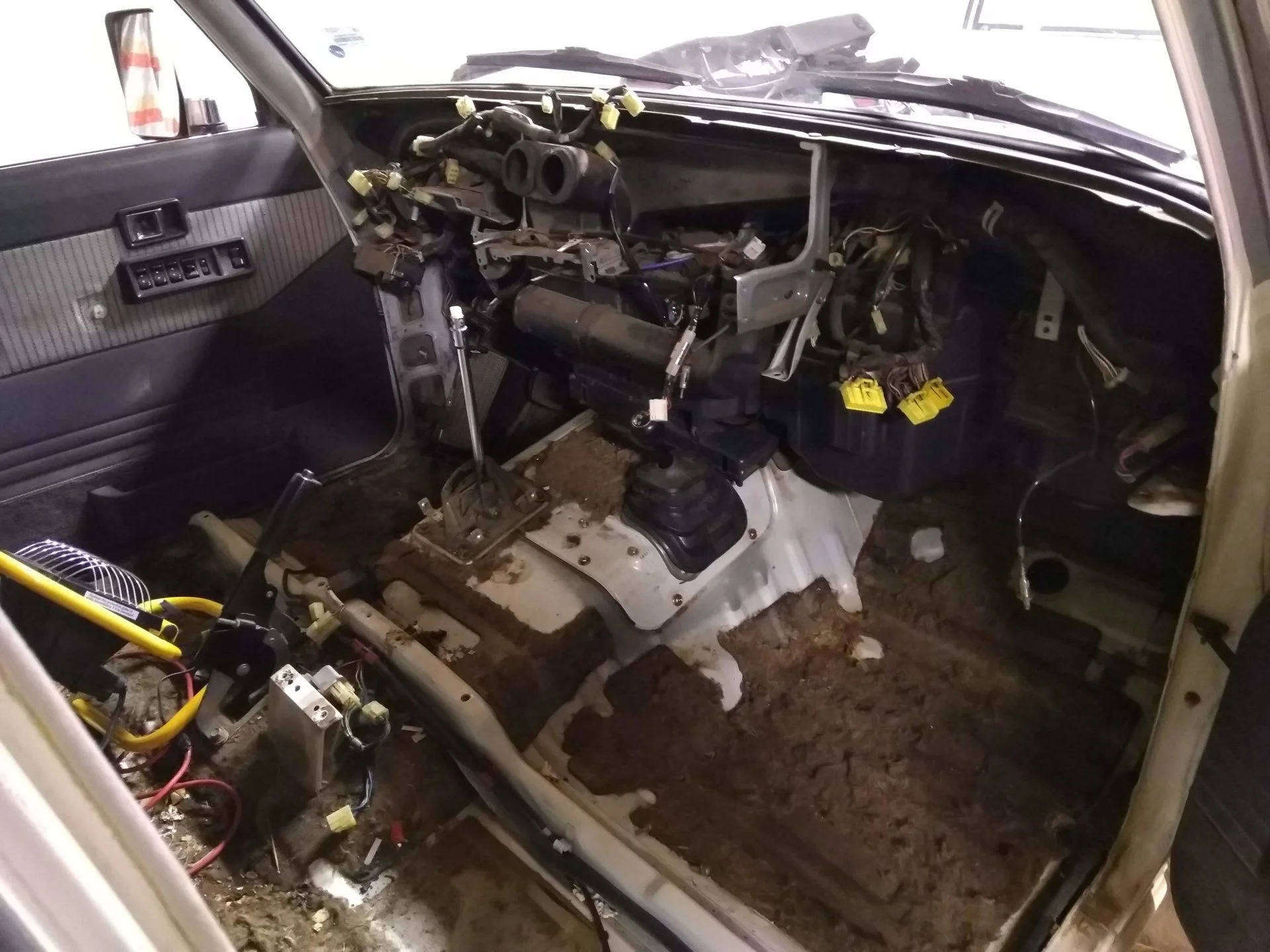

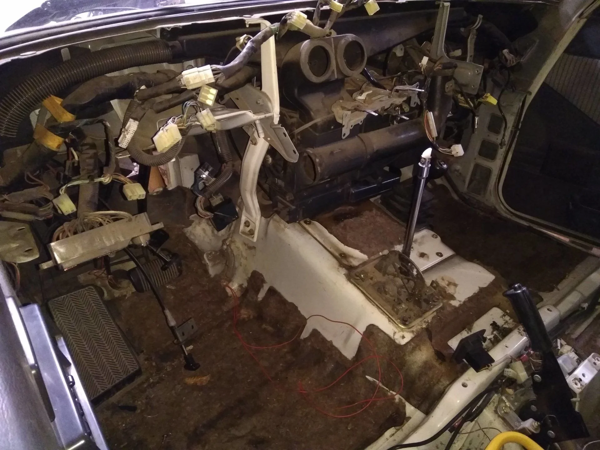

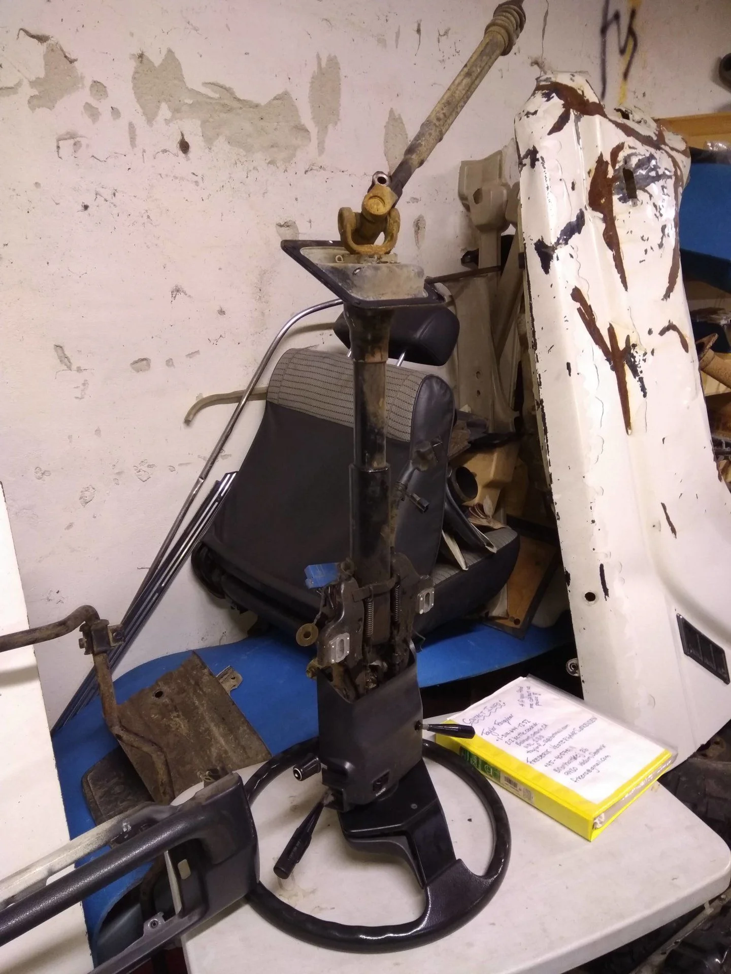

My mate got the dash panel off the stearing column and the speeder cables without breaking anything (yay), and a lot of other good stuff in the front. I think I'm down to getting off all the tricky parts now.
Nice and dirty... This will be easy to put this together again (said no one ever that night)
The steering column, and what's that yellow binder on the table??

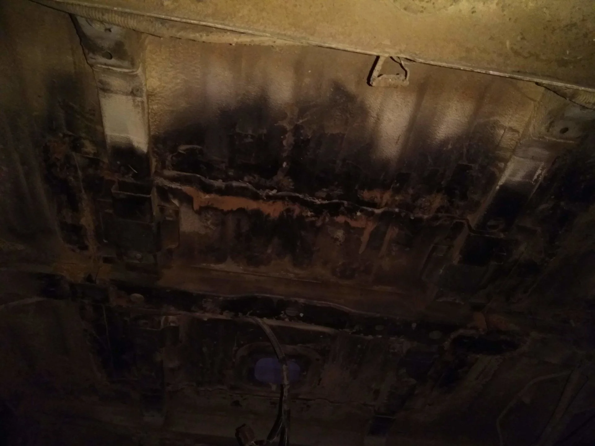

This is the other half of dirt on top of the tank. The half that I didn't get into my eyes. Maybe glasses would be a good idea next time.

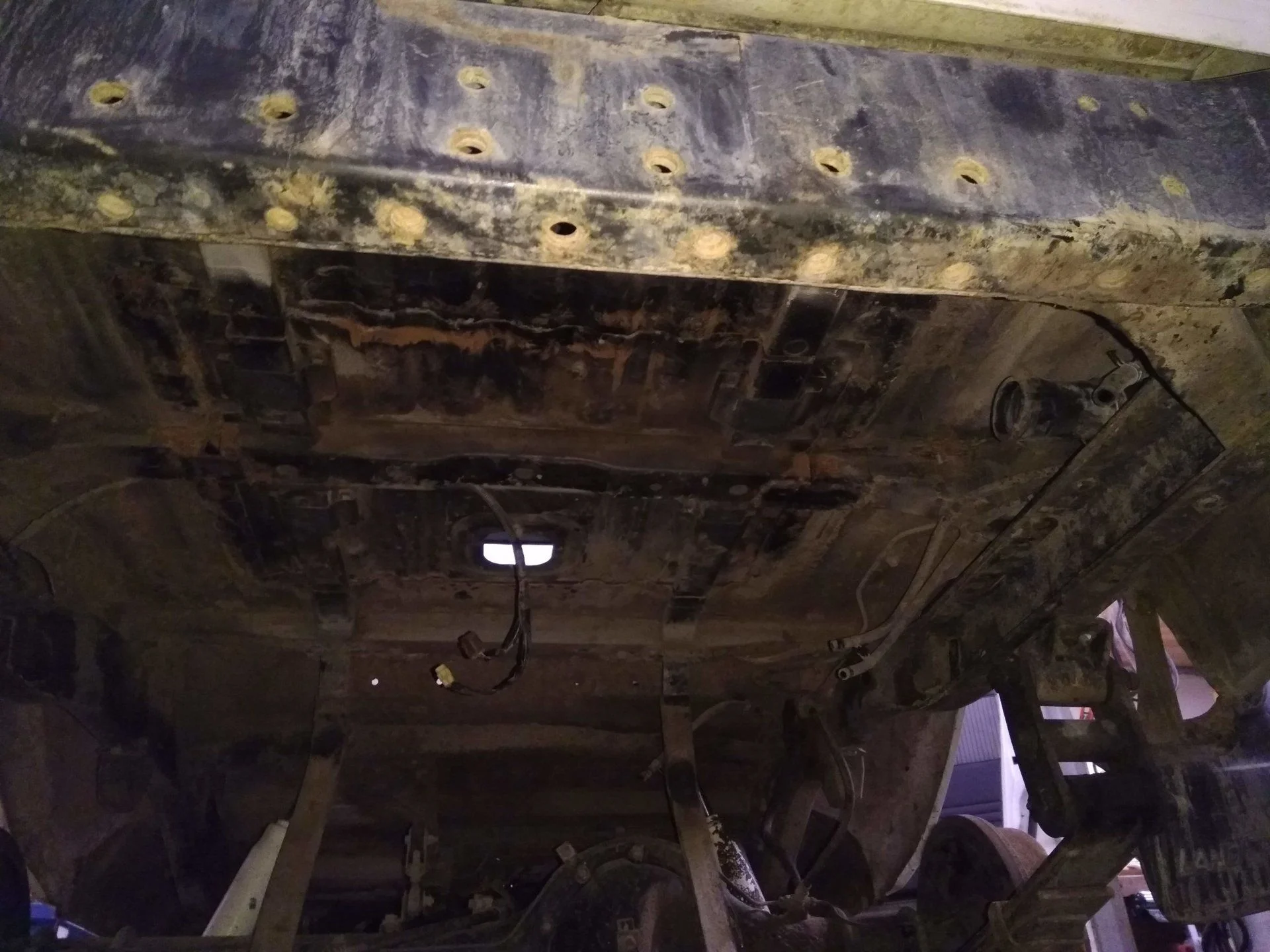

And some more pictures...
Decently good looking under there. Haven't found any rust yet!

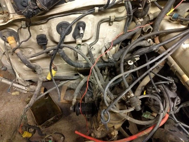

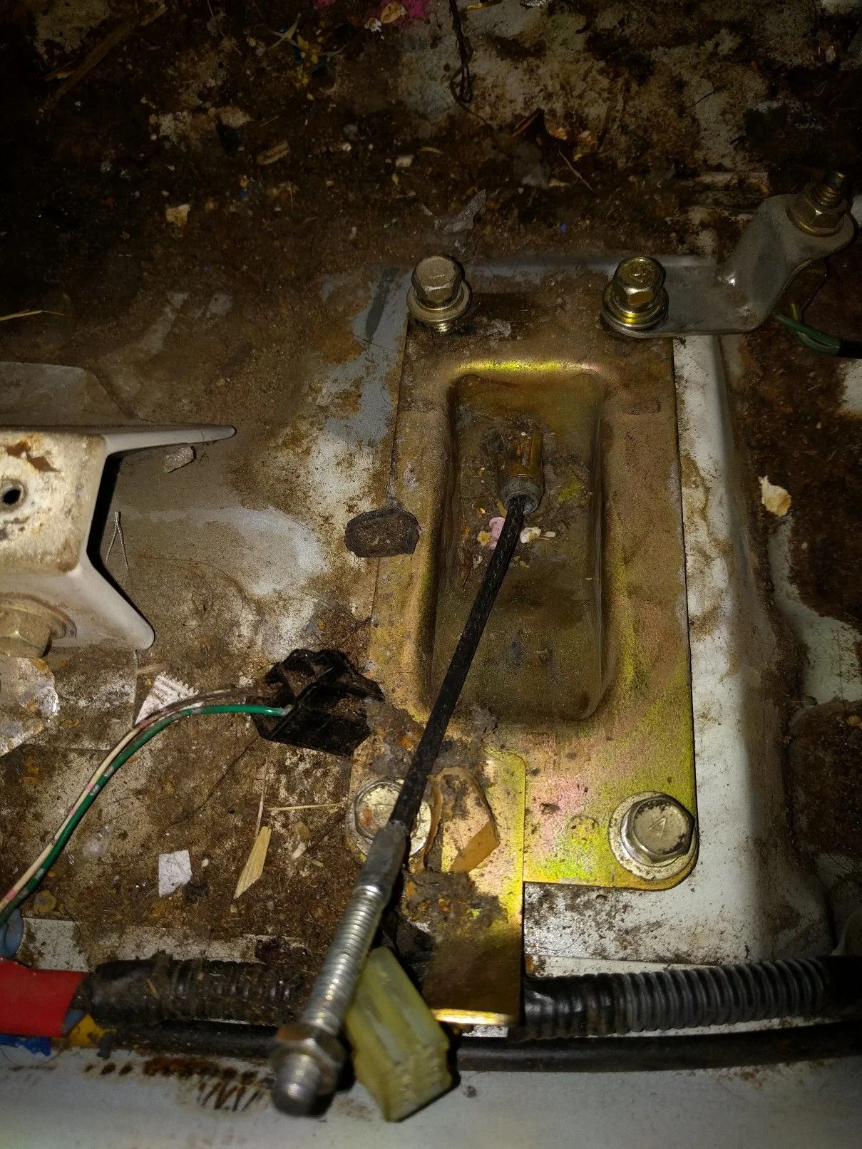

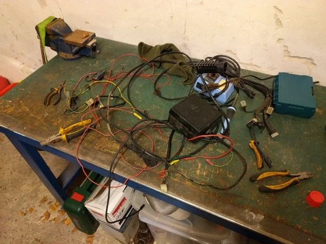

Anyway got to work on the Sandwich too. I'm prepping it for the body liftoff. Man there's a lot of cables I had to take apart. When I put it back together I'd like to put in a brand new wire harness. I haven't found any complete sets yet, so if anyone has a recommendation I'm happy to see it!
I can't decide whether to take off the handbrake cable at the handbrake-handle, or at the wheels. There's a pretty big bushing with "hooks" on, that I need to squeeze to get it out at the handle, that's why I'm considering the other way. Haven't looked too much at it yet. Maybe I can just pull it backwards out.
I haven't been under the car today, so I'm still lacking all cables and whatso between transmission, transfercase and the body. Maybe I'll have some time to look into that tomorrow.

And some pictures from today's work. I know it's moving slow, but at least it's moving! The last picture is from the auto-phone that was installed under the seat. It's not going back in however cool that would be. That stuff caused quite a birds nest under there.

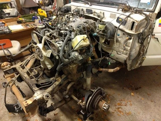

Alright, time for a tiny update on the project. It's moving slowly along...
The Sandwich is ready for a frame liftoff. So-so. I had to move it this weekend with all the parts (!), in order to have more room (and in order for my dad to have his barn back). So I installed the wheels, the steering wheel, the hand brake, and towed with an ATV just around a mile. It was good fun to look over my shoulder and see the taken apart Sandwich cruising with my brother in law behind the steering wheel.

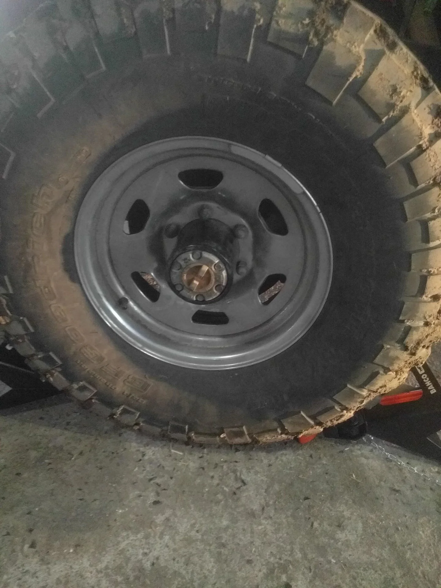

And the experts might come along to correct me but I believe that all Land Cruiser solid front axles are full floating by definition. And I also don't believe that you need a full floating rear axle to have an ARB air locker installed. In other words ARB makes a locker for the semi-floating rear axle that was standard in US model 60 series.

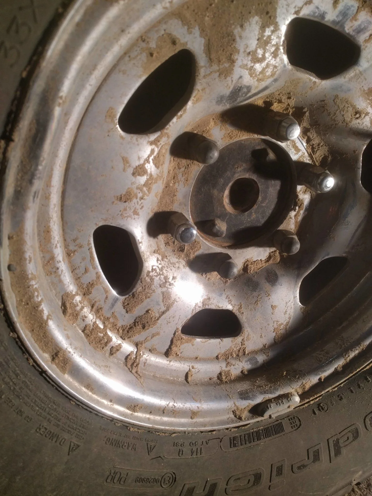

@Prairie Swamp, looking at the hubs of my axles, what type would you say they are?
Those look stock for the US market. In other words the front are full floater and the rear is semi-float. Full float rears will have the hubs sticking through the wheels some.
