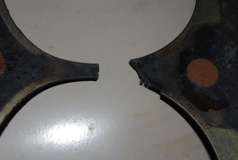

As expected, head gasket was burned through cylinders 1 & 2.
How does that happen?
I'm certainly no expert, but it seems a possibility that either the head surface on the engine block and/or the mating surface on the cylinder head itself was not flat or otherwise did not have a good surface. If there was any sort of gap between the block and the head, other than a flat uniform one to be filled by the gasket, then the gases will want to travel between the cylinders - it's the path of least resistance.
Just a guess, but it seems that maybe the engine builder did not verify mating surfaces before the engine was assembled. I'll be interested to hear more from someone that actually knows what they are talking about.

It could also have been a little ding or fold in the head gasket.

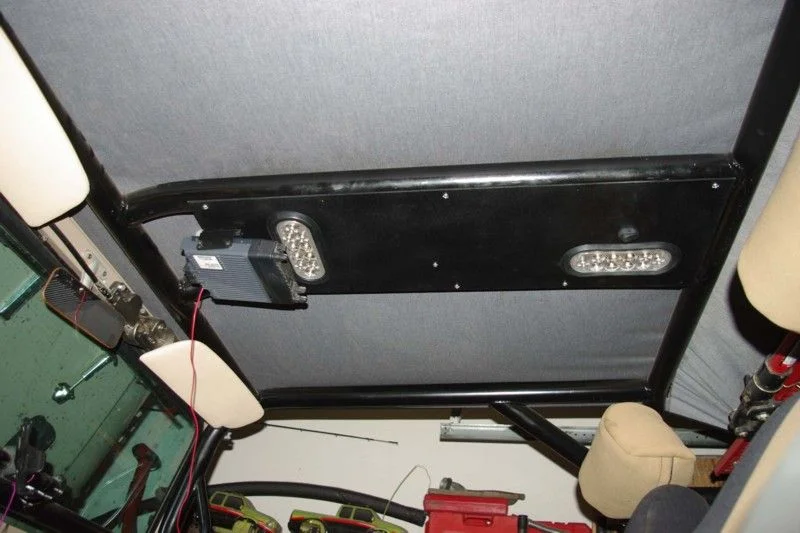

In the down time waiting for the cylinder head to come back I decided to make one significant improvement to Da'40. At night there is no lighting inside, and fumbling for a flashlight was a PITA. So, here is a pic of the semi-final product. Mounting the FT-8800 was a last minute decision and I wish I had planned accordingly and moved the forward light back. What I might do is acquire a third light and mount it next to the forward light, but about 3" back.
The switch is a lighted switch, and I thought it would be nice to have the light come on when the lights are off. Well, that little blue light is very bright, so I'll probably rewire the switch so the switch light goes off with the lights, like it's supposed to be.
Would you say with both of those lights you have enough illumination and does the back one give enough light to the rear?
If you are going to rearrange items so you radio is more tucked up, you may like these ideas.
Very nice Jon!
I thought about using a lighted switch for the overhead lights in the 40. But then I realized that it would be incredibly obvious if the lights were on when I looked up there anyway, and just went with plan old switches for simplicity.

Actually, I didn't want a lit switch. This was the only switch I saw I liked when I went to the parts store. I had the same thought as you about the switch light being on at the same time as the dome lights. That's why I reversed it.
