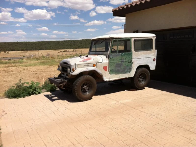

This thing has been sitting for several years since I bought it. Maybe a thread will help with progress.
What is the month/year of that? Those turn signals look like pre '69.
Oct 68.

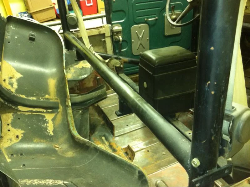

Any idea what this crossmember was used for on this custom cage I picked up from FJguy last year?
actually I learned what it is in the BHCC last week. on a good cage, you need some cross pieces to stabilize the cage side to side. a dash cross member and one behind the front seats, like that one, is what that's for. I am now putting one in like that for mine.

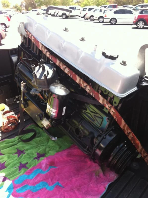

Look what I picked up during my lunch break.
oooooooh, aaaaaaaah. What did you do to the engine? Don't forget the block-off plate where a mechanical fuel pump would be.
Todd did the folowing:
-standard rebuild e.i. machine work + new bearings, pistons, rings, timing gear, gaskets...
-milled .030" off the head
-installed M-a-F mild cam, with stiffer valve springs
-painted pretty black and silver
at home I plan to:
-port match the head with intake and polish
-after market ECU, Megas Squirt
-eliminate vane MAF and replace with MAP sensor
-use electric radiator fan
-add knock sensor
-add rear tank with fuel return loop, electronic pump in loop

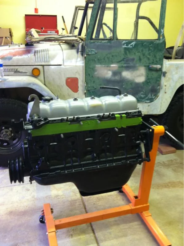

Is this a 2FE in the making? Looks like a good project. I like the nickname.
The 3FE is home
Its so pretty. I think it needs to replace Dan's diesel!
He can have that. 31MPG. I'm happy with that. ;)
Looks gorgeous! Why electric fan? There are plusses and minuses, but I'm just curious as to why you're going that route...
