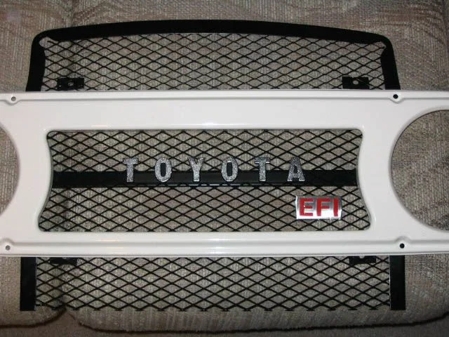

More play today. Taking a clue from our BJ friends I put an EFI badge on da'40's grill. The badge is from the top of the intake on the 3FE engine. It's mounted to a piece of 1/8" steel with two holes drilled in it. The holes have #10 flat head machine screws, counter sunk, welded, and ground flush.
Very cool! As soon as people see that badge, they'll be asking you to pop the hood so they can see what's underneath.
