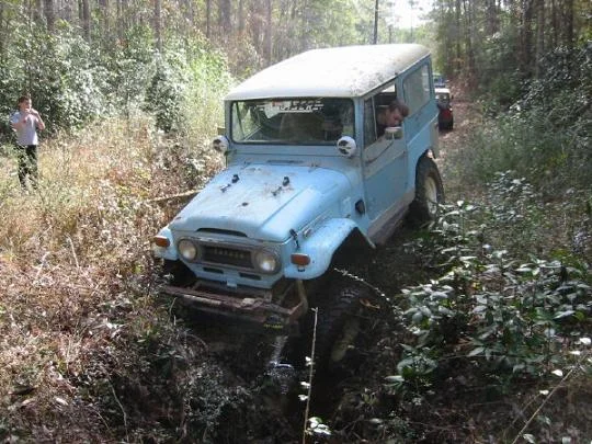

My old all pics with SOA one with 31's and two with 35's. Yeah it's huge when you get done. Wish i had the pics of the drive way before and after. HUGE :eek: :eek:
That's my bud in the first shot ;) He owns heep wagons :princess: :rolleyes: But havn't seen him for 2 years and he's in Iraq right now :rolleyes: .
nice pics hawk, you get stuck in that ditch? i know i should be taking pics, if not to post but to remember how things go back together, haha. i get my housing back today i think, wheres kurt? im going to post some poser pics when im finished,

Heck no... I crawled right out of that shiite, with a strap and a bronco pulling just a little. ;)
